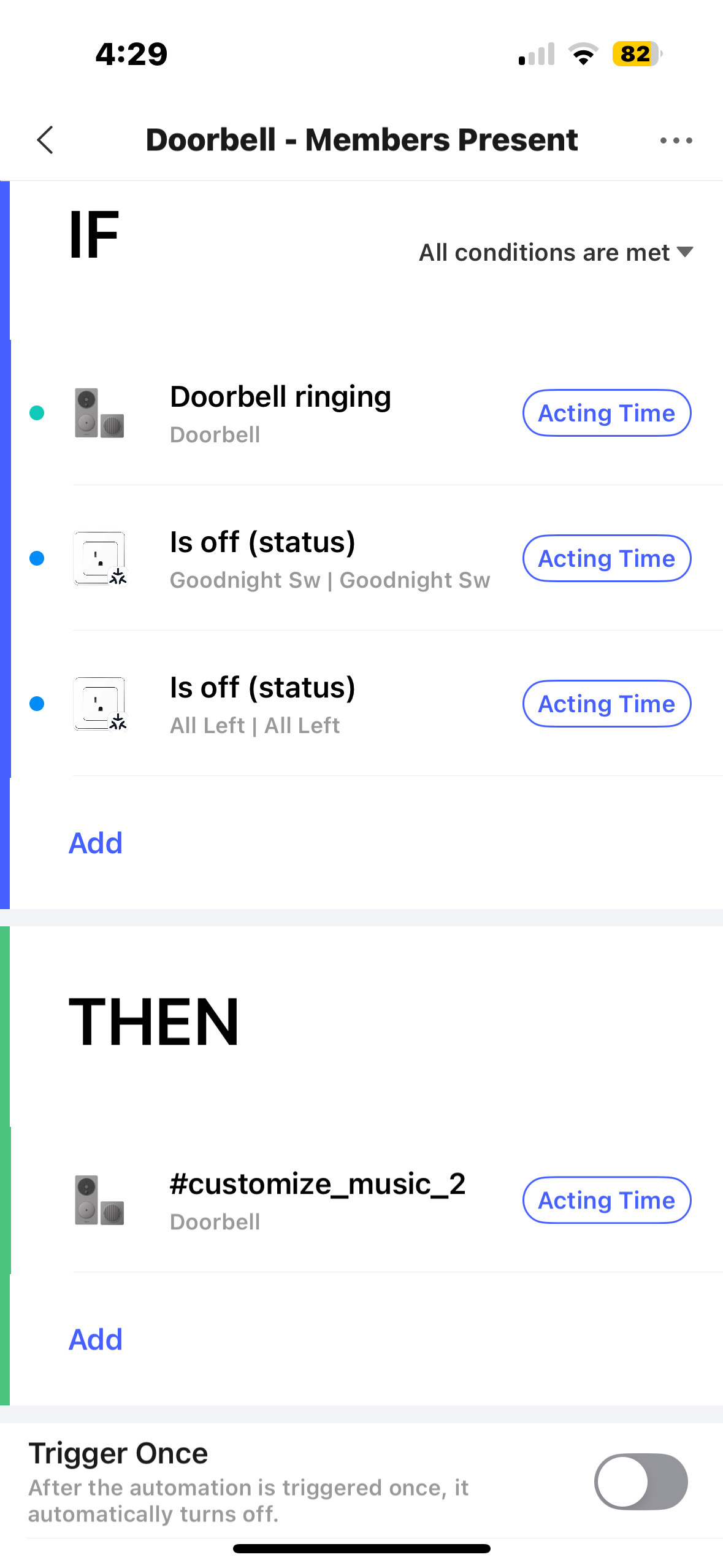

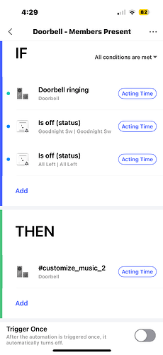

You just need to add an automation so that when the button is pressed it plays a sound of your choice on the doorbell speaker.
I have recorded my own message to play outside.
Just ignore the 2 status devices as they are just part of my personal automation
THANK YOU LOSTBOYRADIO! This has been driving me mad as guests have no feedback when the doorbell is pressed which means they press it again… and again… and again. Your Automation has just made this disappear! Kudos my friend!

This has been one of my biggest frustrations with the G4 as well. Visitors keep pressing multiple times because there’s no feedback outside. I agree with others here — the hardware already has a speaker, so it really seems like a firmware update could allow a simple chime or tone when the button is pressed.
Big thanks to @lostboyradio for sharing the automation workaround — I just tried it, and it makes a huge difference! Still, it would be great if Aqara could add this as a built-in option so we don’t have to rely on custom setups.
