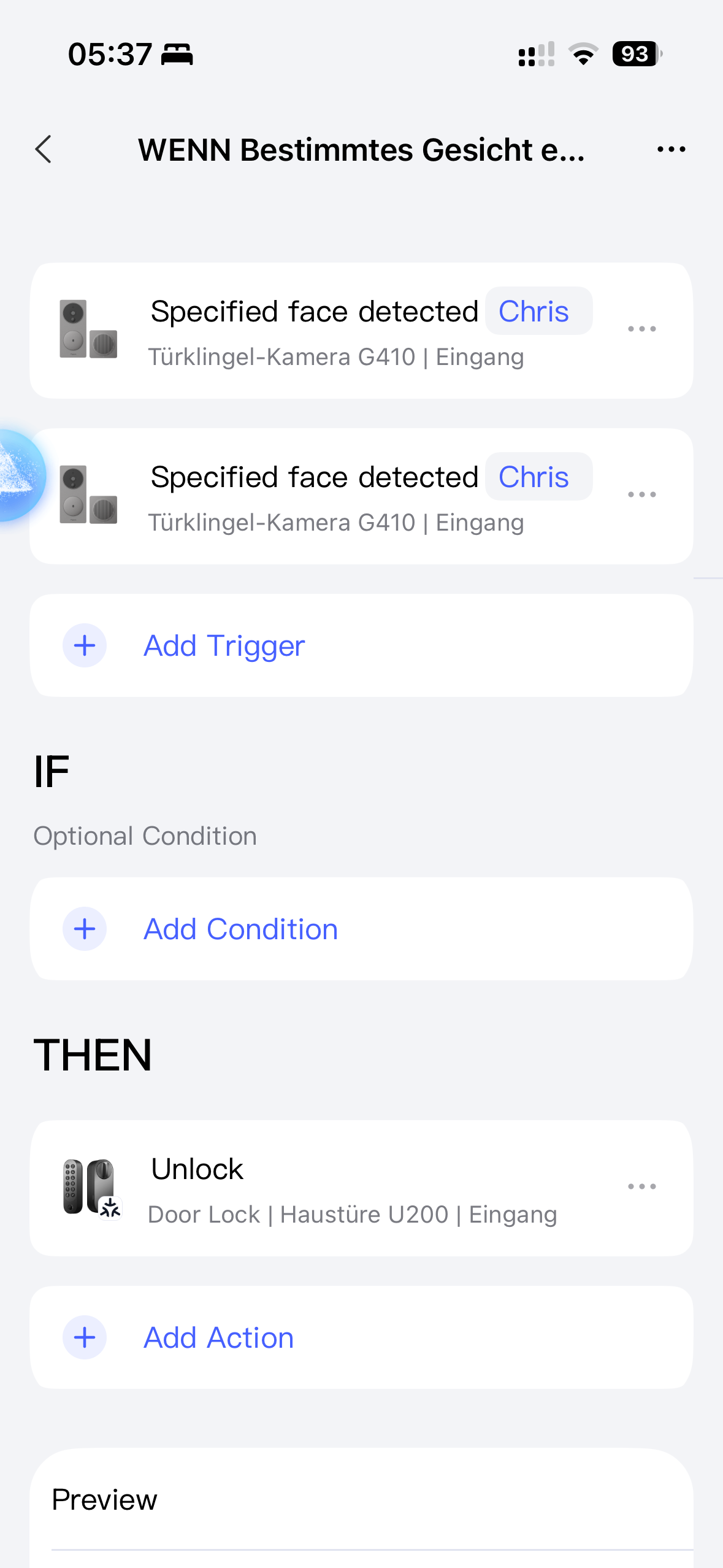

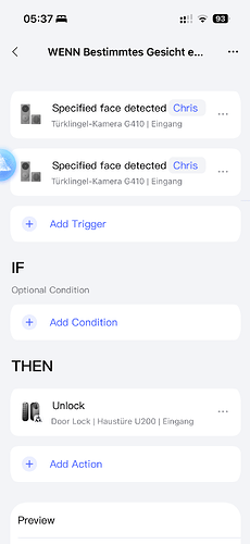

Hello, I have a working door opening based on photos (facial recognition) from a G5 camera and a U200 lock. I made an automation for this, it’s very convenient, especially when my hands are busy (the camera is looking into the yard), showed my face and the door opened.

Theoretically you are right, but practically I researched and tried to change my photo to fool G5. Nothing worked, I even printed the photo that I gave G5, it didn’t work either. When I appear in the camera so that it can track and open the lock, I have to smile and shake my head (somewhere around this photo was given) then the lock opens.
