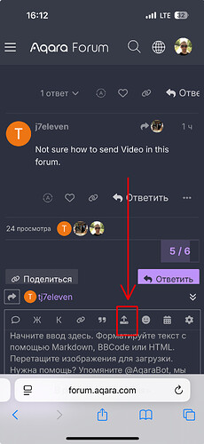

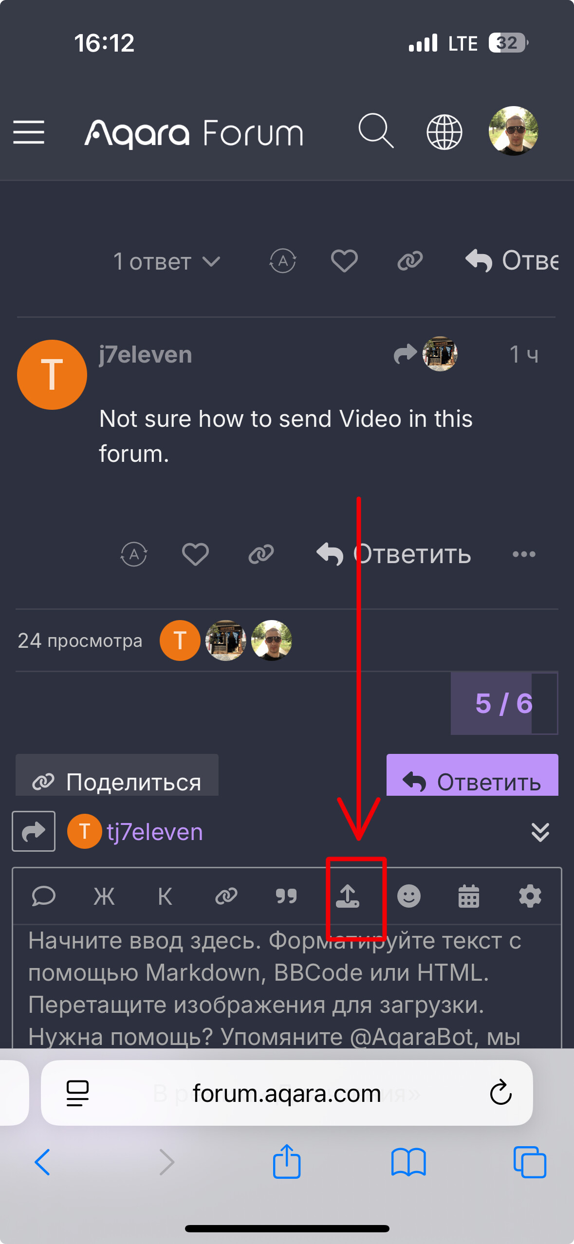

Please send a short video,so I can check what is the issue here
Not sure how to send Video in this forum.
Tried, didnt work. I’m really disappointed. The app does not scan any of the barcodes. It asks for pins. I dont have any. I connect configure any of the products with wifi. I tried the home wifi at 5 and 2.5. Tried my cell hotspot. Tried my wifes phone. Tried my sons hotspot. Only Bluetooth. When i try to upload photos or video it does nothing except remove my keyboard. I usually dont have this much trouble with technology. Uhgg
