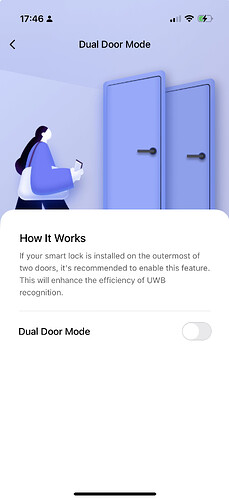

Can someone explain what exactly happens when this options is activated? Will it increase UWB sensitivity? If that’s the case I’m interested in using it to improve my single door experience which has been a hit and miss

This is for situations where you have a door in front of another. For example a storm door is in front of your main door. Since I believe this increases the distance from where it can detect your phone it may help you.

We’ve also realized that the description of this feature isn’t very intuitive, so thanks for pointing it out.
This feature is only intended for setups with double doors where the U400 is installed on the outer door. In these cases, the indoor door can reflect the indoor antenna signal, which may prevent the lock from unlocking when the user is outside. When this option is enabled, we actively filter indoor signals to improve the stability of UWB unlocking.
If you have double doors but the lock is installed on the inner door, or if you only have a single door, you can safely ignore this setting.
