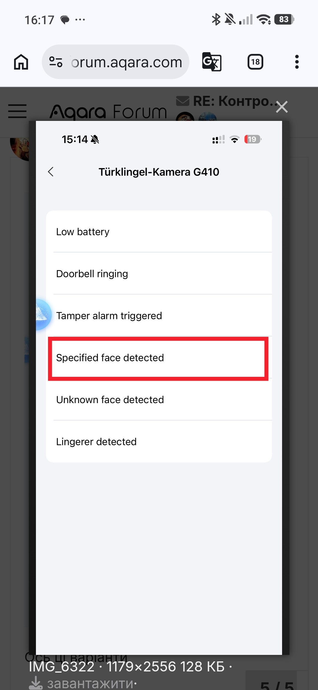

Hello. You can use the “Face Detection” function in automation
WHEN
  • “face detected”
    IF
  • relay T2 is on
    THEN
  • turn off relay T2.
    I also recommend connecting relay T2 in pulse mode.
    EXPLANATION, the relay turns off for 30 seconds after the OFF command and turns on itself after 30 seconds. This mode will provide a constantly closed mode of the gate lock.
    For more detailed help, describe the lock used in your door.
    Thanks @DEChrisE, for the screenshot of the G410 automation functions, I do not have this type of bell.
