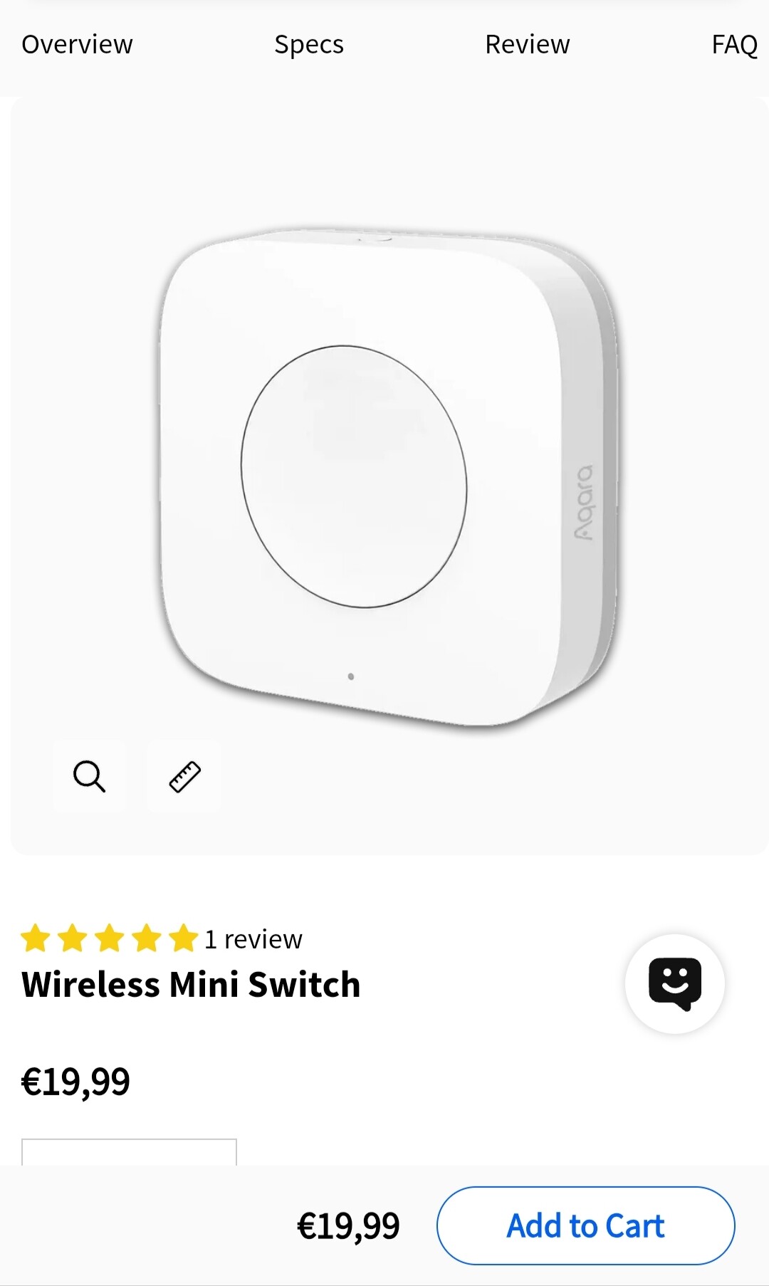

Yes, unfortunately the T2 relay does not work at 24 volts on the relay control contacts (com, S1, S2). I recommend a simpler option, take the Aqara wireless button. Make an automation for starting the call.
