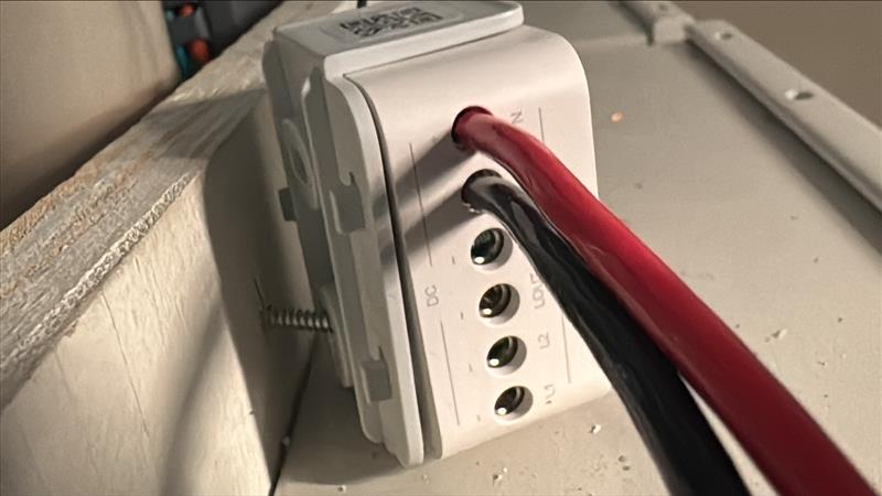

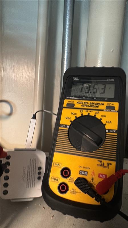

Hey everybody. I am just trying to get the T2 up and connected to my M3 hub. I do not seem to be having success getting it to power on. I have power to the unit that I verified, but when I hold down the button I don’t see a blue light light up and the hub fails to see it available. Am I doing something wrong? Is it wired wrong for power? Do I have a defective unit? Any ideas?
Hello, relay T2 only starts from 24 volts🙁
OH! Well that will be the reason! Looks like I’ll be making an AC cord for this then. Thanks!
