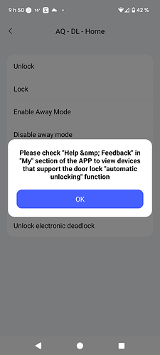

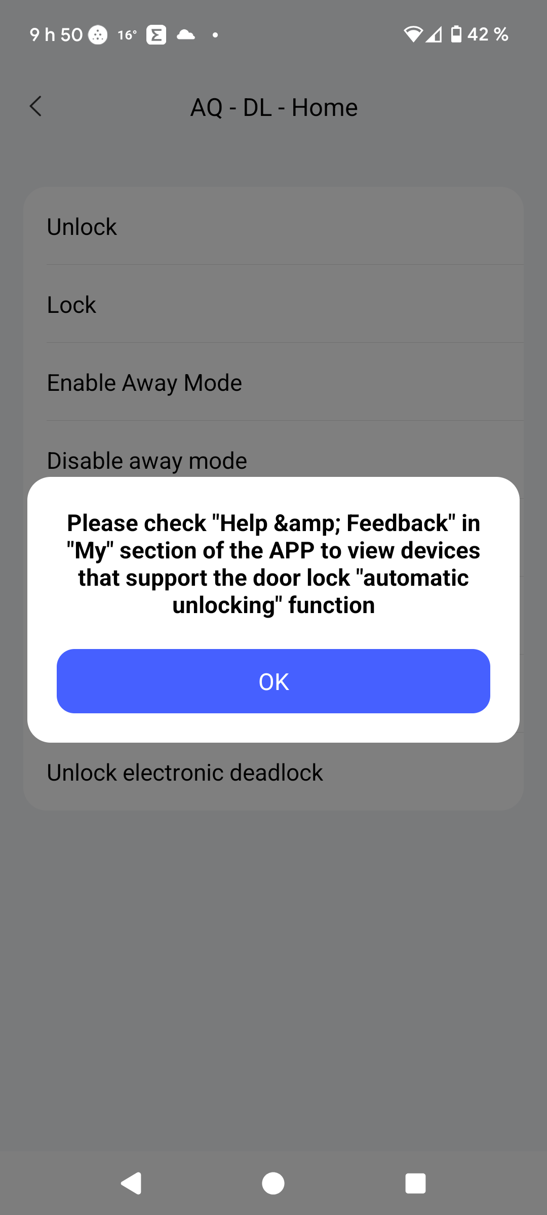

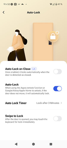

When I try to create an automation to unlock my Aqara U100 door lock, I get the following error message:
Please check “Help & Feedback” in the “My” section of the app to view devices that support the door lock “automatic unlocking” function.
Because of this, the automation cannot be created. This issue only happens with the U100 because my other Aqara locks work fine with “Unlock via Automations.”
Is this a bug, or is the U100 not supported yet for automation unlock?

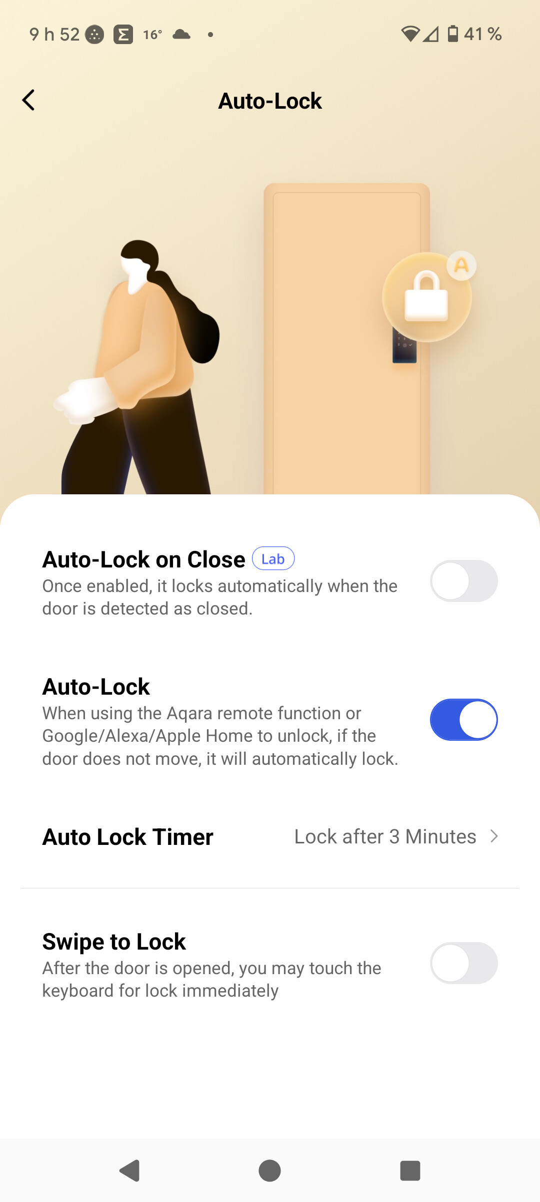

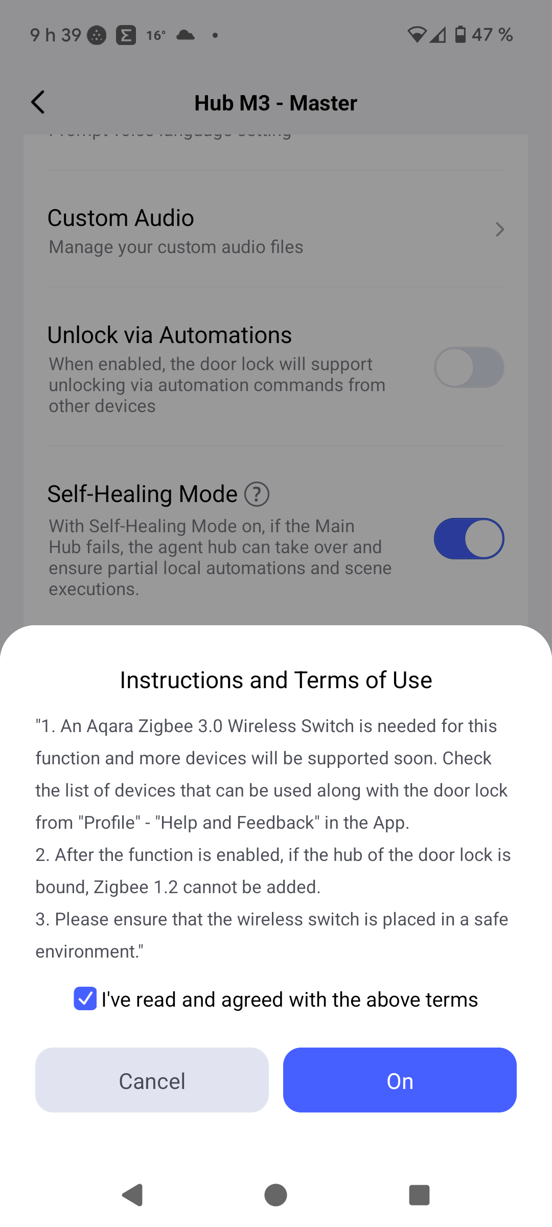

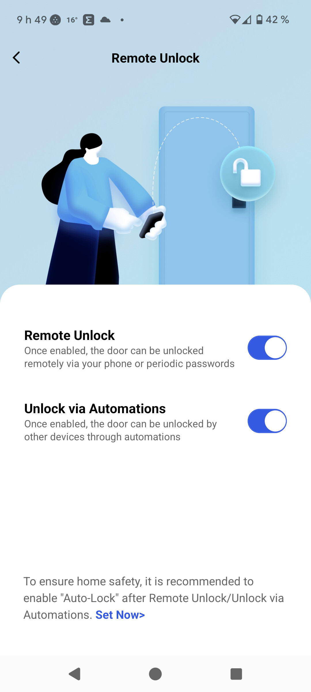

All these options are already enabled as you can see in the screenshots from my previous message. I would also like to point out that it works with the other models, but both of my U100 devices show the same error messages.

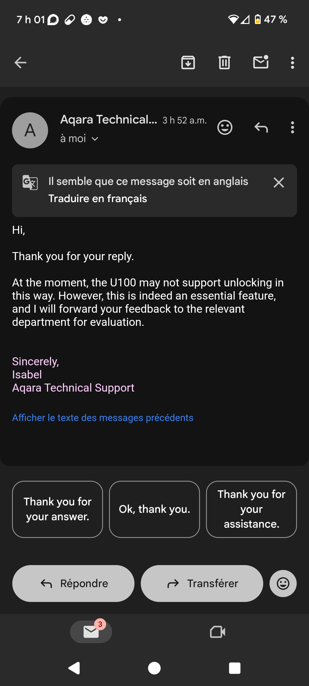

Thanks I already try this. There is the answer from Aqara:
This is great, what kind of automation should there be, what device do you want to open the U100 with?
When a fire alarm trigger for more than 5 mins, I want to unlock all doors of the house.
More and more Aqara Zigbee devices will support to unlock the door lock soon
