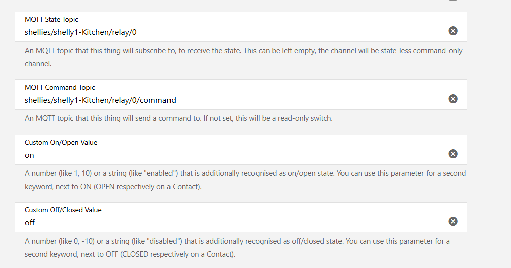

You don’t need to use a MAP. For instance, Shelly devices want lower cae

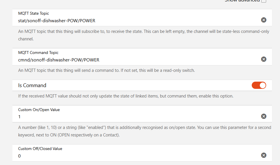

and Tasmotas like 0 and 1
