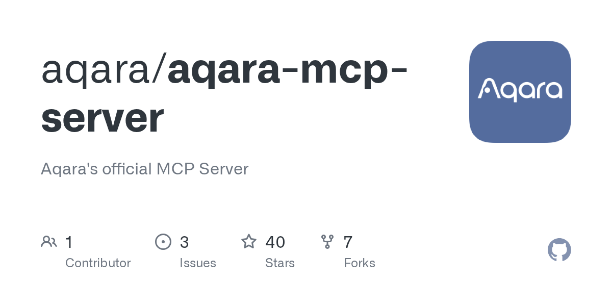

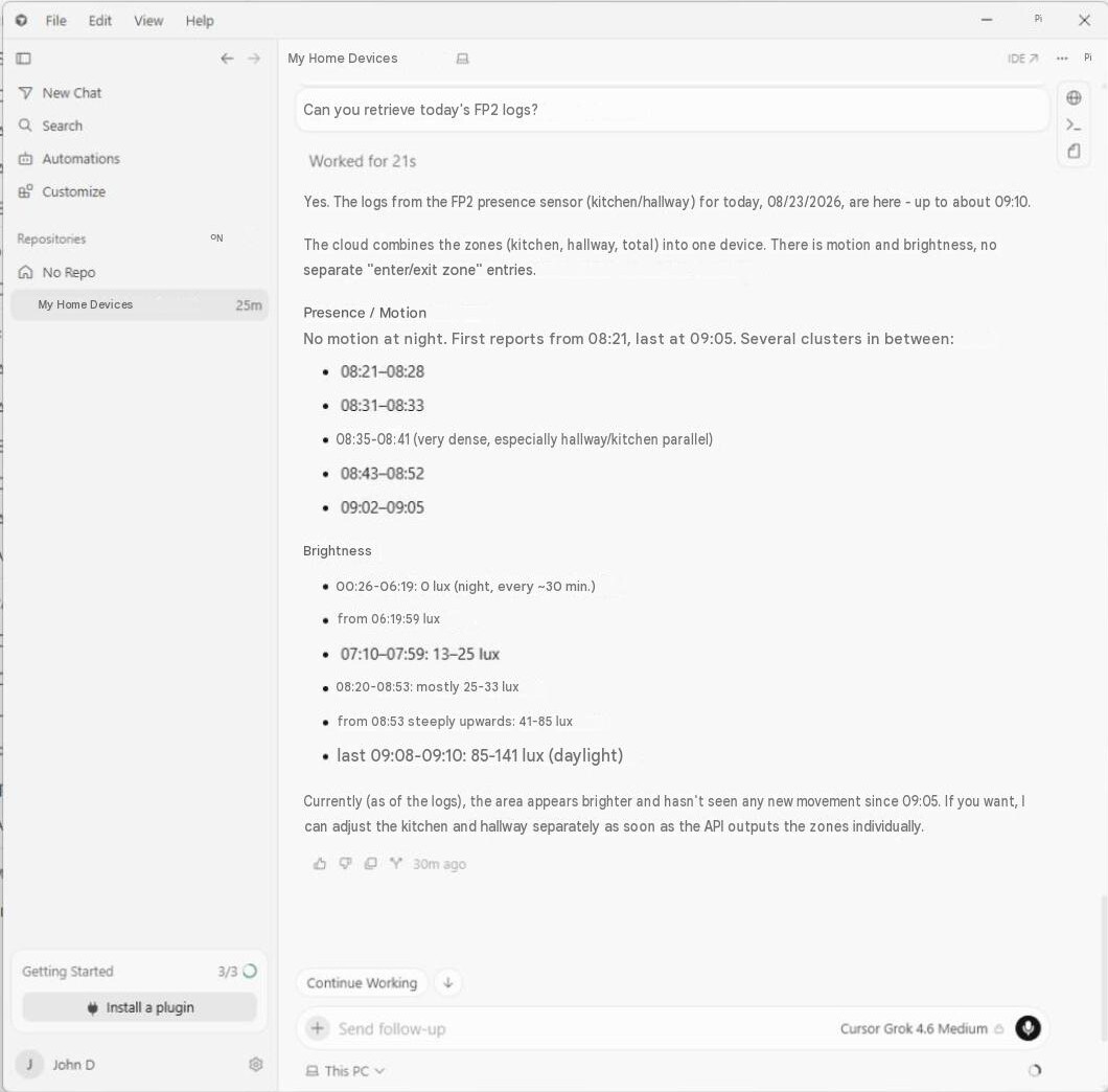

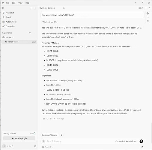

You could use the Aqara MCP Server, which can access the logs directly from the cloud. However, it only goes back a maximum of 7 days, as the data isn’t kept any longer than that. At least that’s what I’ve noticed with my sensors.
Since standard cloud-based AI’s usually don’t have access to this, you would need to install a local AI application like Cursor (you can download it here: Cursor · Download) on your PC or Mac. You can find the credentials and instructions on how to set up the MCP server in Cursor here:

OK, I understand. Unfortunately, I only use the zone detection feature on the FP2, not the sleep tracking feature. I’m therefore not sure if you can access the reports you mentioned using AI with either the MCP Server or the Aqara Agent Skills. You can try it and see what happens.
