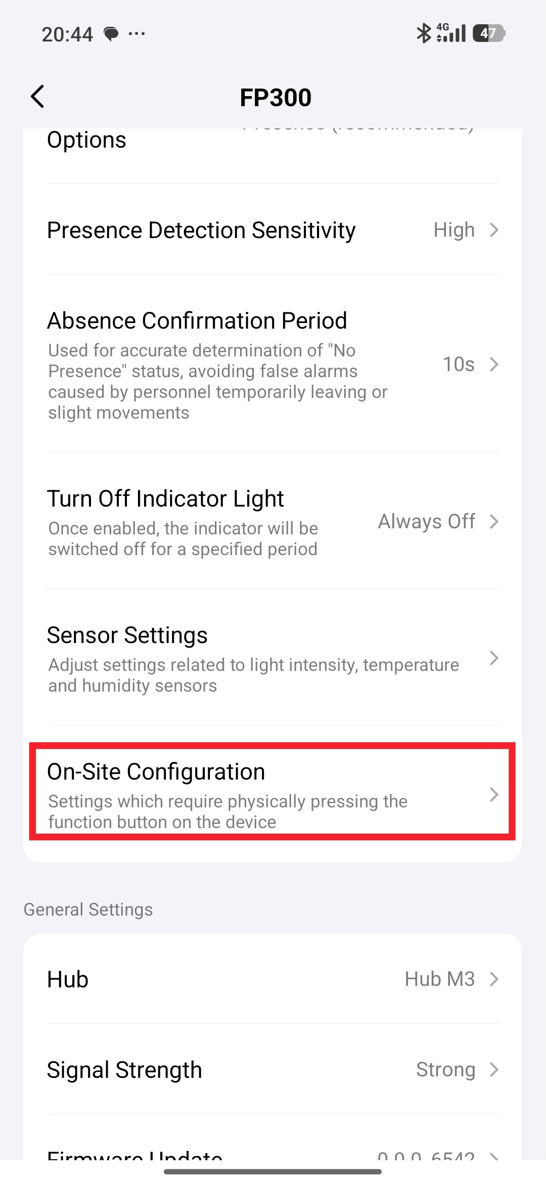

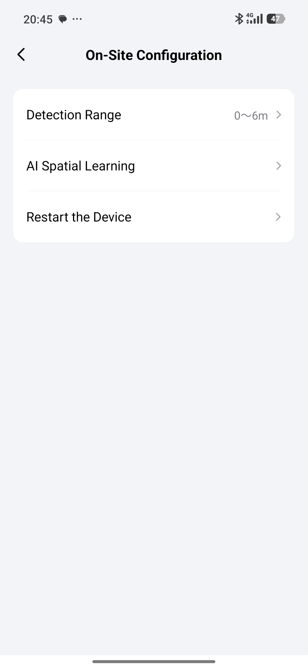

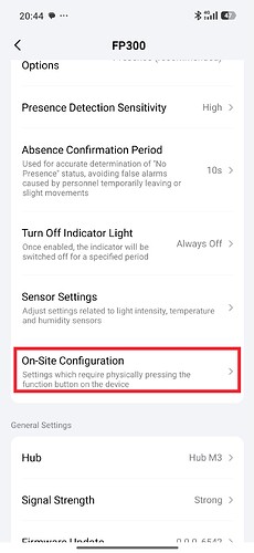

Have you tried enabling AI training for the FP300 sensor in the APP?
That option is not available through a thread/matter connection routed through an M100 hub and on to the Apple Home network.

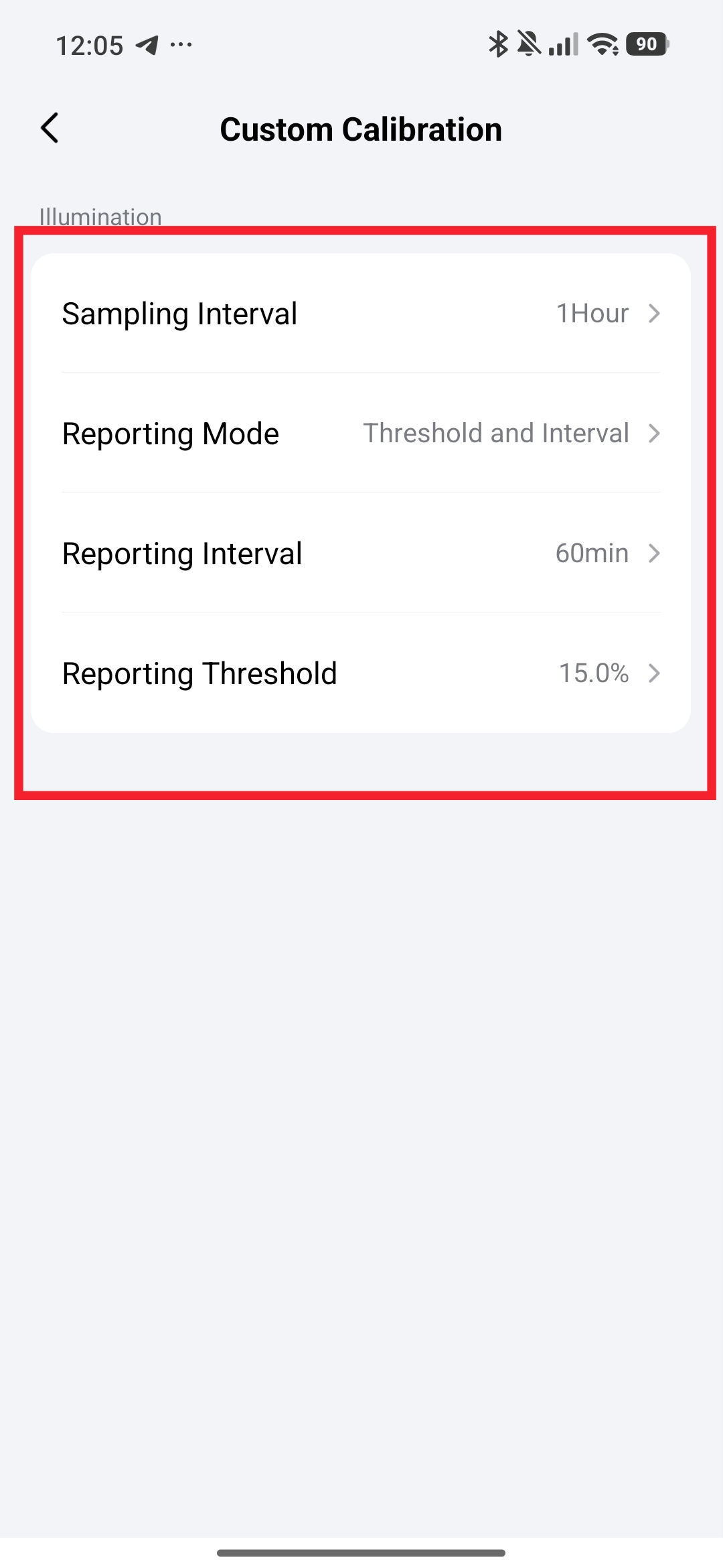

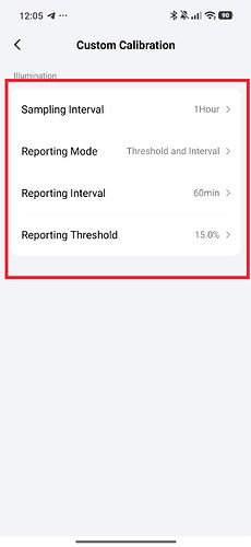

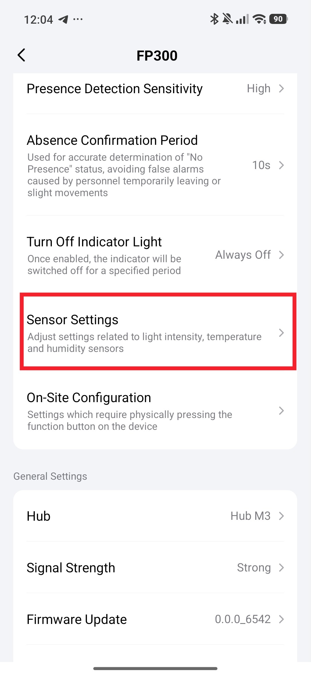

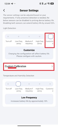

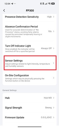

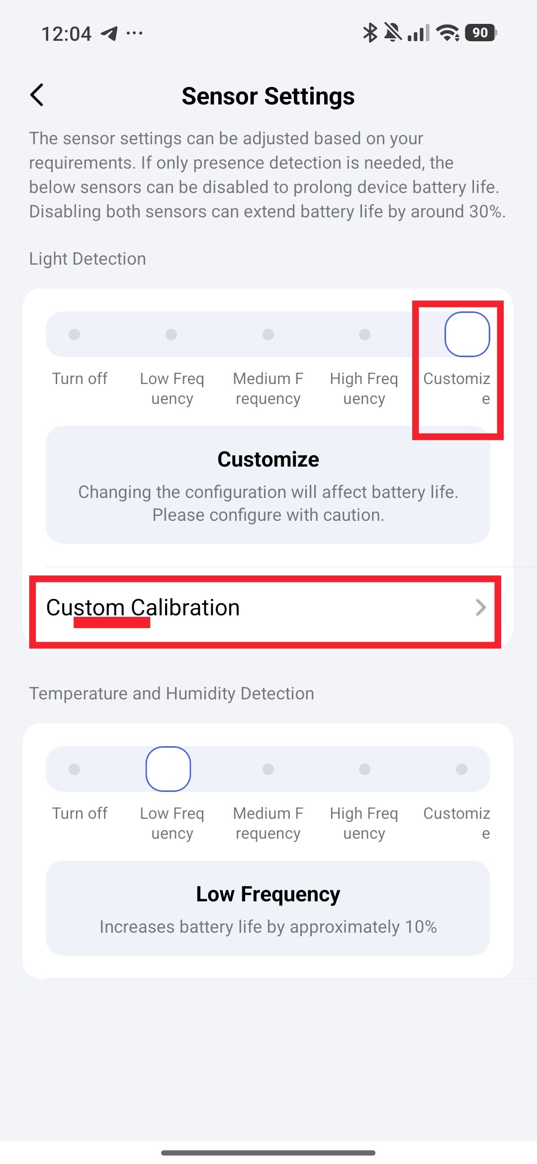

The measurement period is configured here
