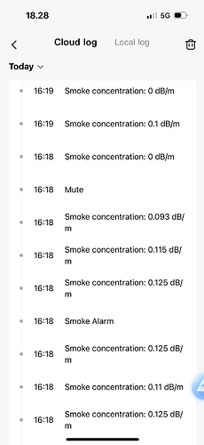

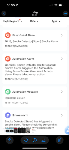

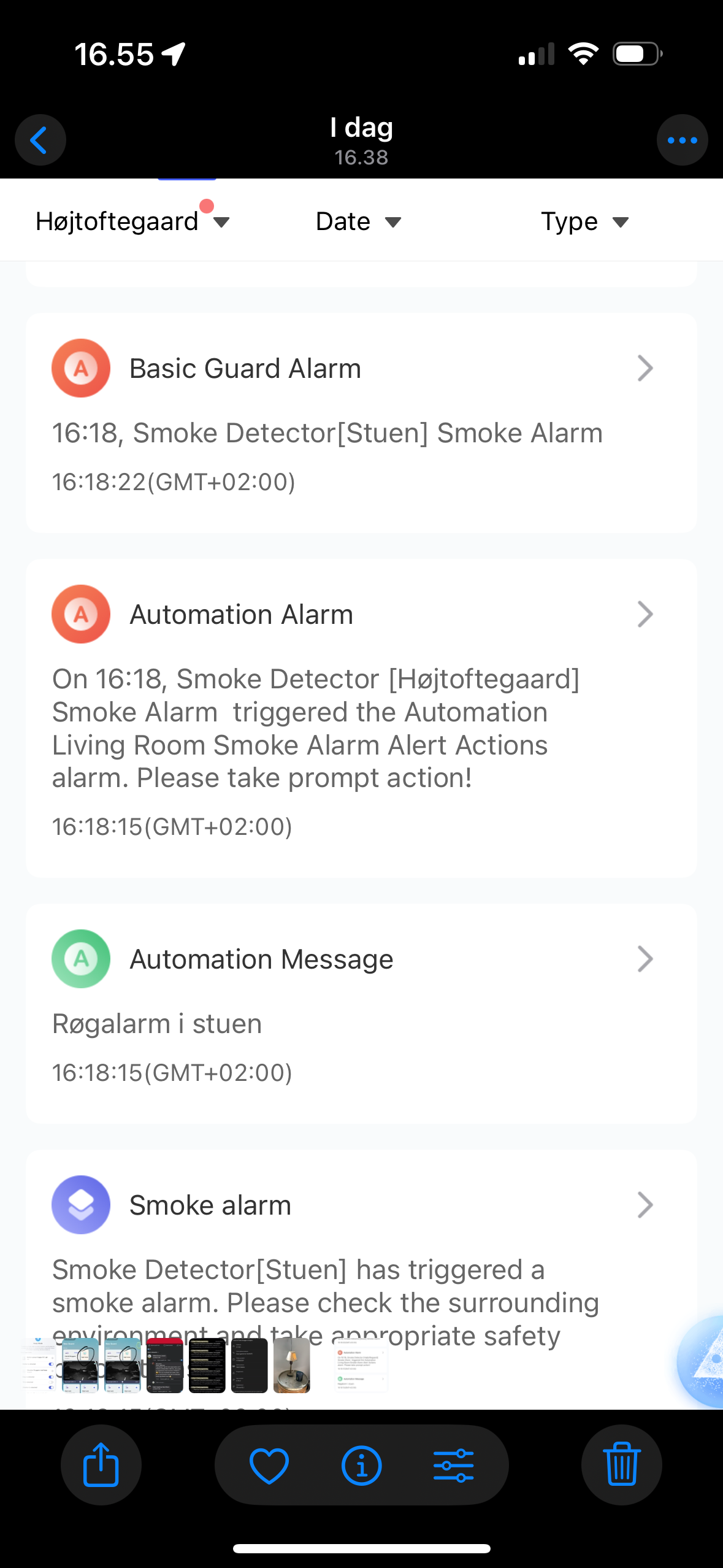

Hi, just had a scare, as my Aqara home security went off due to a less than 4 month old Aqara smoke detector reported smoke in my livingroom. Since I’m currently away on business, I called my good friend and neighbour who rushed home from work to check it out finding absolutely NOTHING wrong.
So my question is if others in here have had same experience as me (hope I’m just unlucky), but if others have had the same we need an update otherwise the products is not helping anything. :pensive:

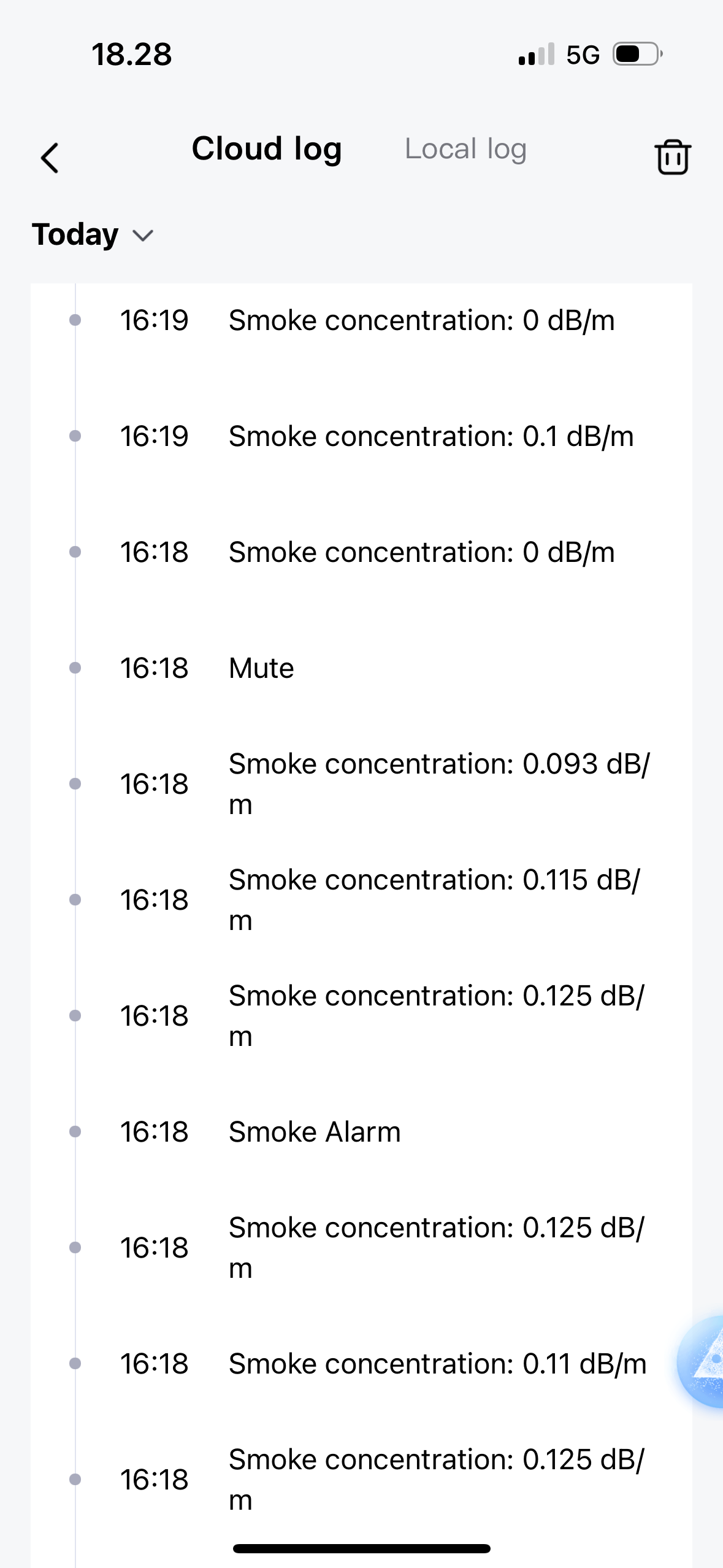

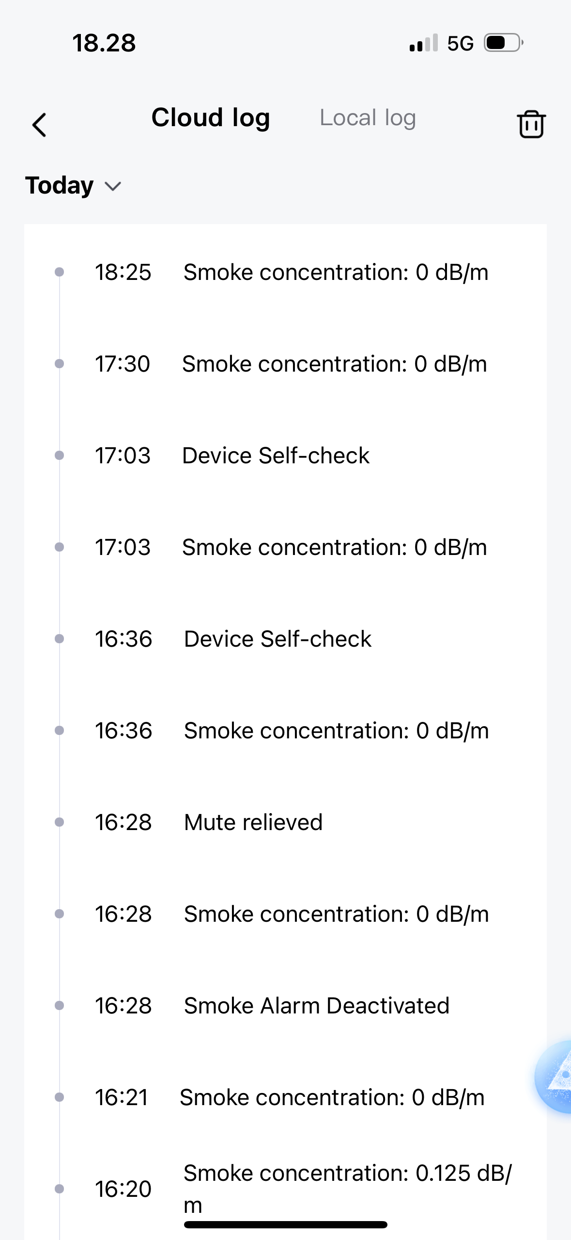

The strange thing is the log shows something for like 5 min going up and down and to 0 and then back up a little and then nothing more…

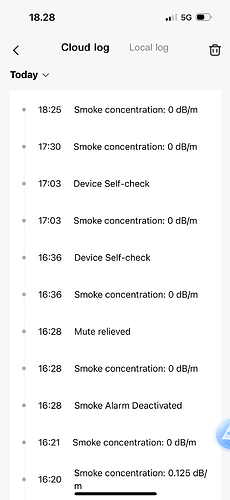

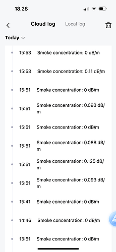

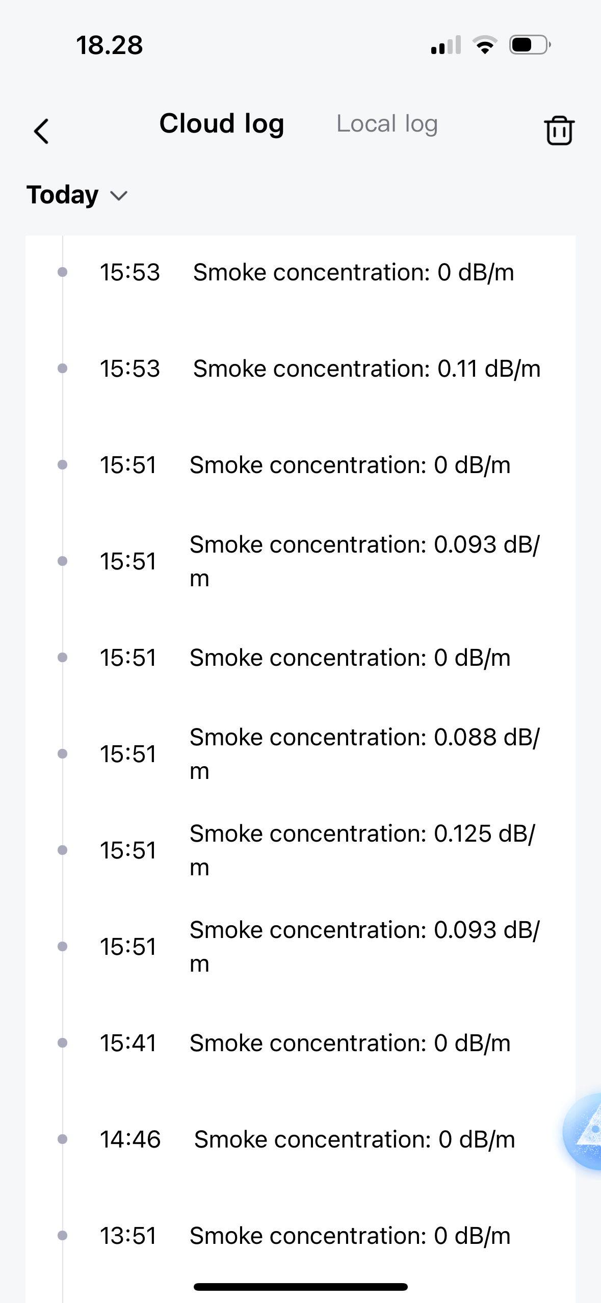

Today mine on the Living room is having the same issue. It triggered 2 hours ago to 0.11 or 0.125. I blew up some air on it, and it went to 0. Now again, the same issue.
