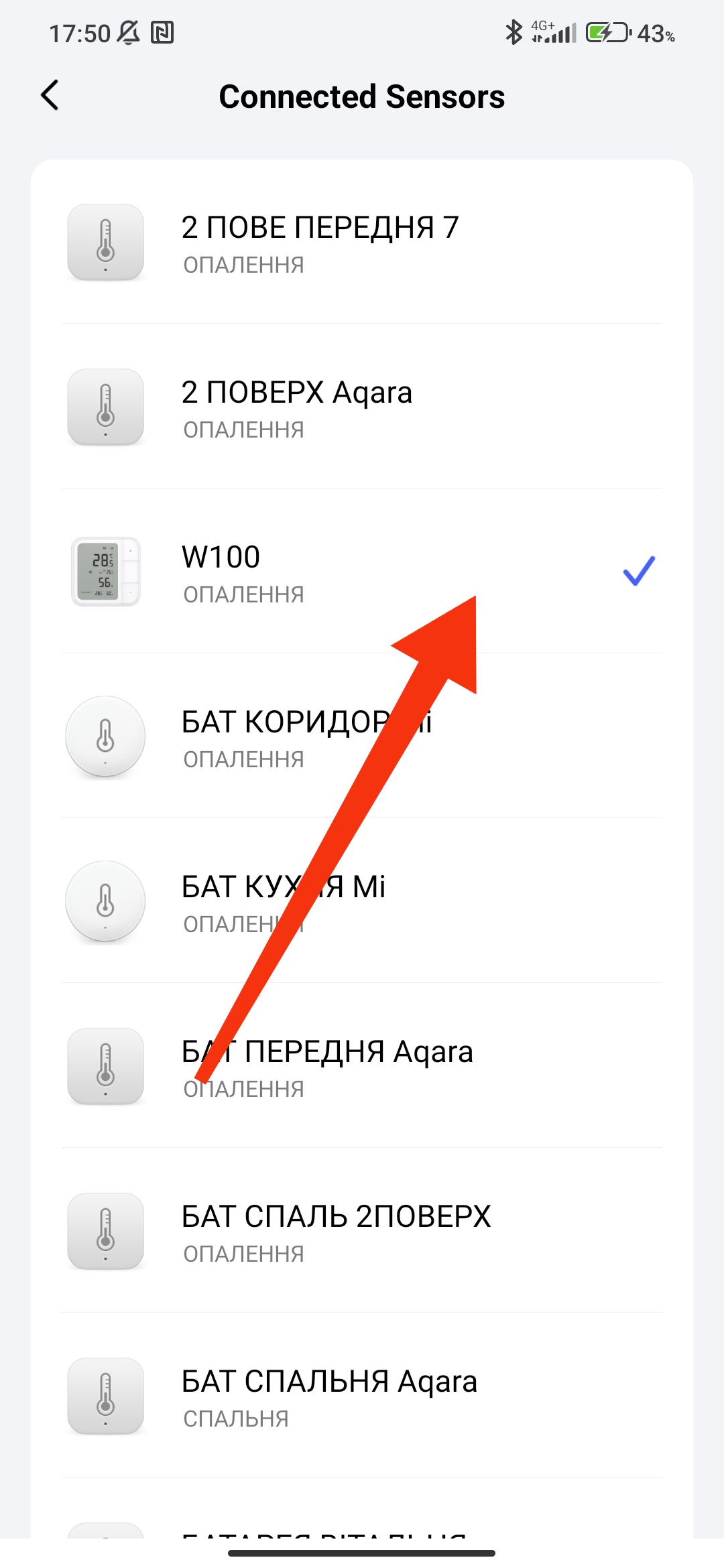

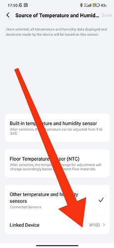

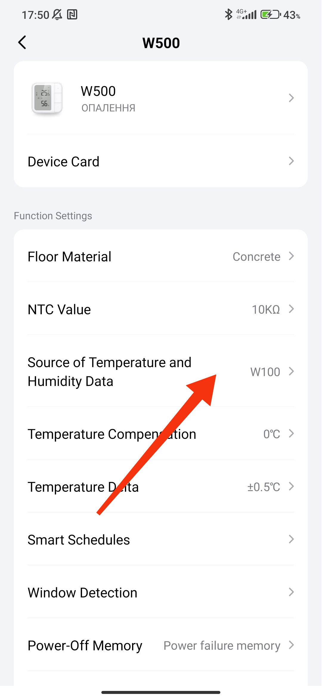

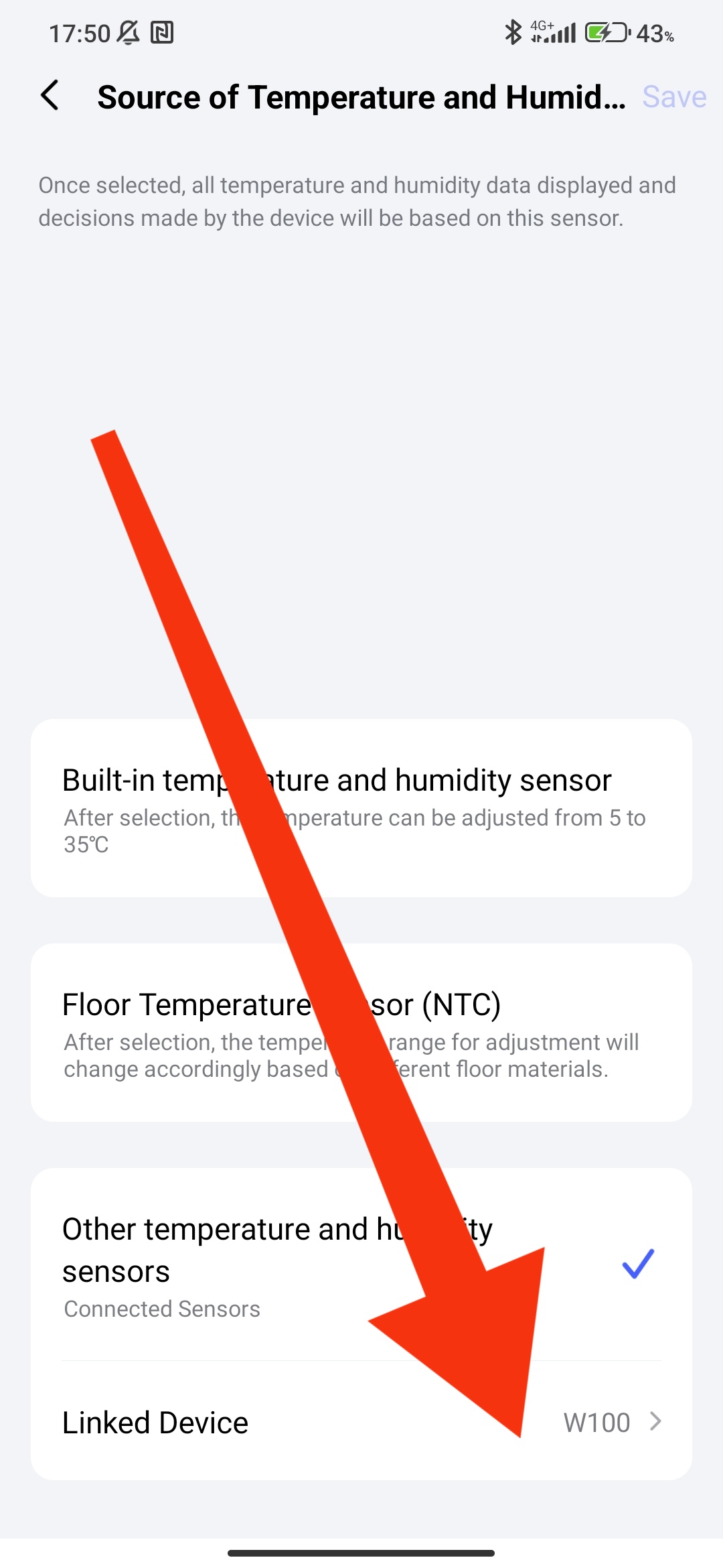

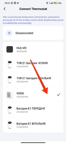

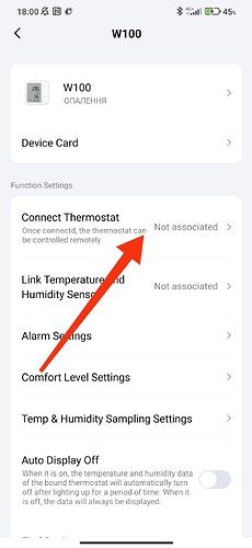

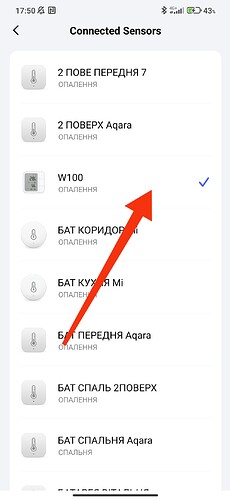

For information to users, the capabilities of the W500
After the new update of the W500, you can integrate the W100 device into the thermostat. This function greatly expands the capabilities of the W500, a portable sensor controller (W100) appears in your home for operation and control of the W500 thermostat anywhere in the house.
Step 1.W500

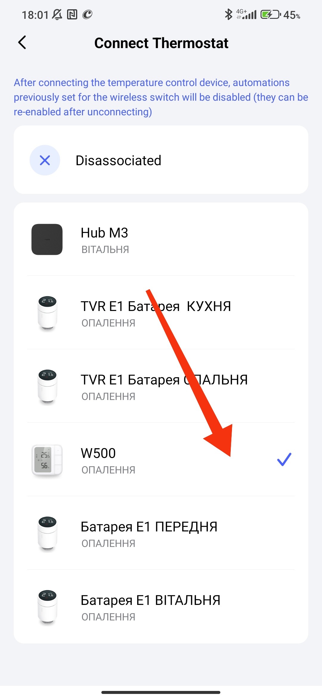

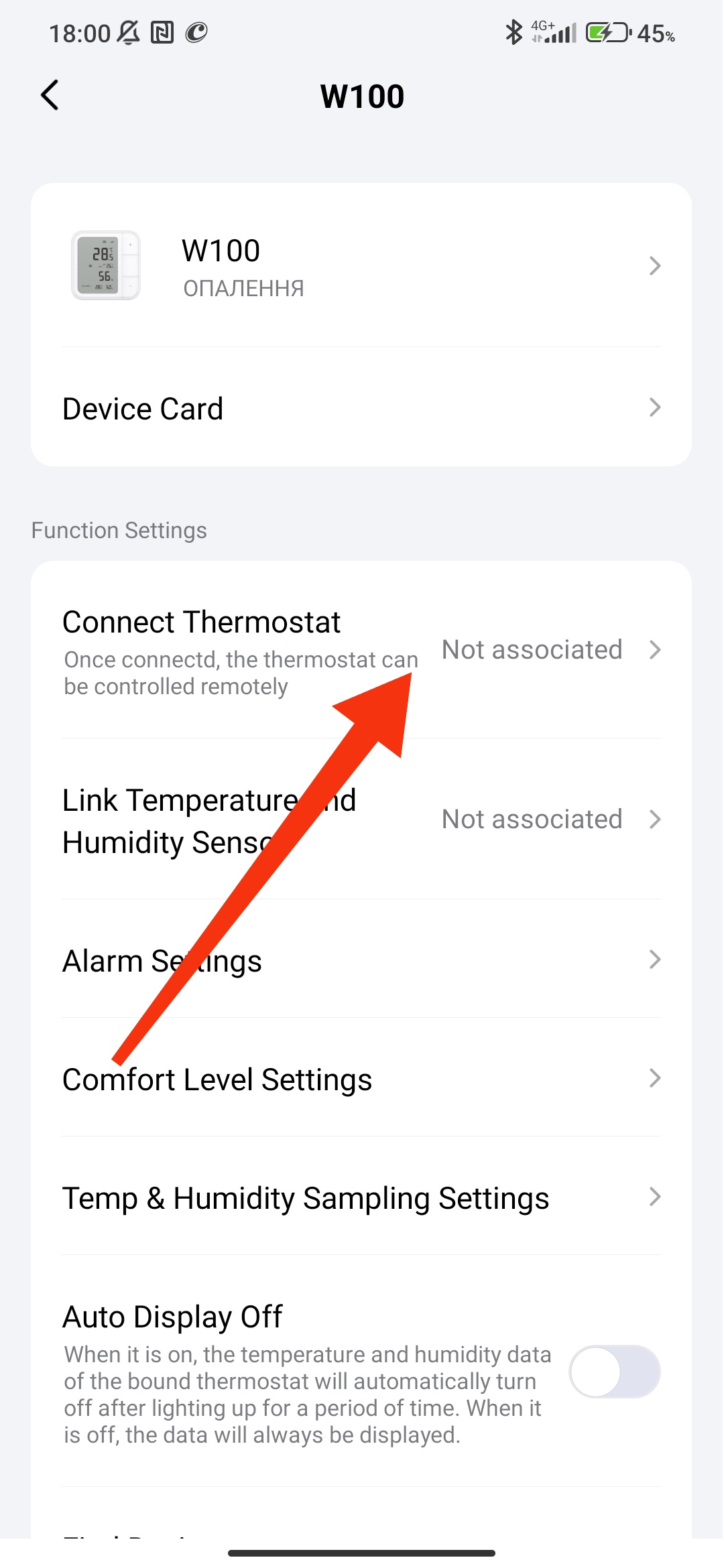

Step 2. W100
These settings are quite simple and will change the way you approach indoor temperature control.
