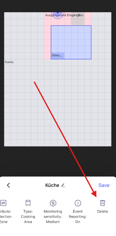

Hello, and welcome to the forum!
You created the zones in the Aqara Home app, and you can delete them there, too.
Aqara App → Accessories → FP2 → Zone Managment → Long press on the zone on the map → Swipe right at the bottom of the menu → Delete
You can also create a backup in advance by saving the zones as a template.
What exactly do you mean by that?
