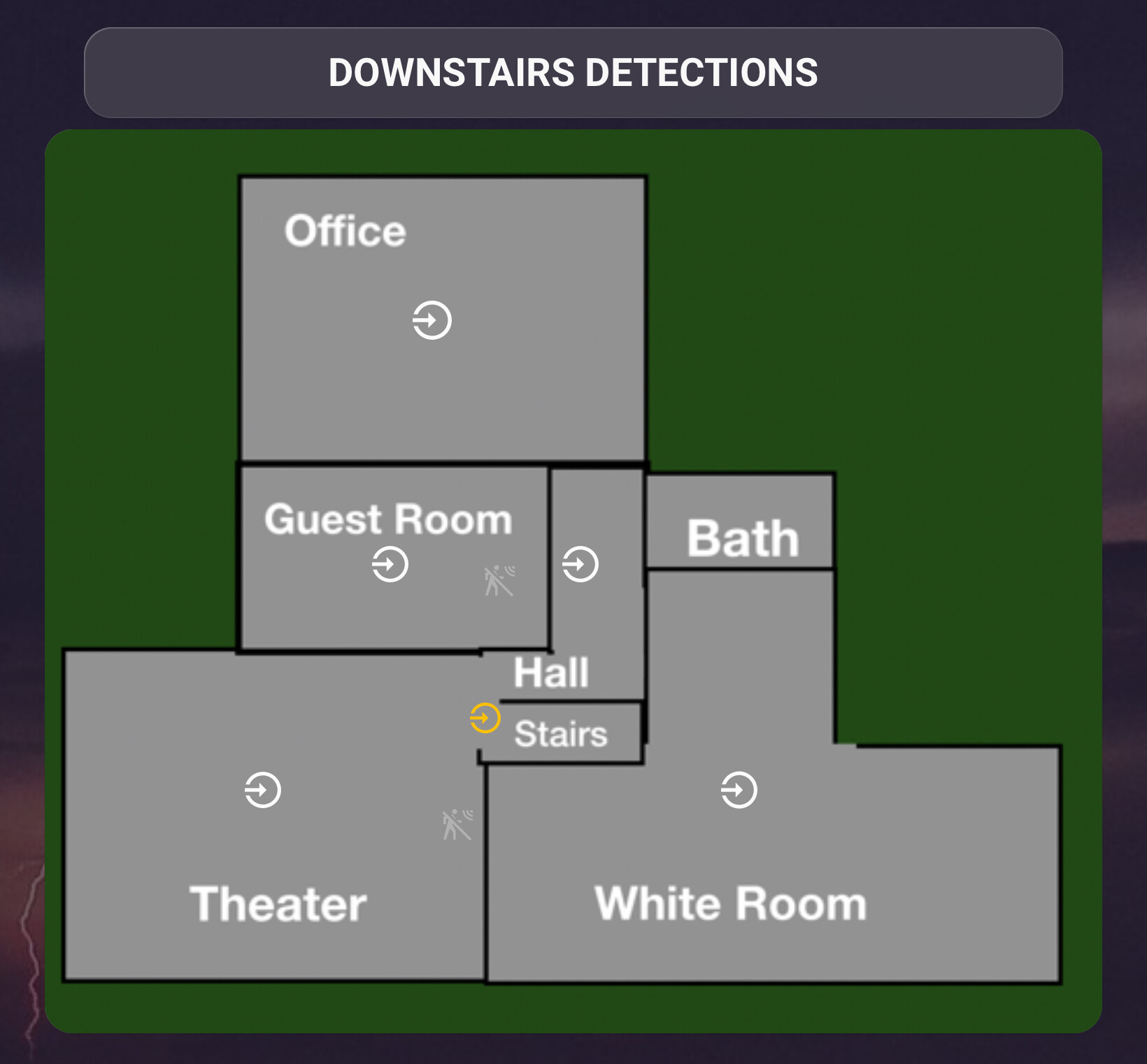

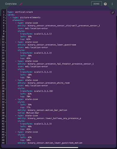

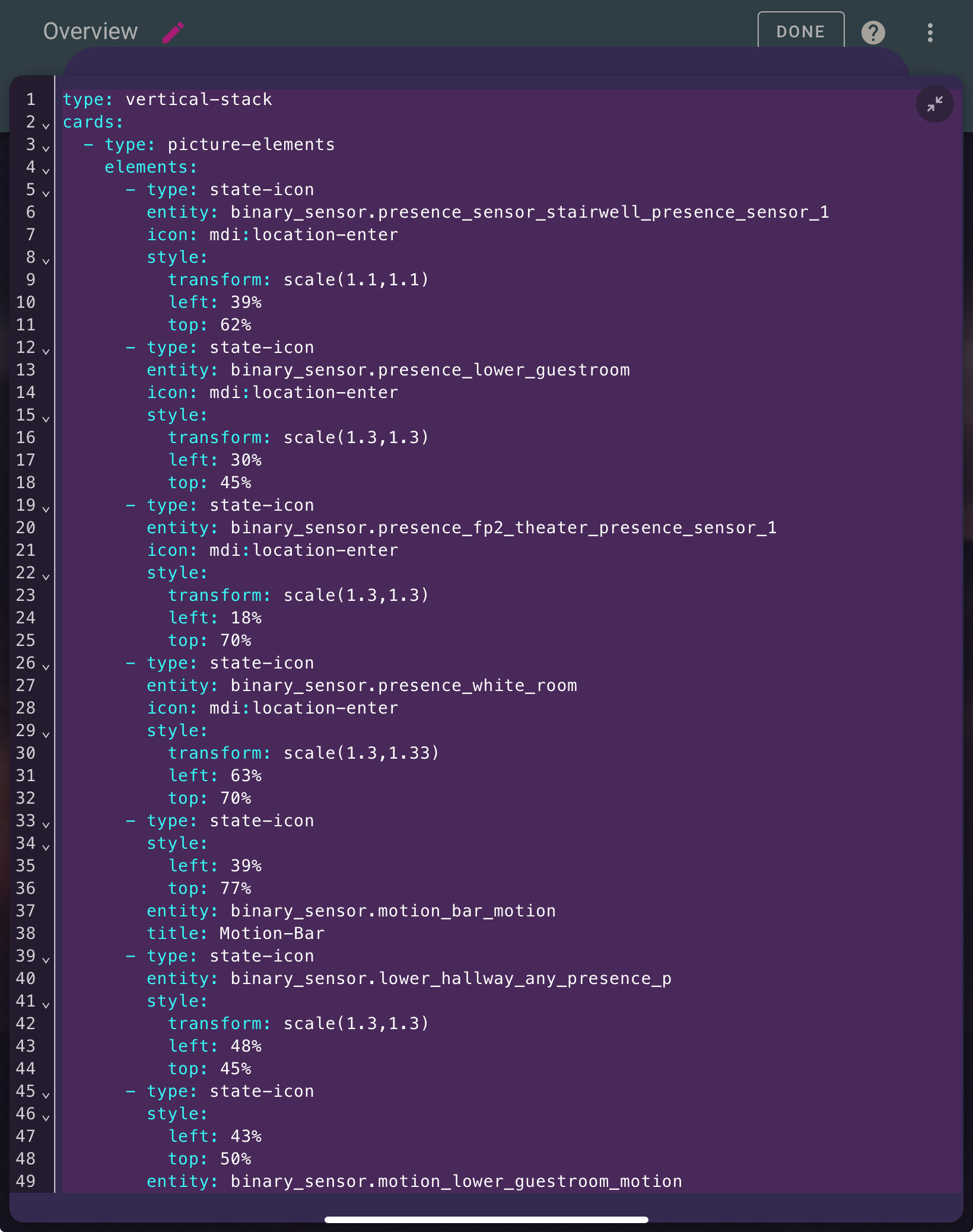

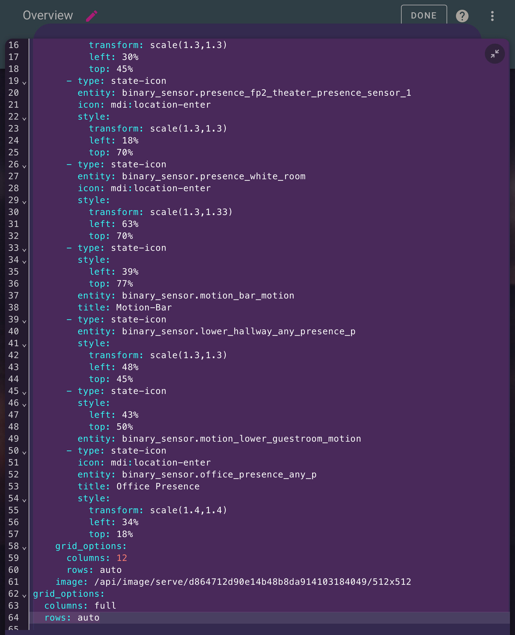

I do that now, but it takes some work.
  • Create a Home Assistant (HA) bridge to pass all your FP2 and/or other sensors to HA
  • Create an HA helper for each sensor of interest to you. I use binary-input helpers primarily.
  • You can create groups for the sensors to match your Rooms or Zones or even object locations like the living room couch. Just make sure the types of sensors match each other and the group type. You can use other helpers to convert device entity data types if needed.
  • Create one or more HA dashboard cards that show your room floor plan (what I use), or 3D model. I use the picture-elements card to show the floor plan (a jpg) and state-icon entities for each sensor I wish to depict in any location on the card. The state-icon entities can be attached to an Aqara zone presence helper or motion detectors or really other kind of sensor like window open/closed which I use on another dashboard.
See the attached dashboard picture and code (two pictures) for my card. In this dashboard I am showing which areas are occupied.
Good luck!
