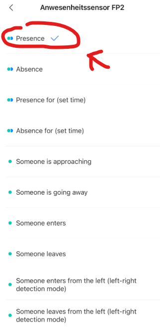

FP2 is integrated into Homekit, so you can turn it into a Matter device via Home Assistant. Take a look here:

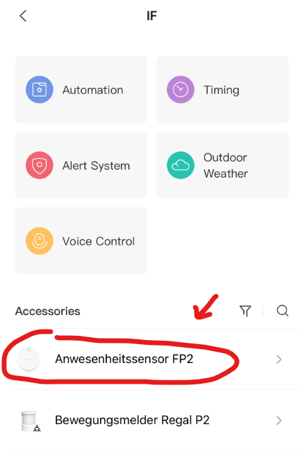

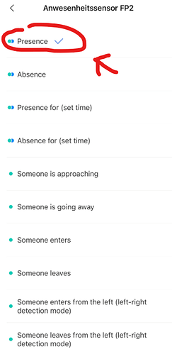

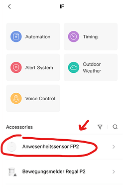

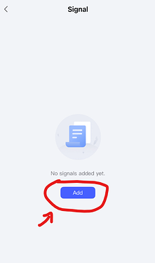

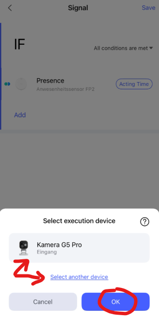

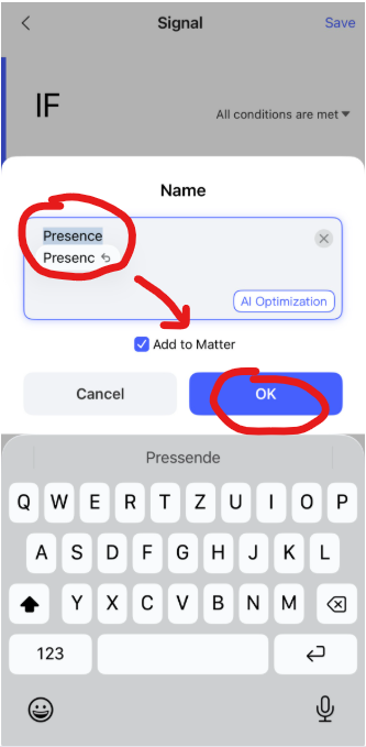

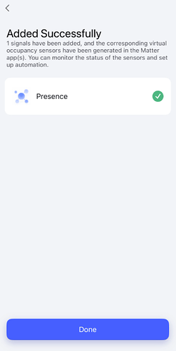

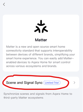

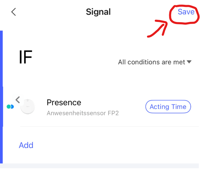

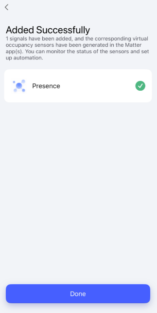

I just remembered that you can also send signals via Matter in the Aqara app.
This then appears in Home Assistant via Matter as a occupancy sensor, for example.
