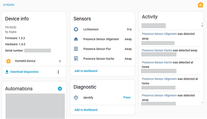

I had several entities from the start, as each zone you create is displayed as a presence sensor entity. In addition to each zone, an entity for presence in all zones is also displayed. So in my case, that’s 3 presence sensor entities:
  • Zone 1: “KĂĽche” → Kitchen
  • Zone 2: “Flur” → Hallway
  • All Zones: “Allgemein” → General (Kitchen + Hallway)
Don’t be confused. My kitchen and hallway are one room and one FP2 is installed there. I created two zones for the areas in the Aqara app.
