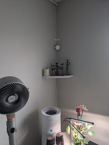

You can also send me a pic of the place it’s mounted- maybe I see something
FP2 is located in corn of room with a mesh router situated in the adjacent corner on identical corner shelf.
