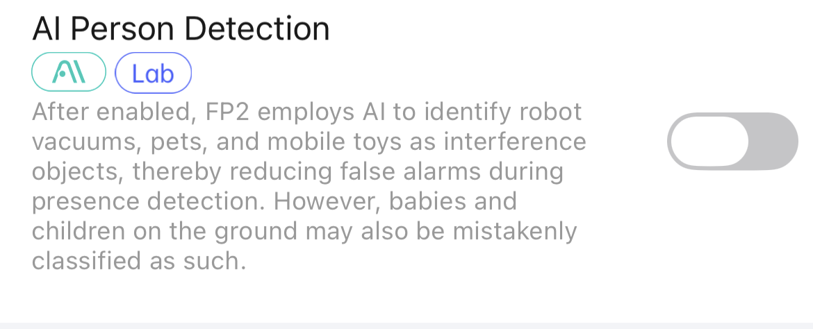

You can try AI Person Detection, but it may result in poorer recognition of people. This is likely to be particularly problematic with seated people.
