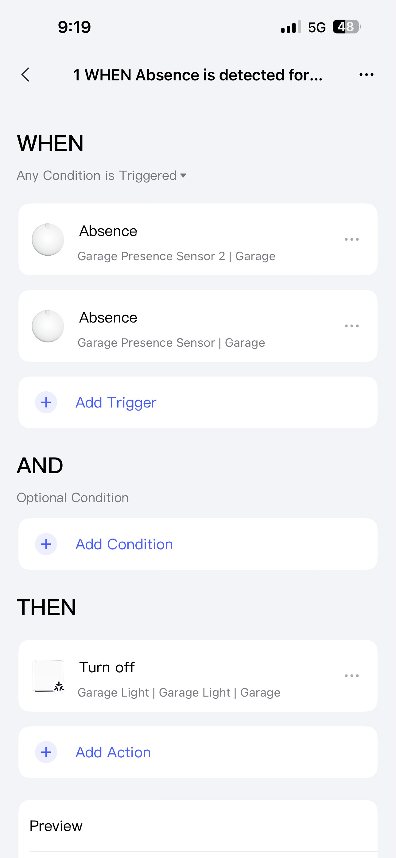

I’m using 2 FP300 sensors in my 20ft x 24ft garage. Both are detecting presence and absence as I’d like them to. I’m using presence to keep the lights on, Kasa Matter Switch, and then absence to turn the switch off after 5 minutes. No matter how I setup the automations the lights turn off after 5 minutes even if I’m still in the garage and presence is showing as detected on both sensors. Not sure what I’m missing or have setup wrong. Any ideas?
I’m using the Zigbee protocol with the sensors connected to a M100 hub in the garage with full signal strength.

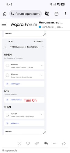

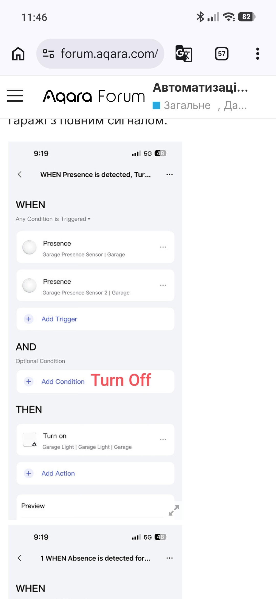

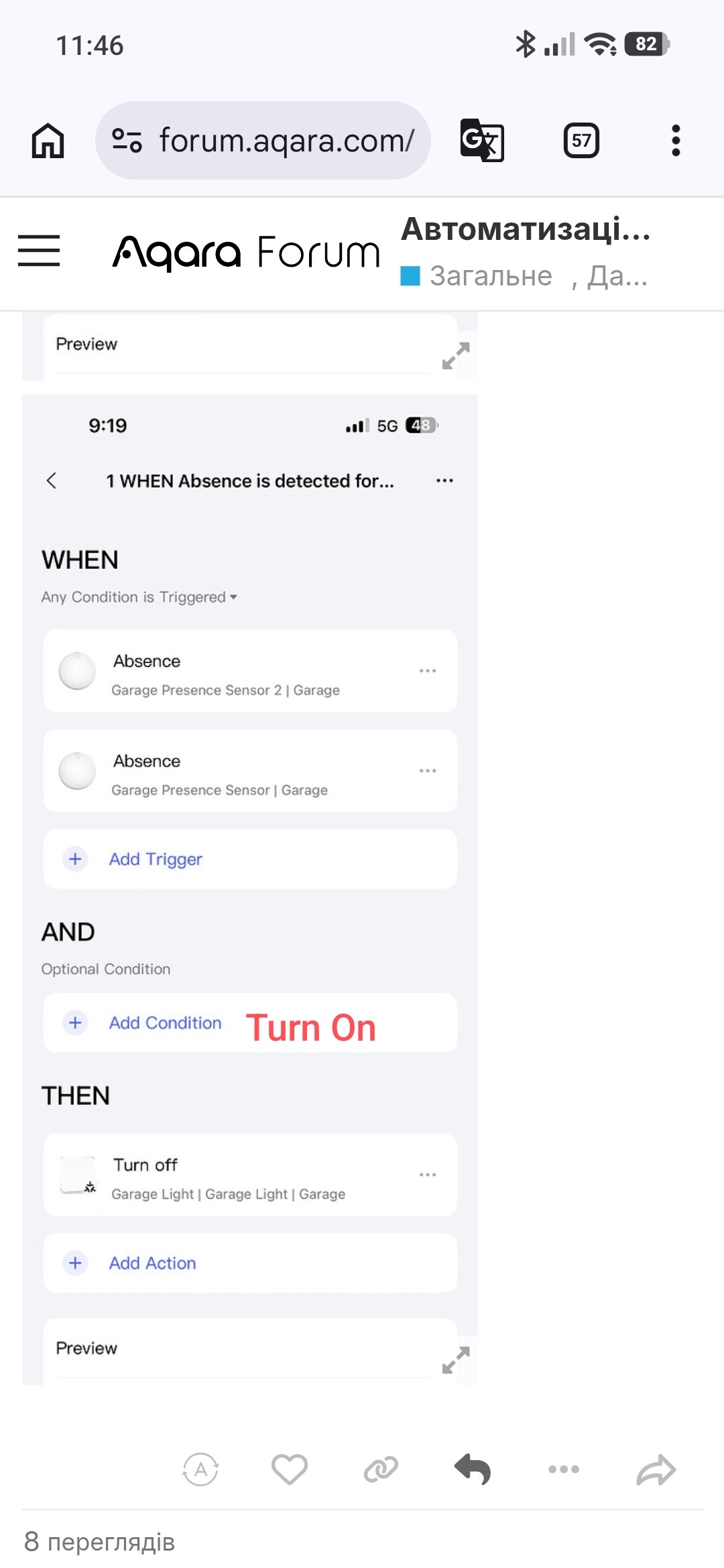

Hello, add automation, the logic will work only when necessary.
Alternatively, one of the two sensors may “not see” you and therefore trigger “Off lamp”. Make separate automations and in the IF section add the sensor status for On.
Make one automation separately for “Off lamp” and enter two parameters for two sensors in the IF condition “if there is no movement”.
