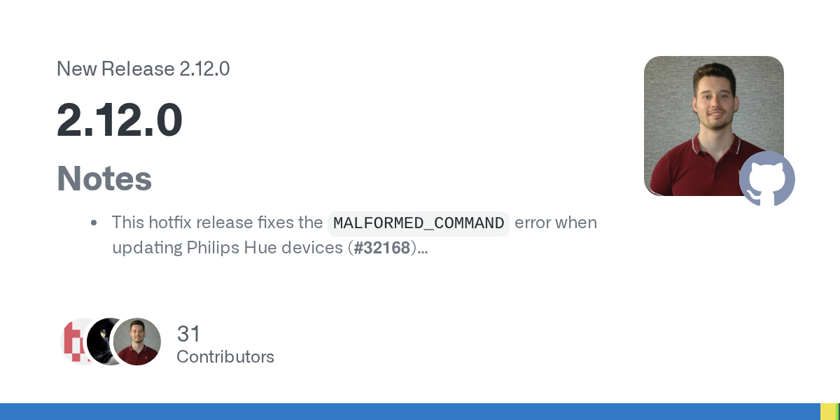

The next version of Z2M is out, it has

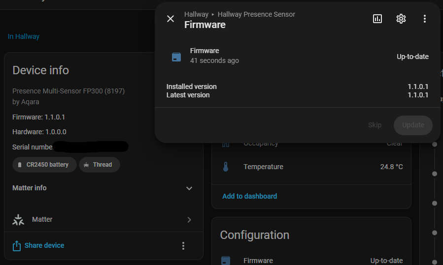

Do I have to have an aqara thread hub to be able to update? I connected FP300 to apple home and home assistant directly via thread, none of them showed the updated.
Also, my FP300 become unresponsive today (after three weeks of installation), is this expected?
How do we get the firmware on Home Assistant for Matter over Thread @Blaze?
Without using an Aqara Hub or app.
