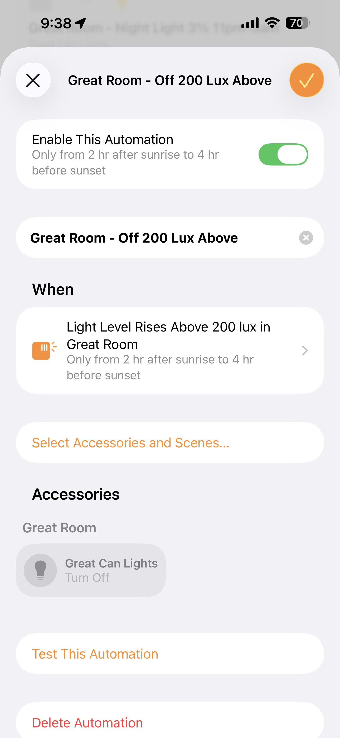

Here is an example of the automation:
Light level rises above 200 Lux in Great room, then turn off great room lights.

hi, can you show us the setting screenshot of this automation?
Hi Caroline_Zzz - here is the automation. Let me know what I need to modify.

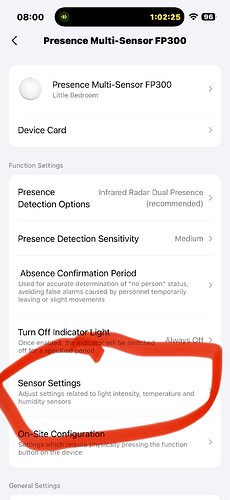

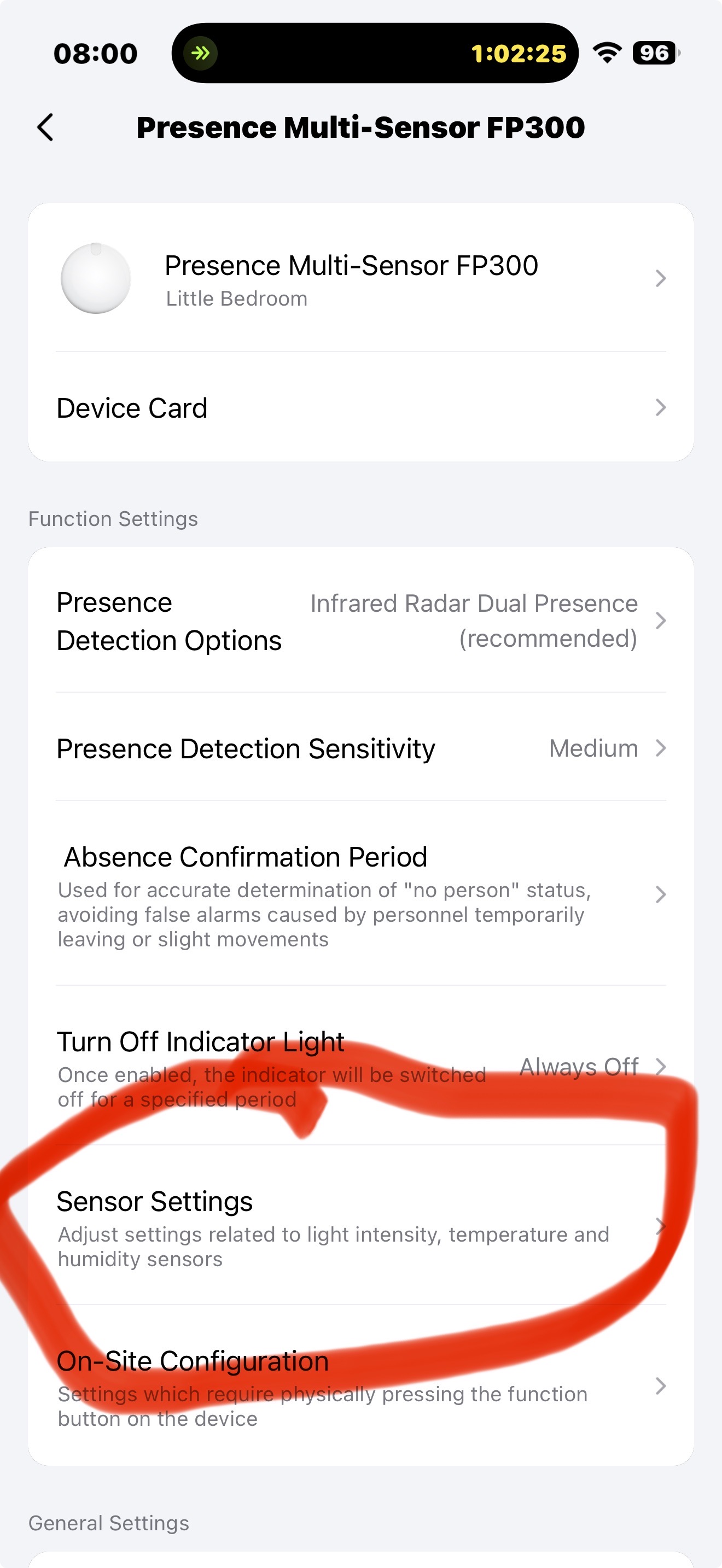

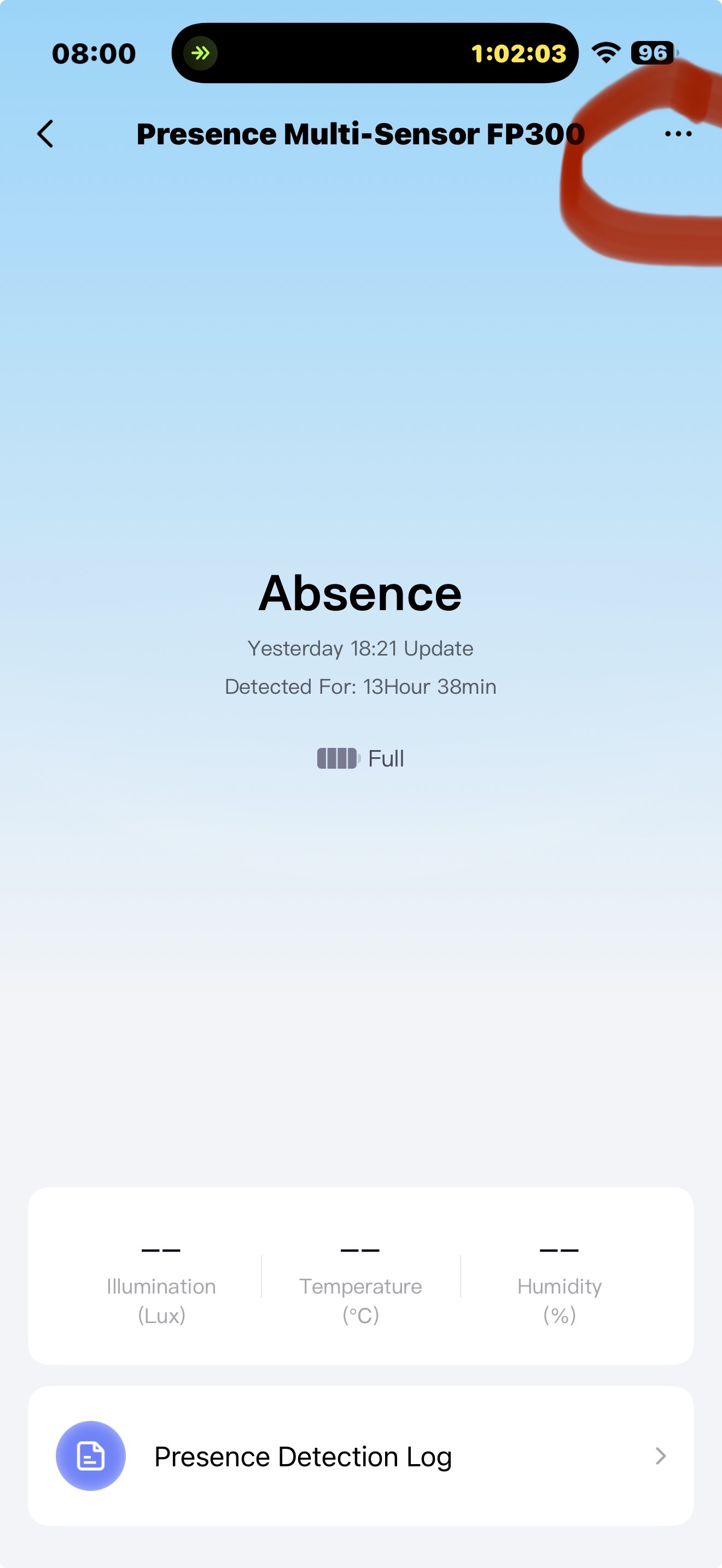

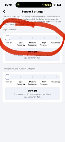

Hi, if you follow the screenshots in the Aqara app, you can be able to higher the
frequency of defection

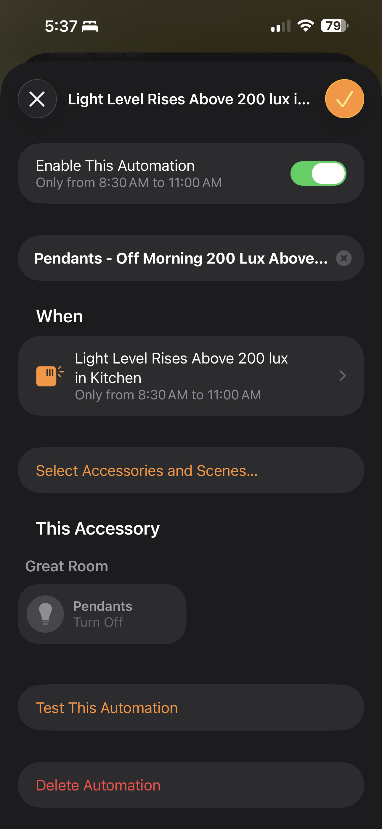

You’ve set it up so that the light level has to cross the 200 lux threshold (either rising above or falling below). If the value doesn’t rise above 200 lux within the specified time window (2 hours after sunset until 4 hours before sunrise, or between 8 AM and 11 AM) and then drop below it, the automation won’t trigger. For example, if the level is constant at 120 lux starting two hours after sunset, the automation won’t fire because the drop below 200 lux already happened before the scheduled window began.

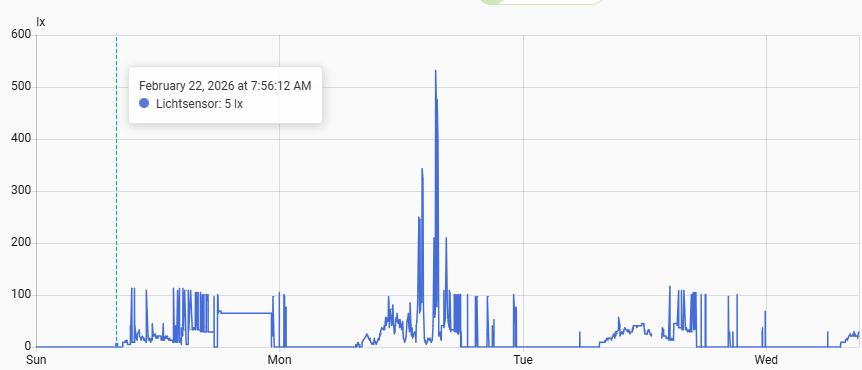

Looking at my own lux readings from the past month with the current weather, 200 lux was only exceeded on a few days in the afternoon. In my case, the automation wouldn’t have triggered on a single day.
Suggestion: Keep an eye on the lux values in the app during your scheduled times over the next few days and try setting a lower threshold for the automation.
Also, keep in mind that switching the lights in your room on or off could cause the automation to trigger.
