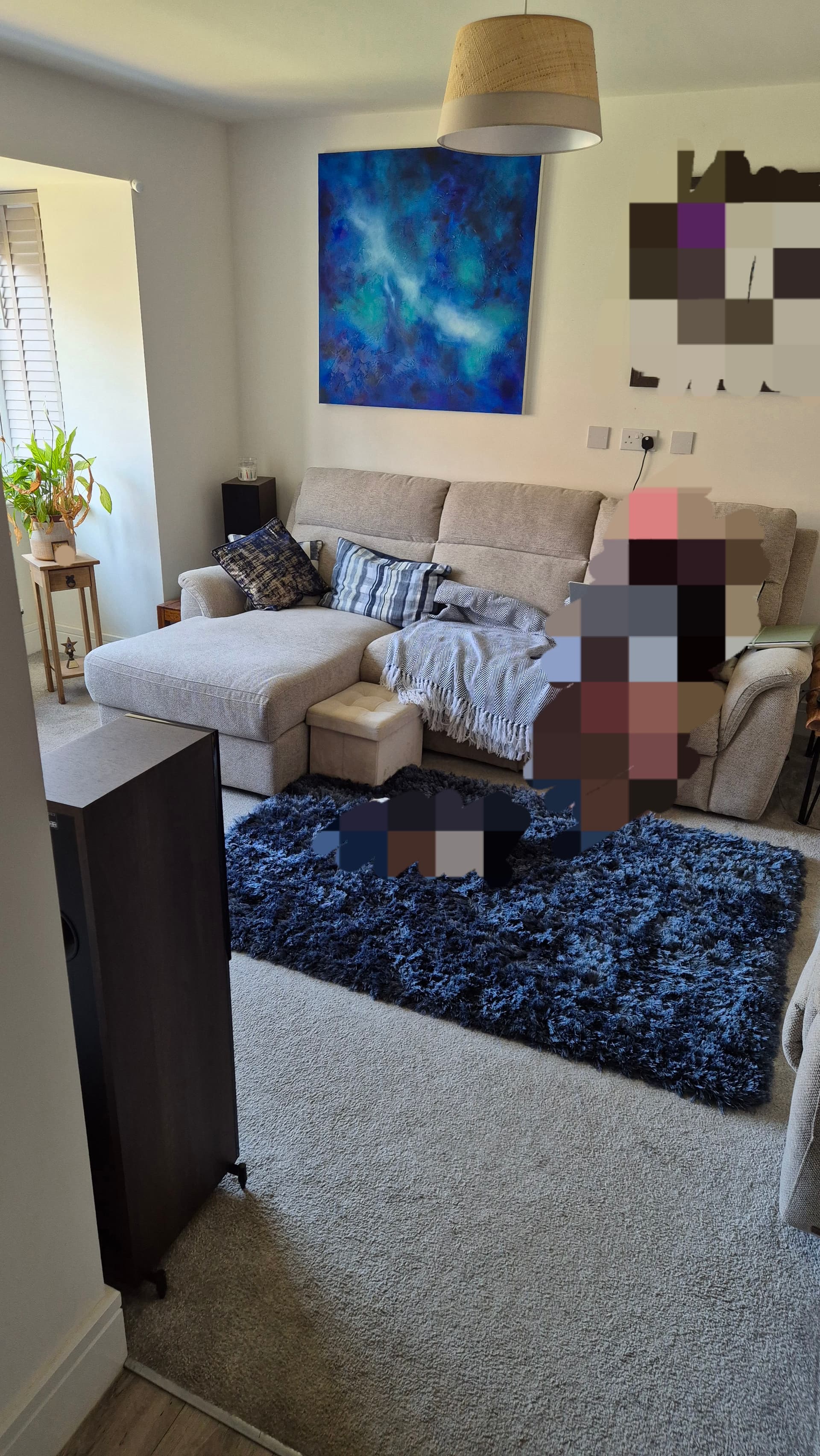

Mine is genuinely perfect most of the time, with us sitting on the sofa (still) for a long time in the evenings and the lamp stays on (i.e. presence is continuously detected) and turns on and off immediately upon entering and exiting the room.
Perhaps you should keep trying with positioning and trying different settings!

Thanks so much for the photo! Your room and sensor placement are actually surprisingly similar to mine, which makes your experience even more interesting.
I also tested two different FP300 units and swapped them between rooms, with very similar results. Once presence was detected they could sometimes maintain it quite well, but initial detection was unreliable unless I was very close to the sensor or crossed directly in front of it.

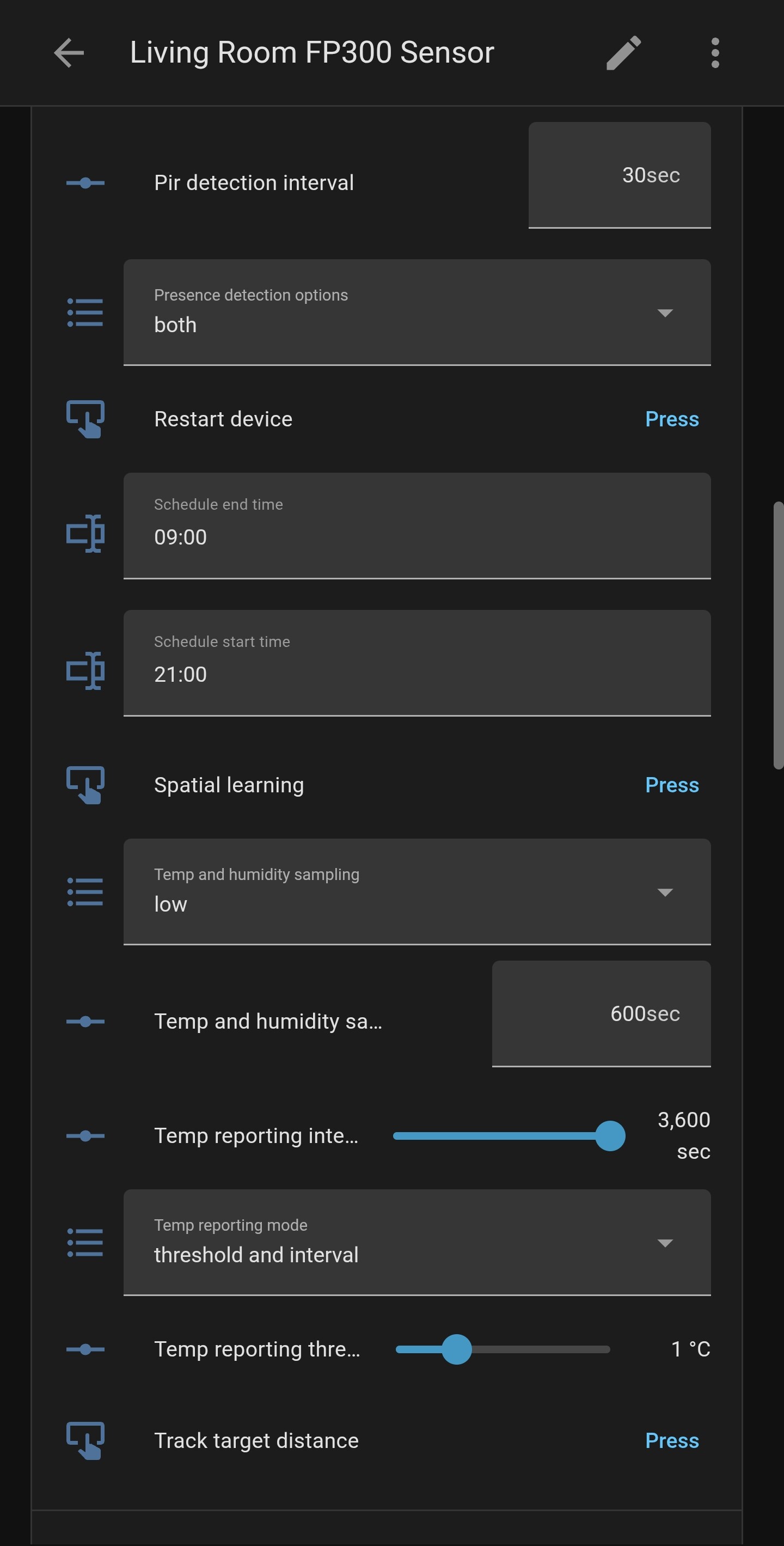

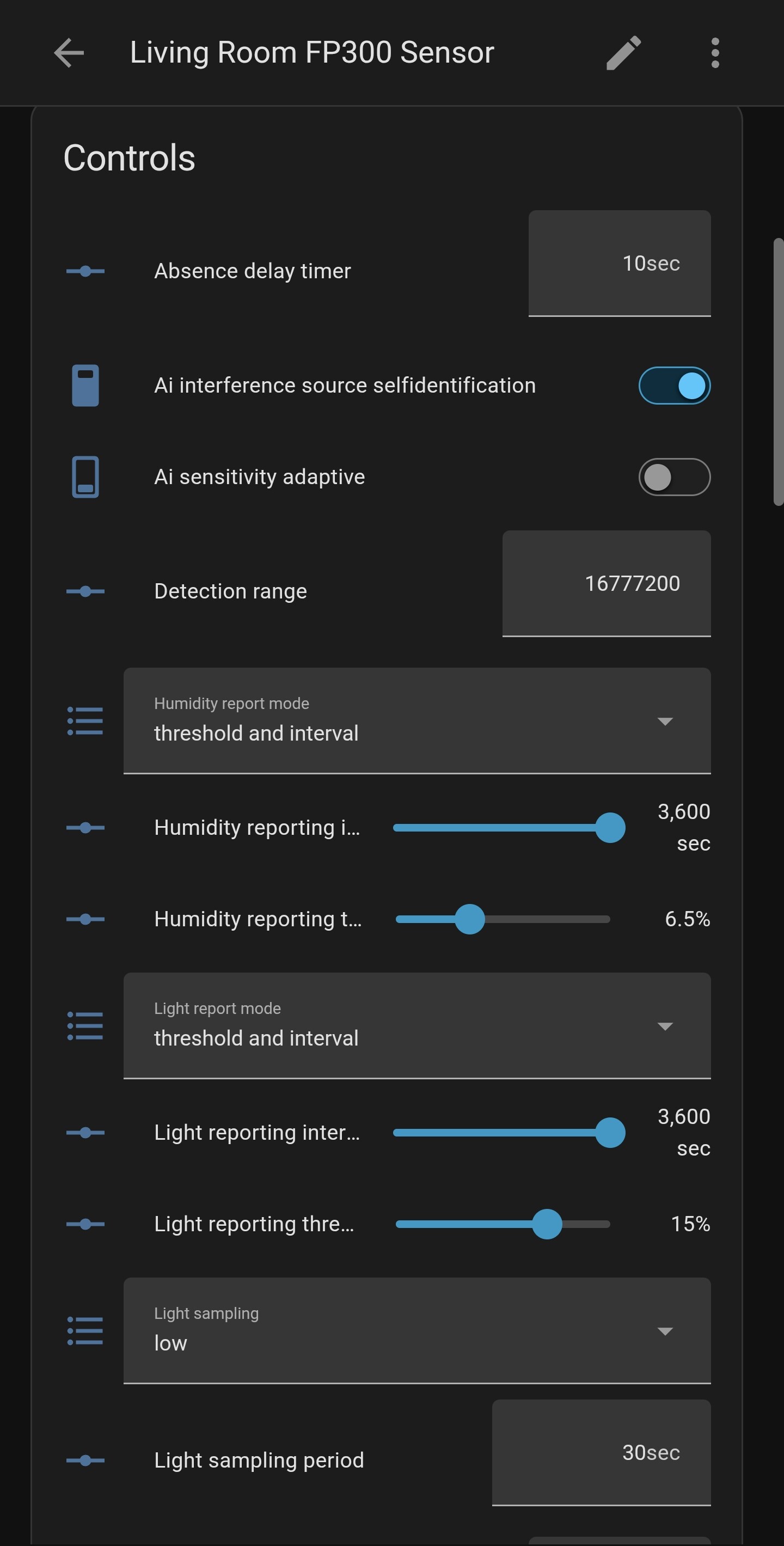

Since yours is working so well, could you tell me which sensitivity and detection settings you’re using? I’d really like to try your configuration before giving up on the FP300.

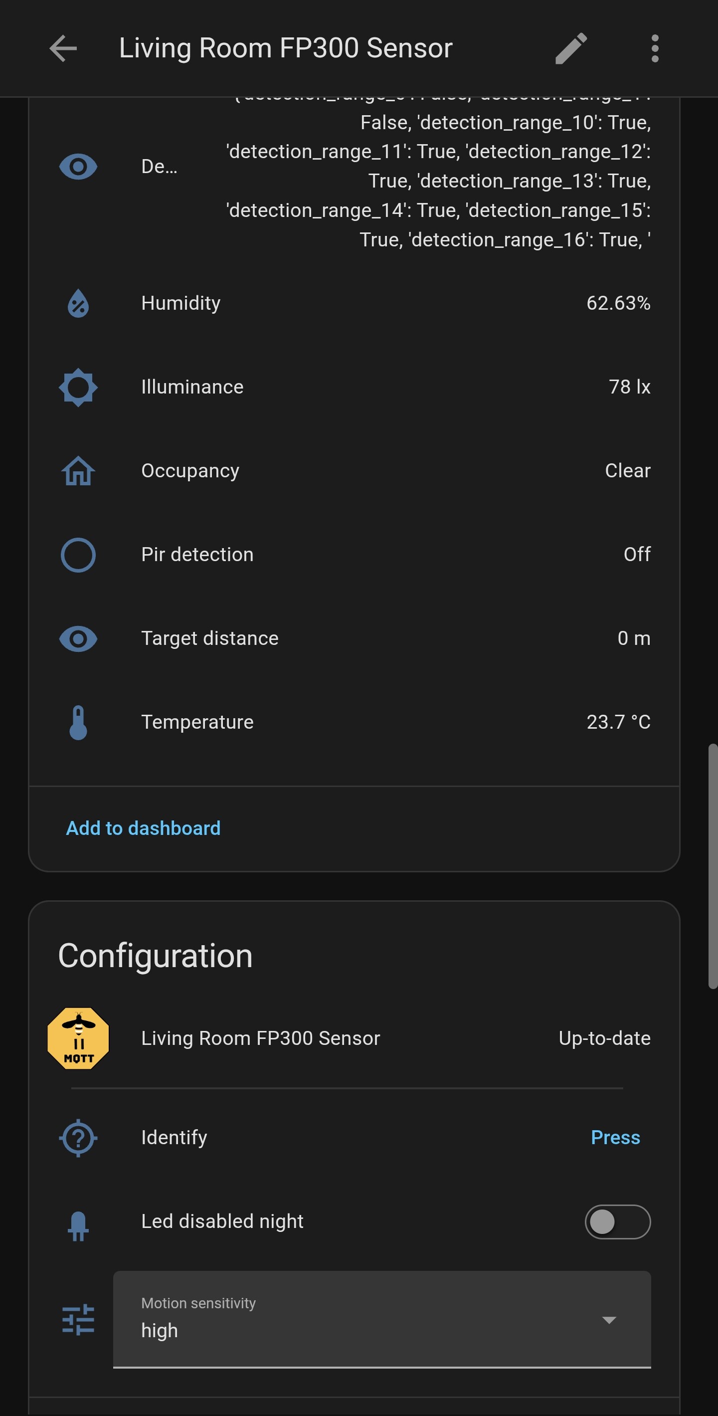

Thanks! Yes, I tried different sensitivity settings, including high sensitivity.
I also tested the sensors individually and swapped the two FP300s between rooms to rule out both a faulty unit and possible interference between them. Interestingly, both sensors worked much better in the bedroom, while both struggled in the living room.
The main issue in the living room was initial detection: once presence was acquired, they could sometimes maintain it quite well, but they often wouldn’t detect me entering or moving around unless I passed very close to, and directly in front of, the sensor.
That’s why I’m now wondering whether positioning or some specific setting is the key. Another user here has a very similar room and says theirs works perfectly, so I’m going to compare their settings with mine before giving up on the FP300.
I’m using it with Zigbee MQTT in Home Assistant.
One other thing I would also try is clicking the spacial learning on it (having left the room first) and possibly also reducing some of those detection areas, which you can do in Z2M or whatever you use.
