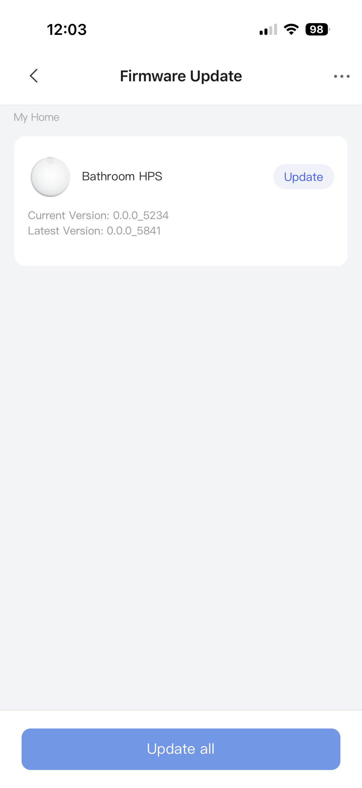

I’ve managed to update my firmware from 5234 to 5841 by swapping to Thread and then back to Zigbee in the Aqara app. Z2MQTT now showing a the new firmware version. am really hoping that battery level will update in time as they are only about 90 days old.
New thread firmware 1.1.0.1.
In the Aqara app switch to zigbee and then back to thread. Or wait for the firmware through the Aqara app.
Thanks to @andreas_roedl who found this.

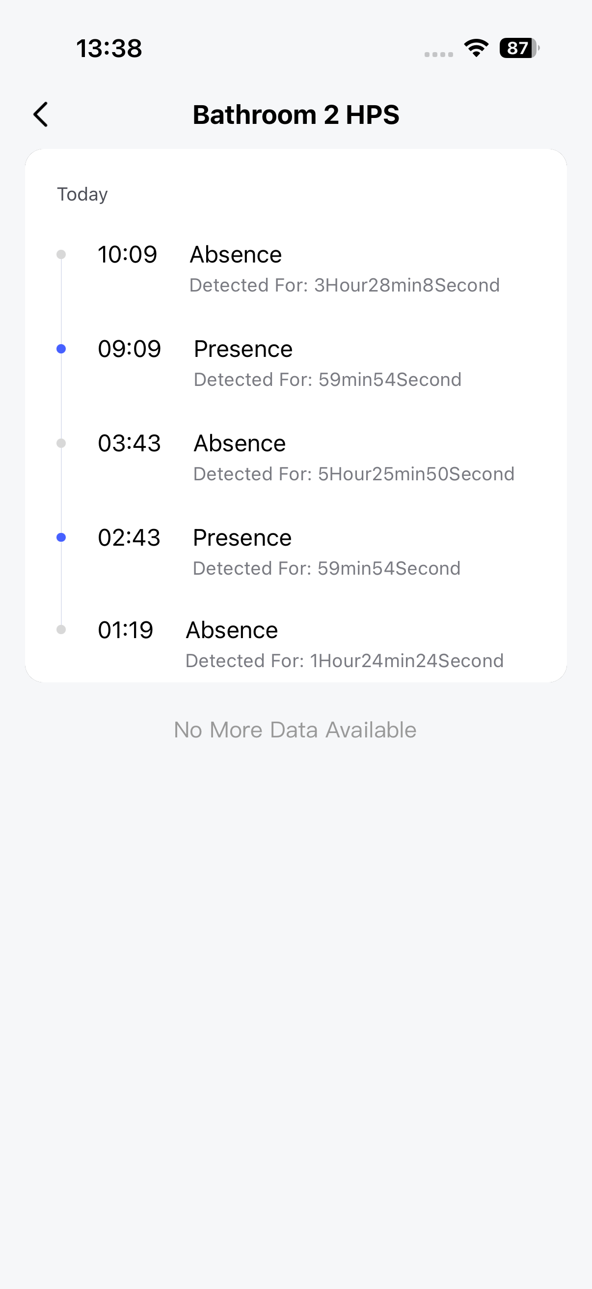

Now I have the FP300 connected through SmartThings, Apple Home and Aqara Home.
It detects Presence but only goes to Absence after 1 hour (see image).
@peterChengg @Tech-savvy @AqaraOfficial
I have read this forum and others and kept giving it a chance, unfortunately I keep seeing too many ghosts and the presence sensor is not accurate. I am returning my sensor, but I hope Aqara can fix this because it’s actually a nice product… if it works.
Given your configuration — low sensitivity with a 10-second absence delay, the sensor still takes as long as one hour to switch to the “absence” state.
My guess is that when someone enters the space and turns on a certain device, the radar identifies that device as an interference source.
Specifically, the sensor has already learned and adapted to an interference-free environment. Once someone enters and triggers a new scenario (or introduces an additional interference source), the sensor will struggle to revert to the “absence” status.
You can verify the following: Will devices like exhaust fans be turned on when someone enters the bathroom? If you manually turn off the exhaust fan, can the sensor then correctly switch to the “absence” state?
