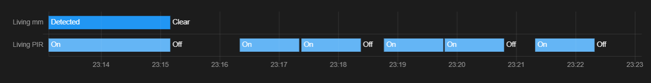

With _5841 I have yet to observe a presence stuck on event but one of my 4 FP300 is after a few hours of correctly identifying presence, now only seems to be reacting to the PIR, it feels like a loss of comms between the main micro and the mm wave silicon. At the moment I have only confirmed this with one of my four FP300.
The living room was occupied throughout this period but at 23:15 the mm wave sensor did not detect presence any more and I had to keep waving my arms to get the PIR to detect me.
The mm wave sensor only started working again after a restart of the FP300.

I’ve now had a second FP300 Zigbee, .5841) report no presence from the mm wave while the PIR reports presence. Which means the light in the room goes off and you have to wave your hands around to get it to detect you!
In the attached image the room was occupied throughout the period, with the sensor o]pointed directly at the occupant < 3 meters away.
