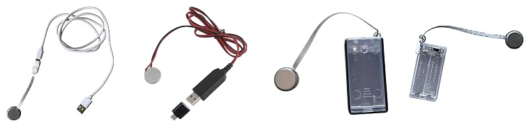

Why don’t you try searching for “CR2450 USB”? It looks like there are several solutions out there. One option, however, is a fake battery that can’t be charged but has to be plugged in all the time, and the other option is one where you can use AAA or AA batteries. In that case, you can use AAA or AA batteries with a USB port
However, since the FP300 requires two batteries, you will definitely need two of those fake batteries with cables that have to be routed out of the case. I have no idea if this will work or if it’s a good idea. Under no circumstances should you mix different solutions, though. That’s bound to go wrong. And under no circumstances should you mix regular batteries with any of these solutions.
