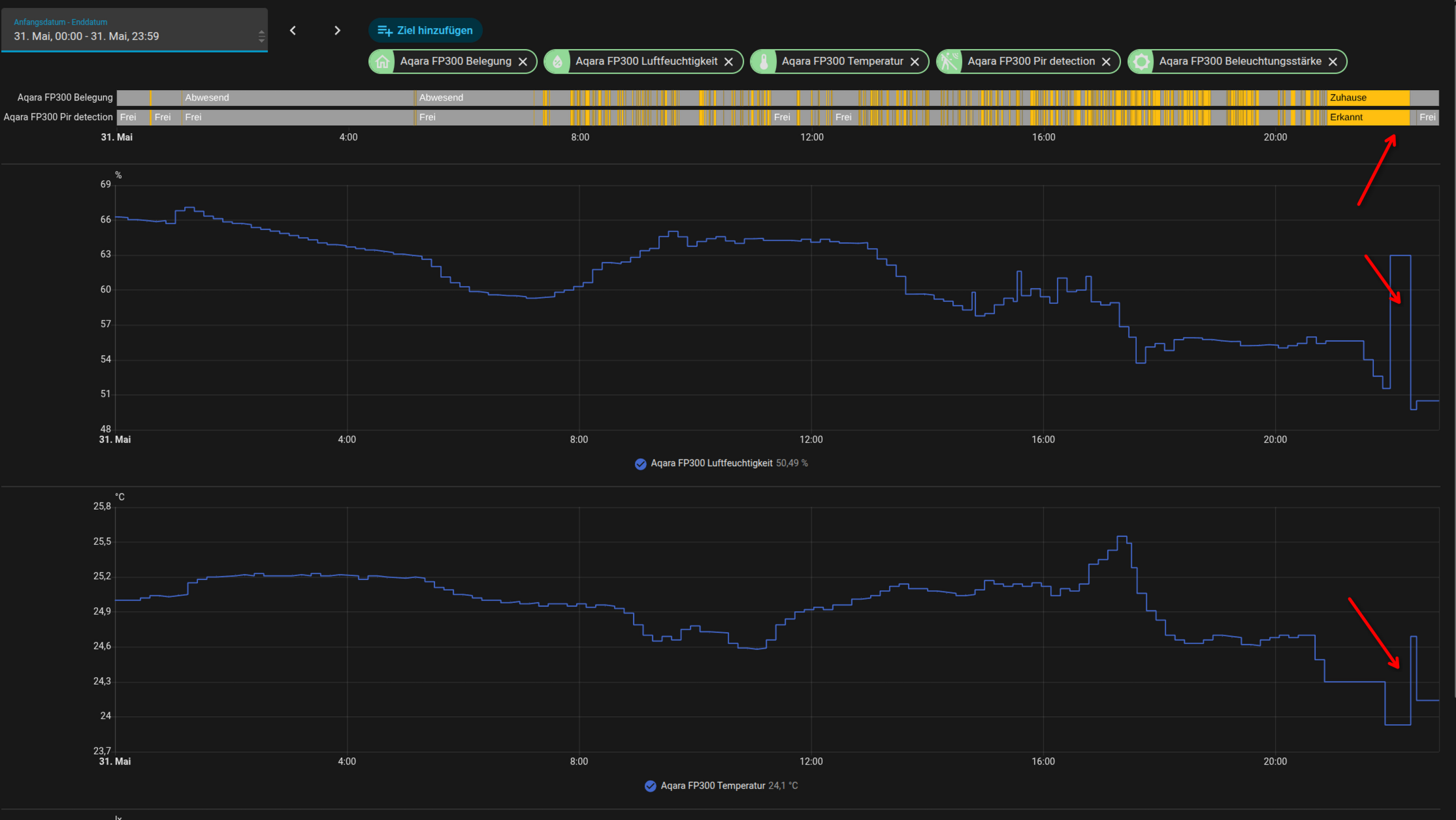

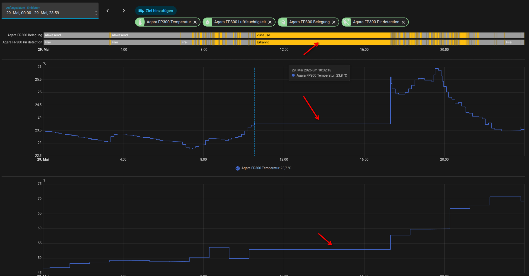

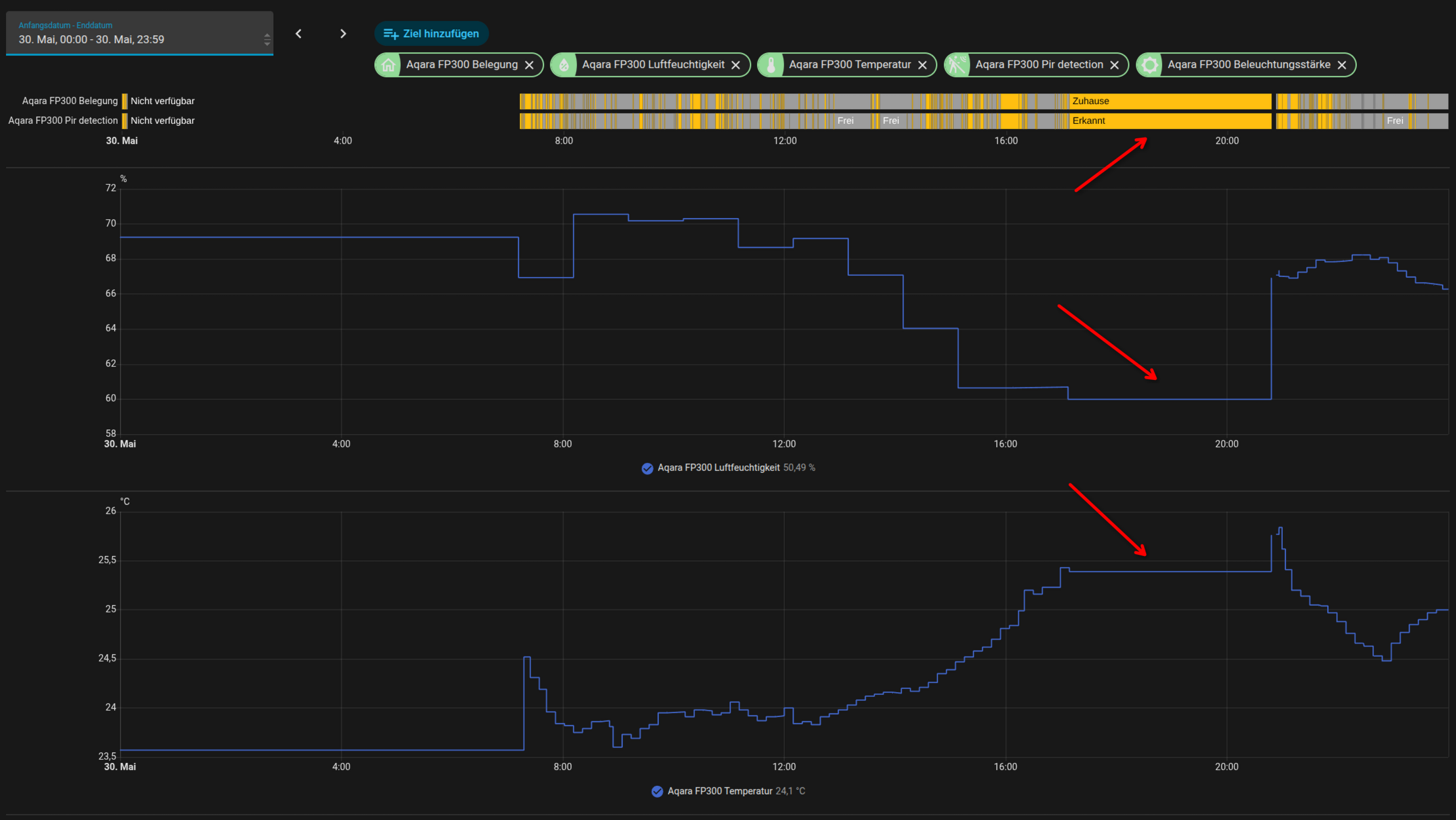

FP300 Zigbee Firmwareupdate 0.0.0_6542: PIR/Presense States not cleared after hours of runtime
I recently updated two of my five units of Aqara FP300 from Zigbee Firware 0.0.0_5841 to 0.0.0_6542.
On both units after frequently a few hours of runtime i noticed PIR/Presense States to become stuck and not getting cleared even though rooms are empty. Also temperature/humidity/brightness reporting basically become stuck or very infrequent at best.
Resetting/Repairing is required to recover from this failure state.
No addtional changes have been made. With previous Firmware 0.0.0_5841 this issue was non-present
Seeking for help. As for now i setup an automatic 8 hours reset cycle through Home Assistant hoping to mitigate the issue as otherwise the sensors are basically useless.

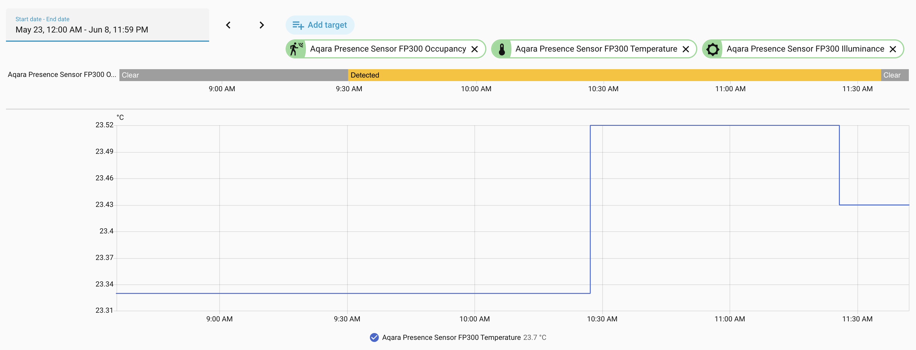

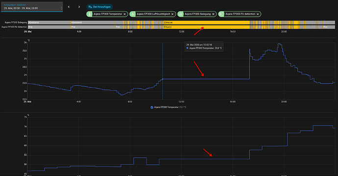

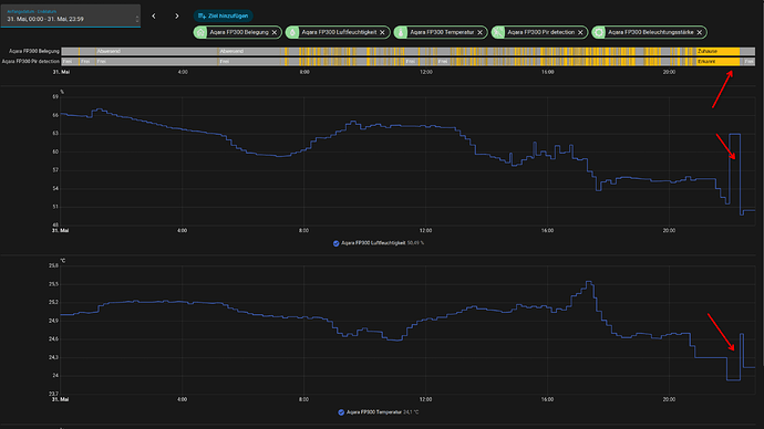

I’m experiencing a similar issue although I’m not using Z2M but HomeAssistant (Docker) + ZHA. What is different in my case, I can’t say that temperature/humidity/brightness are stuck too, only occupancy.
On the image you can see that temperature does change while occupancy doesn’t.
I use one FP300 at the moment to understand how well it works in my environment and so far I’m not that happy. The firmware is up-to-date as I installed it on May 23rd, and the Aqara app flashed the latest one that was available that day during switching the sensor to a Zigbee protocol.
The sensor is installed in a bathroom and I ensured no mirrors or moving appliances could trigger false positives, but still observe the issue a couple of times a day. I have enabled AI adaptive features and excluded some ranges to avoid false detections since the beginning, but they don’t help.
When occupancy gets stuck, I don’t touch the sensor and it self-clears in hour or two, sometimes faster (30-40 mins).
Perhaps ZHA needs to implement some workarounds too to get off of this issue.

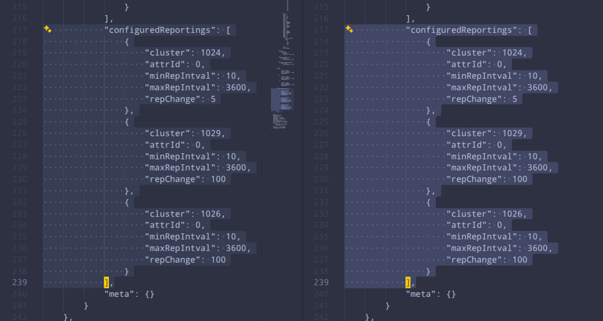

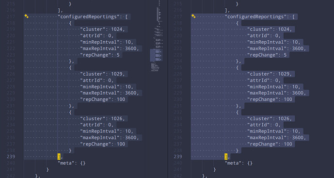

The important thing to check would be the “database.db” entry for the FP300. If the fix is really active, I would expect to see configured reporting for manufacturer cluster “0xFCC0” / “64704”, specifically attributes “322” and “333”:
{“cluster”:64704,“attrId”:322,“minRepIntval”:0,“maxRepIntval”:300,“repChange”:1,“manufacturerCode”:4447}
{“cluster”:64704,“attrId”:333,“minRepIntval”:0,“maxRepIntval”:300,“repChange”:1,“manufacturerCode”:4447}
If those entries are not there, I would still consider the system “currently behaving” rather than “definitively fixed”.
In short: great that it works now, but I would still keep an eye on it. The firmware did not remove the attributes; it seems to require explicit reporting configuration for the Aqara manufacturer-specific presence and PIR attributes now.

In regards of the z2m migration i setup an “empty” z2m instance in an lxc and restored a previous backup from pre-migration. So i’d assume, re-interviewing and corresponding reconfiguration might be triggered by that.
No i don’t think so. I just compared current Reporting configuration tp pre migration reporting configuration - looks equal to me.
