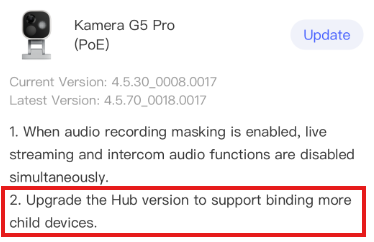

Anyone tried to use G5 Pro or G410 as the hub instead of M3 for Zigbee mode?
They are both on the latest firmware versions (4.5.30 in G5 and 4.5.20 in G410), but when I try to pair the FP400 with them, the hub responds with “Accessory not supported in this hub”.
Based on the product info on the website, both of these devices could be used as hubs.

I already have version 4.5.7 installed on my G5 Pro and G410. See if the update is offered to you, and if not, you could ask support if they can prioritize the update for you.
