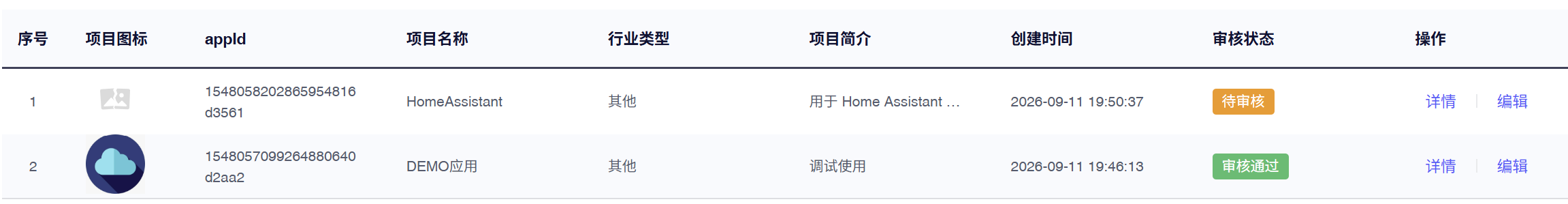

I had a project sitting in “pending review”, and every signed request returned:
HTTP 200 / code 106 / messageDetail "Illegal sign"
I checked the obvious things, all of which passed:
  • Signature reproduced byte-for-byte against the sample in the API guide
    (expected Sign bfd8dd0e7c108353e6740d81e05982d8 → matched exactly).
  • Both KeyId notations tried (with and without the “K.” prefix).
  • The same credentials sent to all six regional gateways (open-cn / open-usa / open-ger /
    open-kr / open-ru / open-sg .aqara.com) - all six returned byte-identical responses.
  • A deliberately invented AppId returns exactly the same code 106.
Then I ran a controlled comparison on the same endpoint at the same moment, changing only which
project’s credentials were used:
Project A (pending review) -> code 106 "Illegal sign"
Project B (approved)       -> code 108 "Parameter AccessToken illegal"
code 108 means the server accepted the credential set and was only waiting for an access token -
so the signature was correct all along. In my case, “Illegal sign” effectively meant “this key
belongs to a project that has not been approved yet”.

Hello and a very warm welcome to the forum.
For non-paying corporate/individual developers, only the default project is supported. As I mentioned in another post: Project approval
It’s the same for me. The access token is only valid for one hour. With the refresh token, which I think is valid for 30 days by default, you can obtain a new access token without having to go through the authentication process again.
I’m not sure right now, but I think the example in the documentation was wrong. If I remember correctly, you have to do it exactly as described, and not the way the example suggests.
