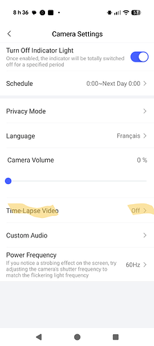

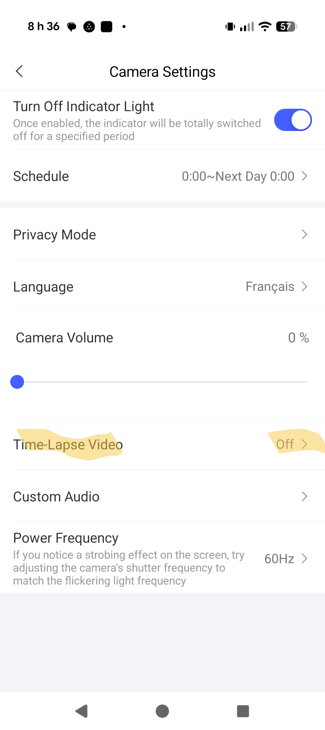

I had the same issues and found out, that it always happened at midnight to me. Exactly at that time I wanted to save my time laps video. Since I deactivated the time laps video on the camera, the issue is gone for me.
Have you activated the time laps video?
Did you update the firmware for the G100?
If change another adapter would help to solve the issue?
I’ll give that a try. I have two and I’m sure the are set the same. So weird that it only happens to one.
As far as I’m aware both devices are updated to the most recent firmware. I have changed the power adapter on the garage one and the issue has still repeated
I know it sounds a bit strange, but I had the same problem. One of my cameras kept going offline around midnight every night. I disabled the Time-Lapse Video feature on that camera, and the problem never came back!
I had exactly the same issue as you and the same solution
