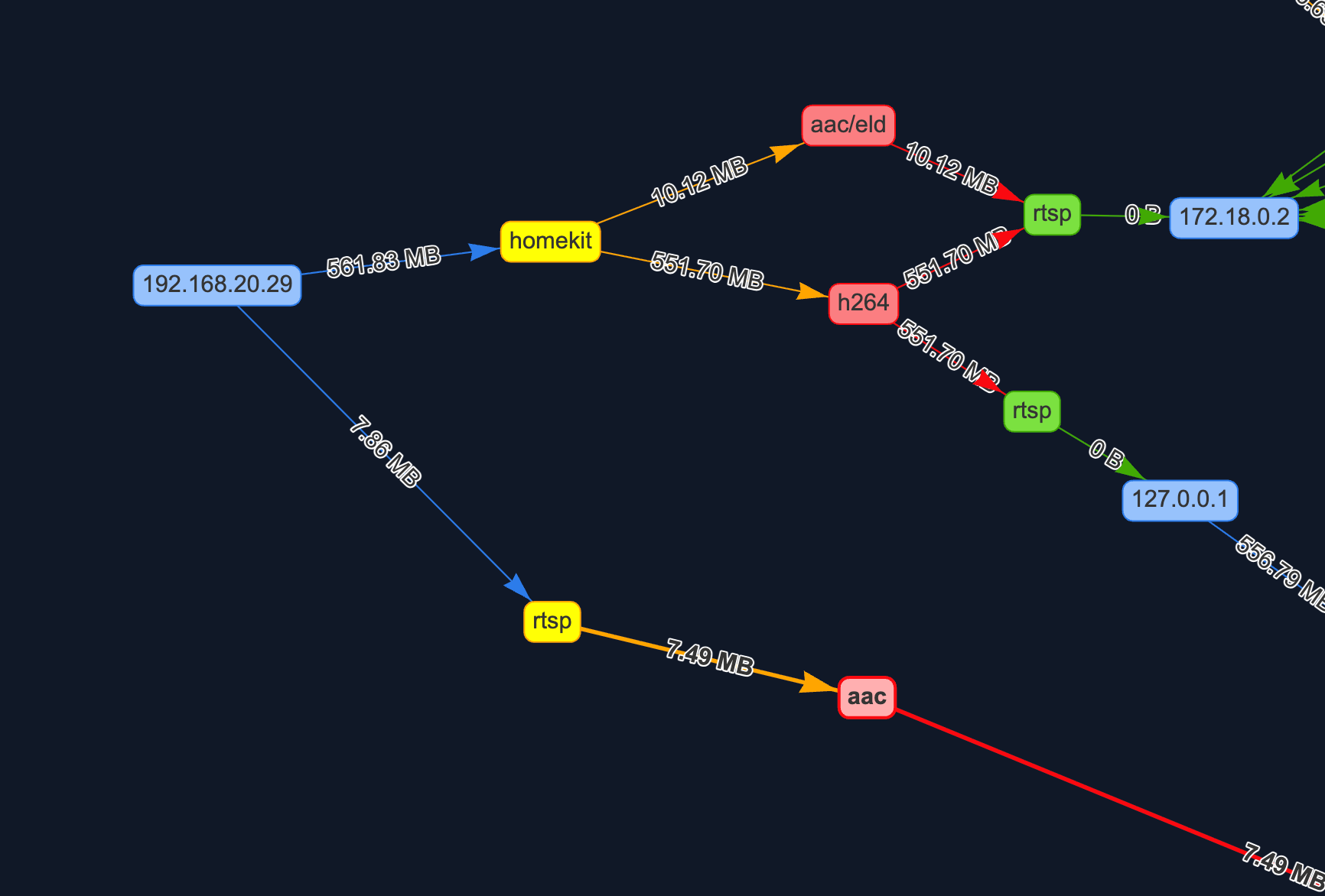

I’m having the same problem with the G410, and I think I’ve found a temporary solution.
go2rtc can accept HKSV and pass it on to a frigate.
Yeah, there’s a sound issue that hasn’t been resolved yet, but at least it works. I’m also really disappointed with the G410 and am looking for something else to replace it.
streams:
  Doorbell_Rep:
    - homekit://192.168.20.29:45457?device_id=92:xxxxxxx
  Doorbell_final:
  - rtsp://127.0.0.1:8554/Doorbell_Rep?video                     # only video from homekit
  - rtsp://user:123@192.168.20.29:8554/ch3#media=audio#backchannel=0   # only audio
