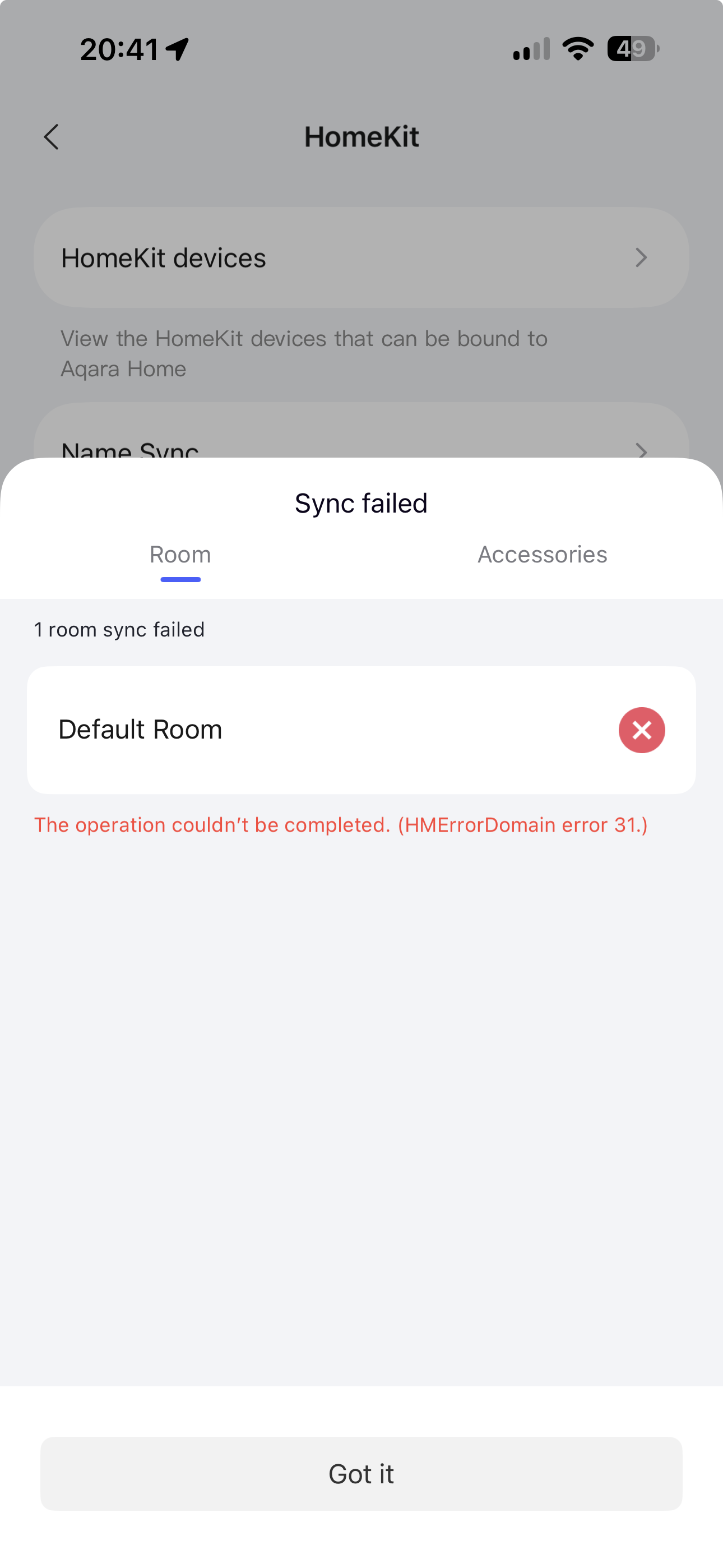

This was working up until a few days ago, and nothing has changed but my G4 doorbell and G2 H pro camera have randomly fallen off Apple HomeKit
When I try to go into synchronise, I get the error attached

Regarding Synchronization between Aqara and Apple Home
Check in the Aqara Home app and the Apple Home app:
  1. whether all devices have been assigned to a room,
  2. whether there are any empty rooms,
  3. whether there are any naming conflicts (rooms with the exact same name in both apps).

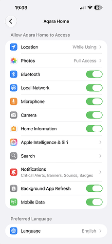

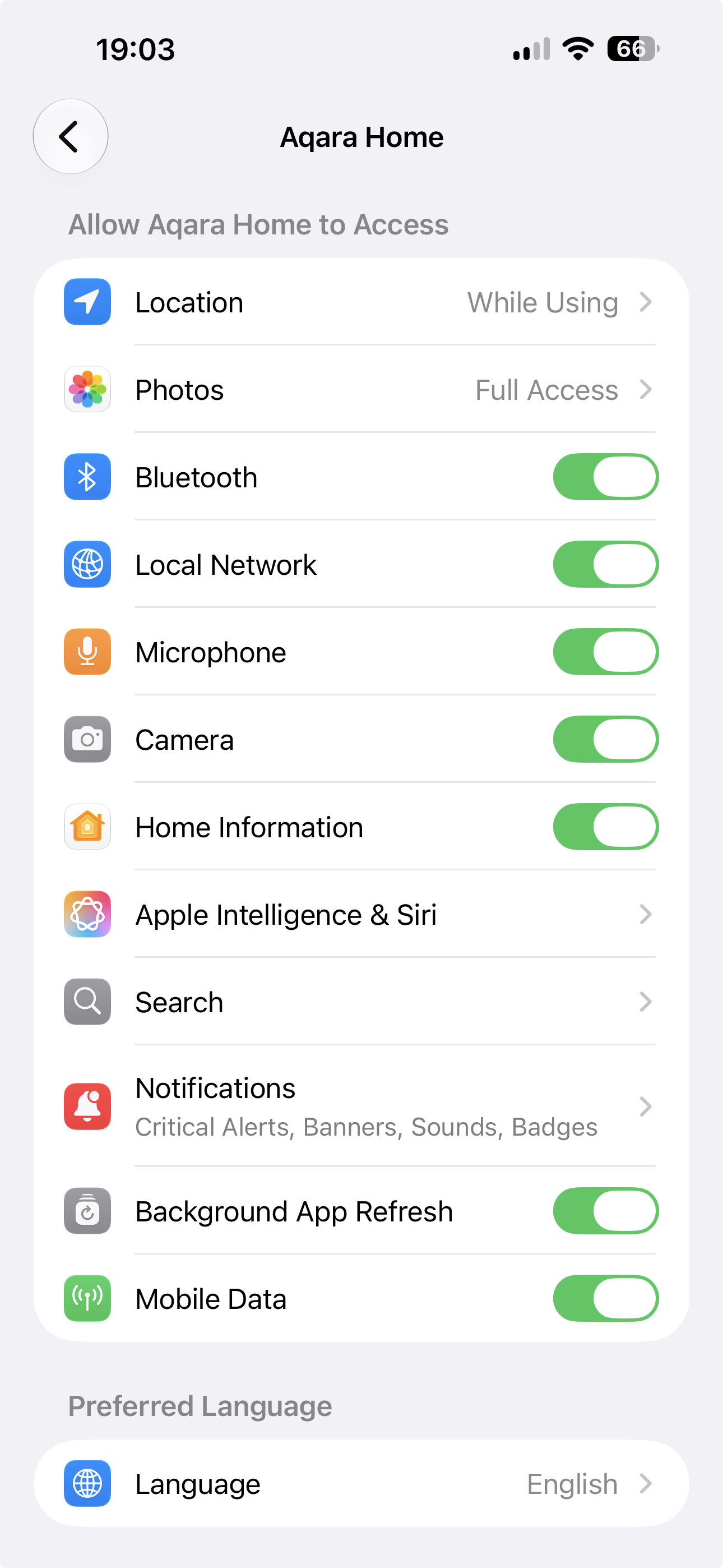

Next, check on your iPhone under Settings → Apps → Aqara Home to ensure the app is granted access to “Home Infomation”.

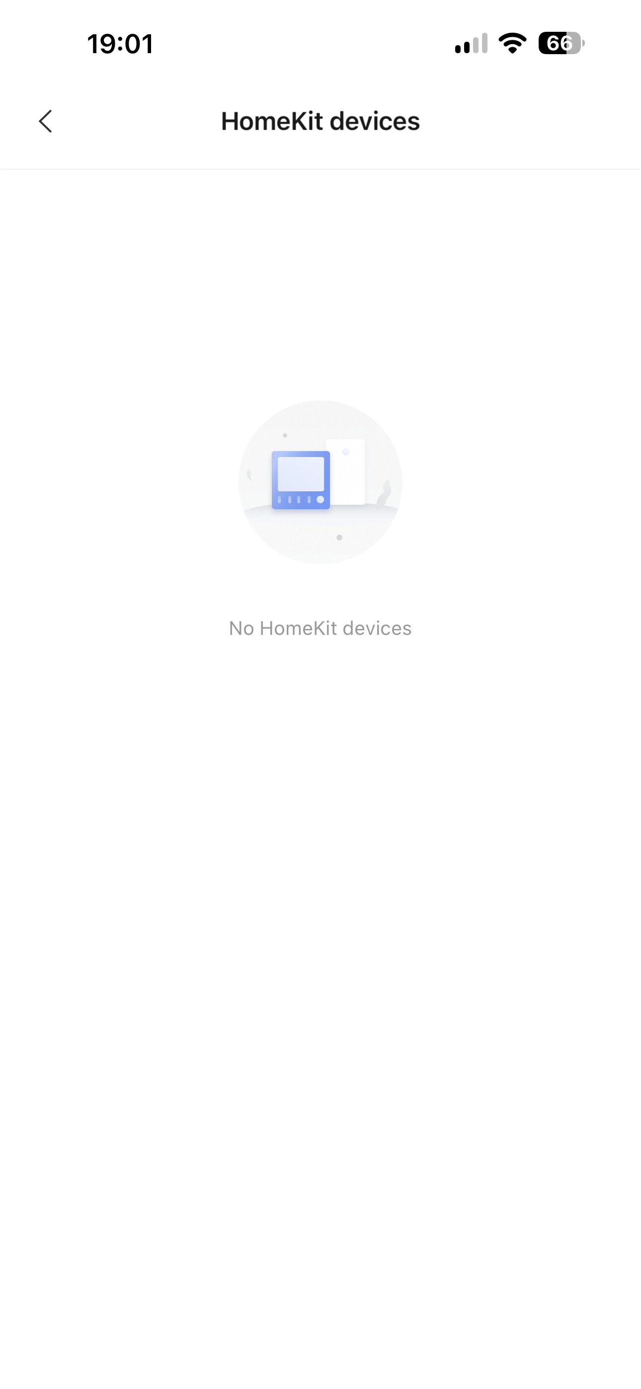

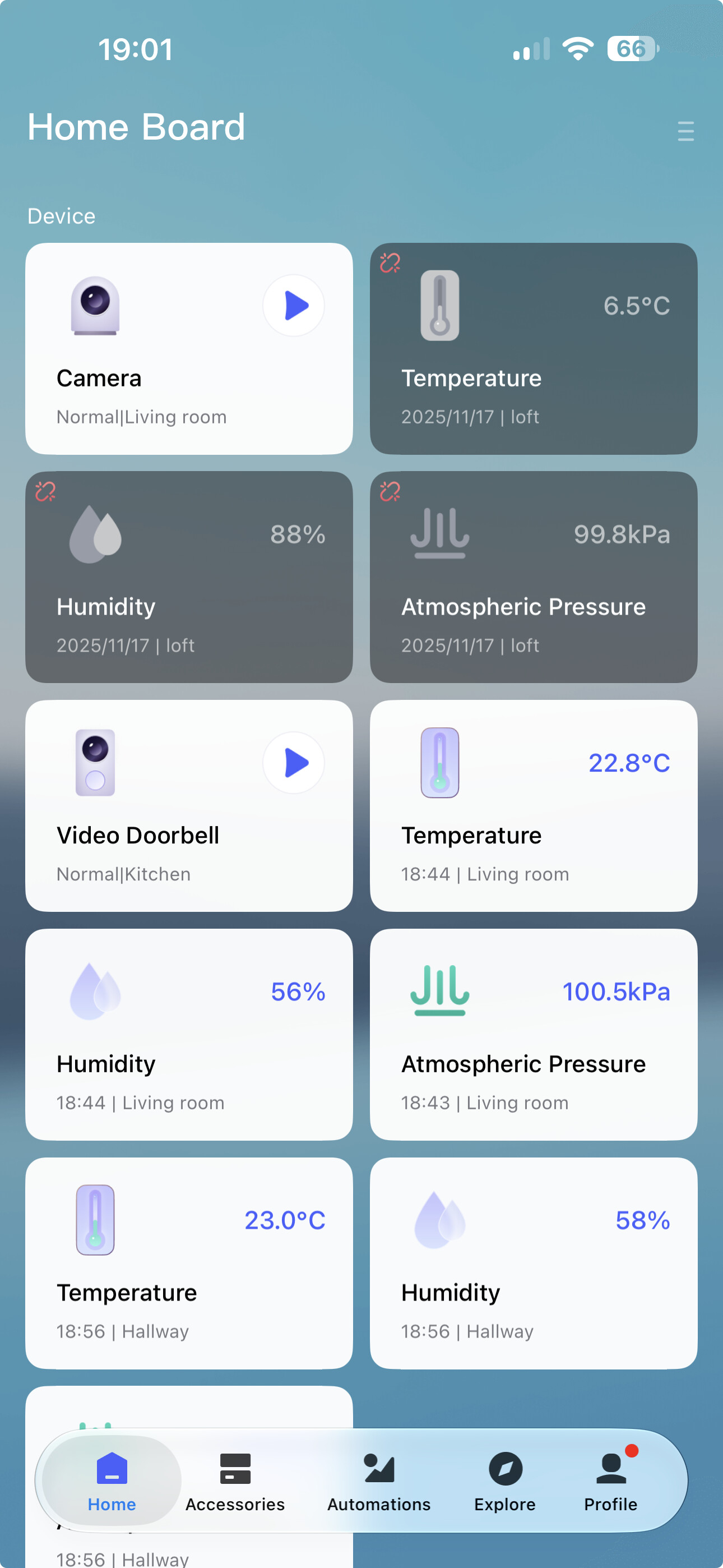

They have literally disappeared from Apple HomeKit entirely, if I go into the Aqara Settings it states that no devices are bindable
All of my temperature sensors are gone and so are the cameras

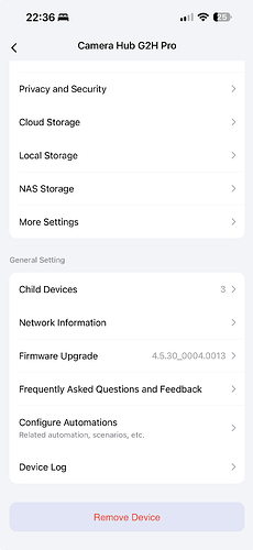

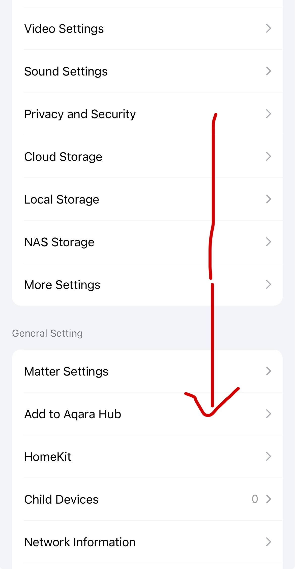

Oh, sorry, I lost track of your post here in the forum. I actually meant to reply and let you know that in the Aqara Home app under
Accessories → select Hub → three dots in the top right (Settings) → HomeKit (under General Settings) → Apple HomeKit (under Connect to HomeKit) → Add (or Remove) button
you can add Hubs (and connected devices) to Apple Home or remove them if they’re already connected.

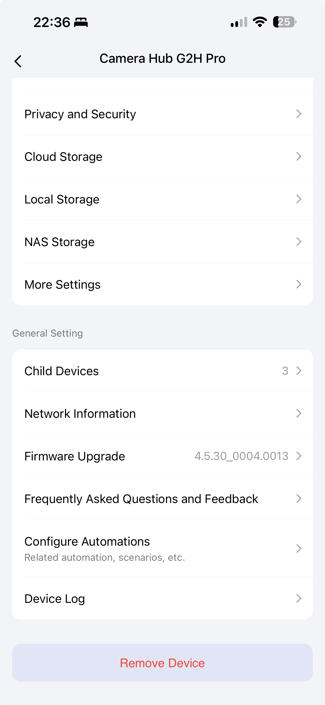

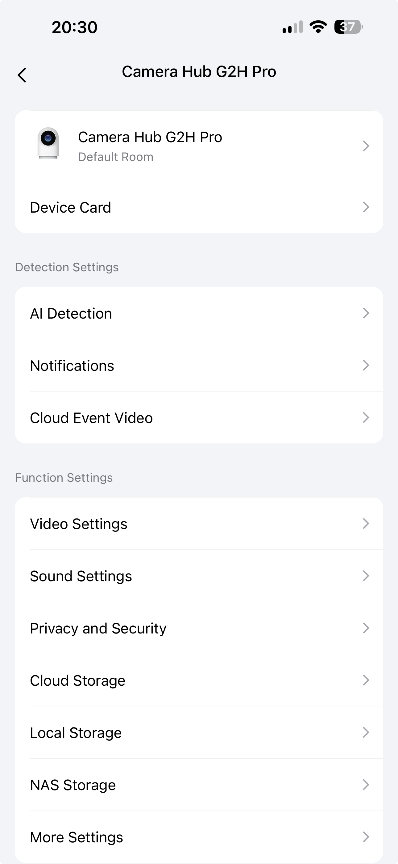

Just out of curiosity I’m trying to follow that, but I don’t see a HomeKit option
I don’t have an Aqara M2 or M3 hub to be clear, it’s a standalone G2H Pro and G4 doorbell
If you look further down, you won’t see it there either?
I do not
