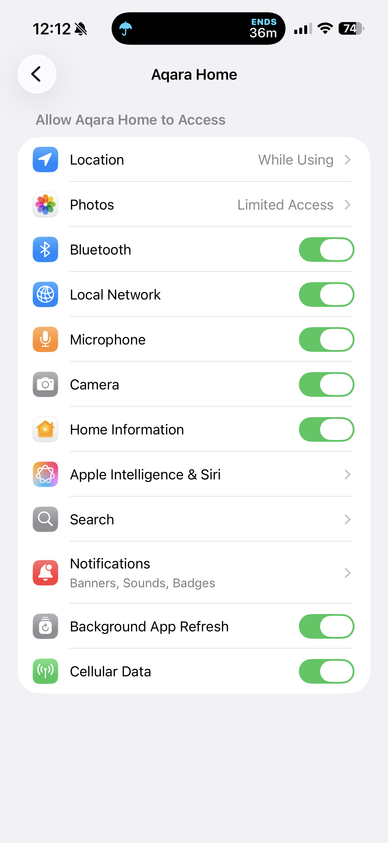

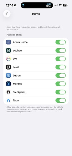

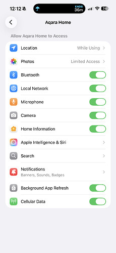

Hi Stumpy, couple quick questions.
If you go to settings app on your iPhone and check the Aqara app and Home app settings.
Do your have granted microphone, Bluetooth, camera, etc access for the Aqara app and Apple Home app?
Did you give Apple Home access to read the Aqara app data?

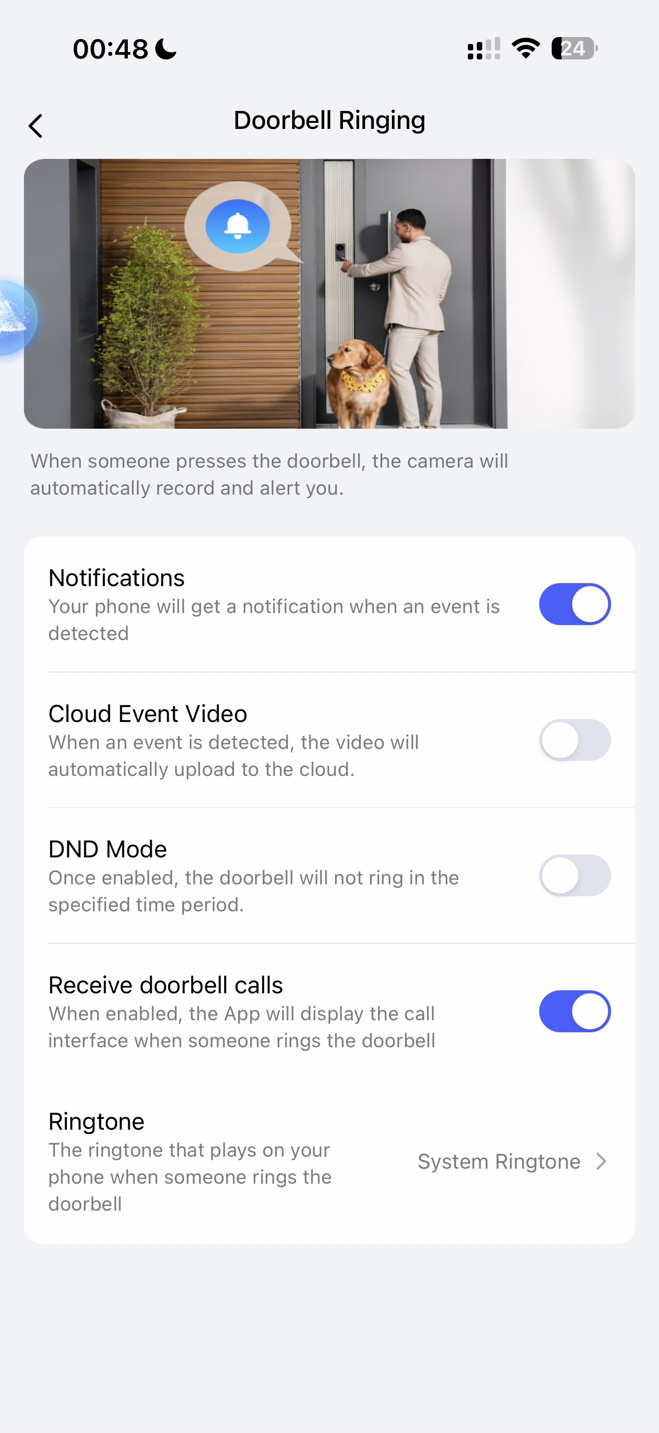

For me, the call doesn’t even connect. When someone rings the doorbell, the call simply doesn’t show up on my device at all (nothing comes through). I’ve already checked my settings and granted the app all the necessary permissions.
The weirdest part is that everything works perfectly on my wife’s device. It’s just my phone that’s having the issue.
If anyone has any idea what might be causing this, I’d really appreciate the help! Thanks in advance.
You’ve got these settings enabled?
