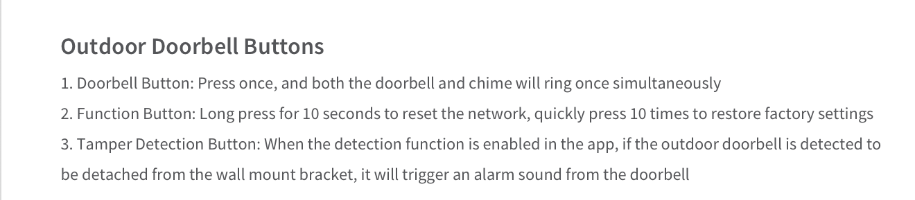

Thanks, please see Aqara manual.
To reset network, hold down function button on backside for 10 seconds.
To factory reset, press button 10x in a row.
