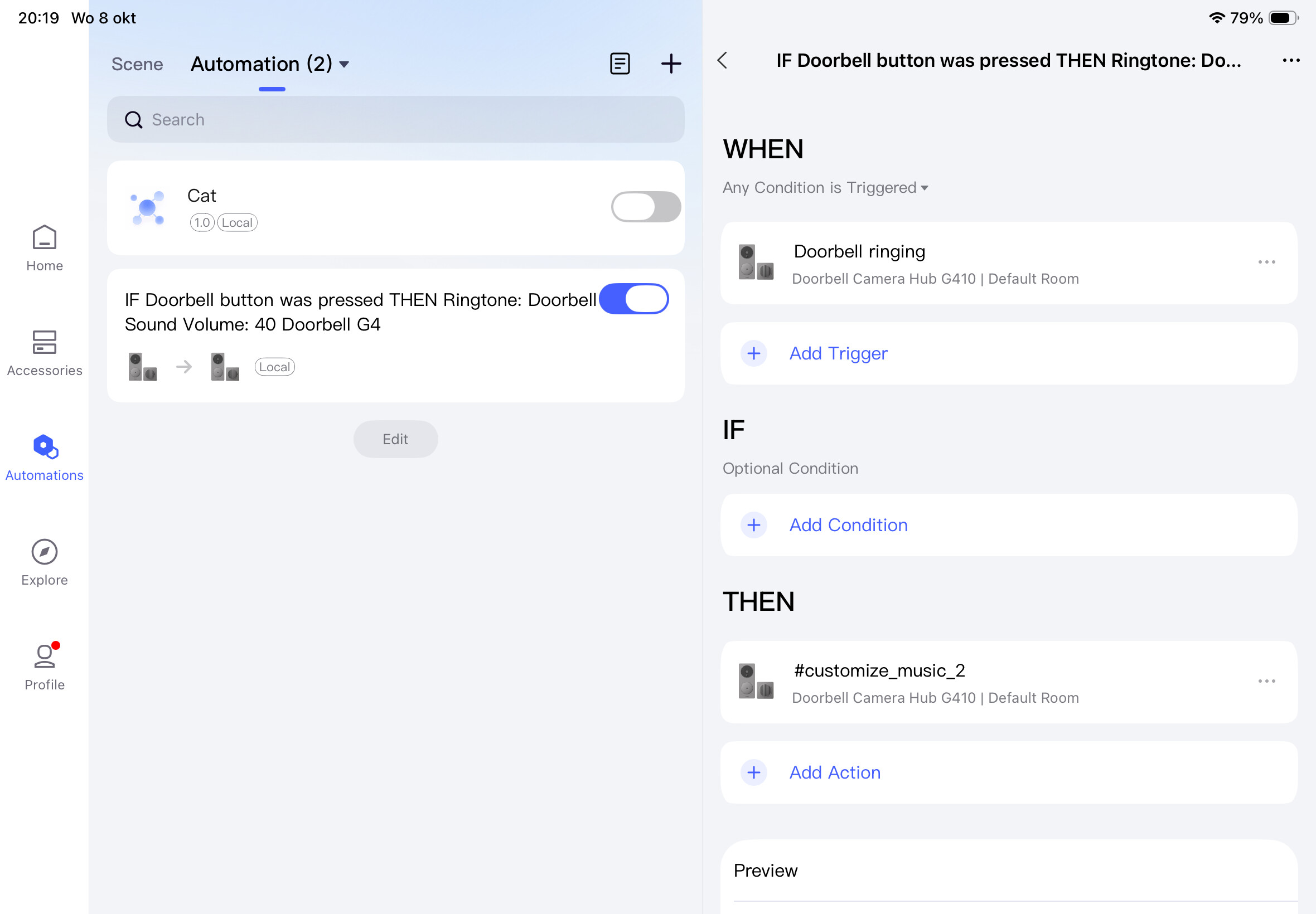

I just switched my G4 for a G410 and on my G4 I had an automation when the doorbell is pushed a sound is played on the doorbell itself (not the chime) but on my new G410 this doesn’t work, there is no sound on my doorbell. If I change this to play sound on the chime, this does work.

I got it working again, problem was iOS 26.1 pb 2, the Aqara app doesn’t work properly in this beta. Installed the g410 with iOS 26.01 and this works perfect.
