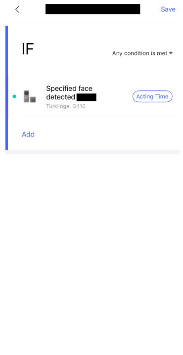

Initial Setup: I enabled face detection and added one initial photo per person. I then created a Matter signal (Profile → Connect to Ecosystems → Matter → Scene and Signal Sync → Signal Management) to trigger my HA automations.
Here’s a screenshot showing what it looked like for one person with one photo:

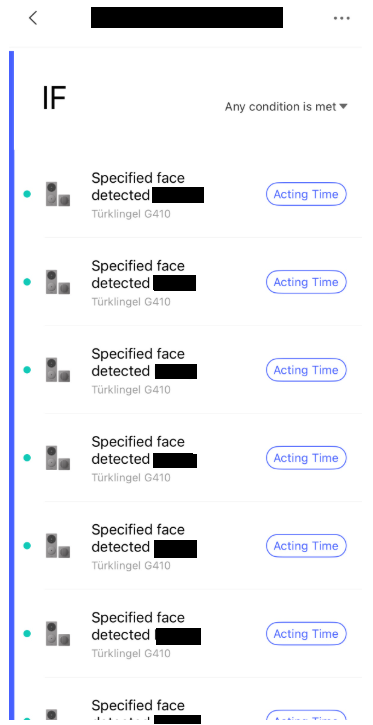

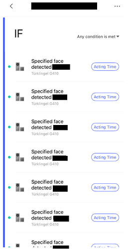

My Discovery: By pure chance, I tried recreating the Matter signal in the Aqara app. Now, when I select the condition “Specified face [Name]”, the app doesn’t just add one trigger for that person anymore. Instead, it lists multiple triggers for the exact same person—seemingly one individual trigger for every single photo I have ever assigned to their profile.
Here is a screenshot showing what it looks like now for one person with many photos:
Just to clarify: I only clicked “Add” once and added just one person. The many triggers appeared automatically afterward.

I now see this too on mine. Kind of crazy. The question is just it export as one matter signal or many?
There’s still only one Matter signal in HA, but it has a lot of triggers—probably one trigger per photo. And now it even reacts when I’m wearing a bike helmet. Probably because I later associated a photo of myself wearing a helmet with it :male_detective:
