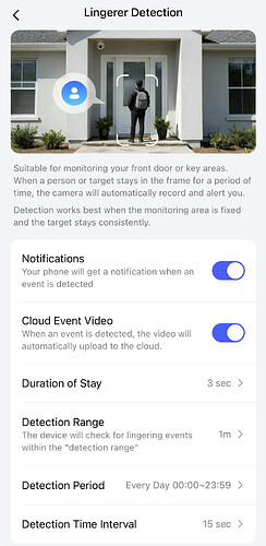

In the Aqara Home app:
You can change the Settings under:
Detection Settings → AI Detection → Lingerer Detection

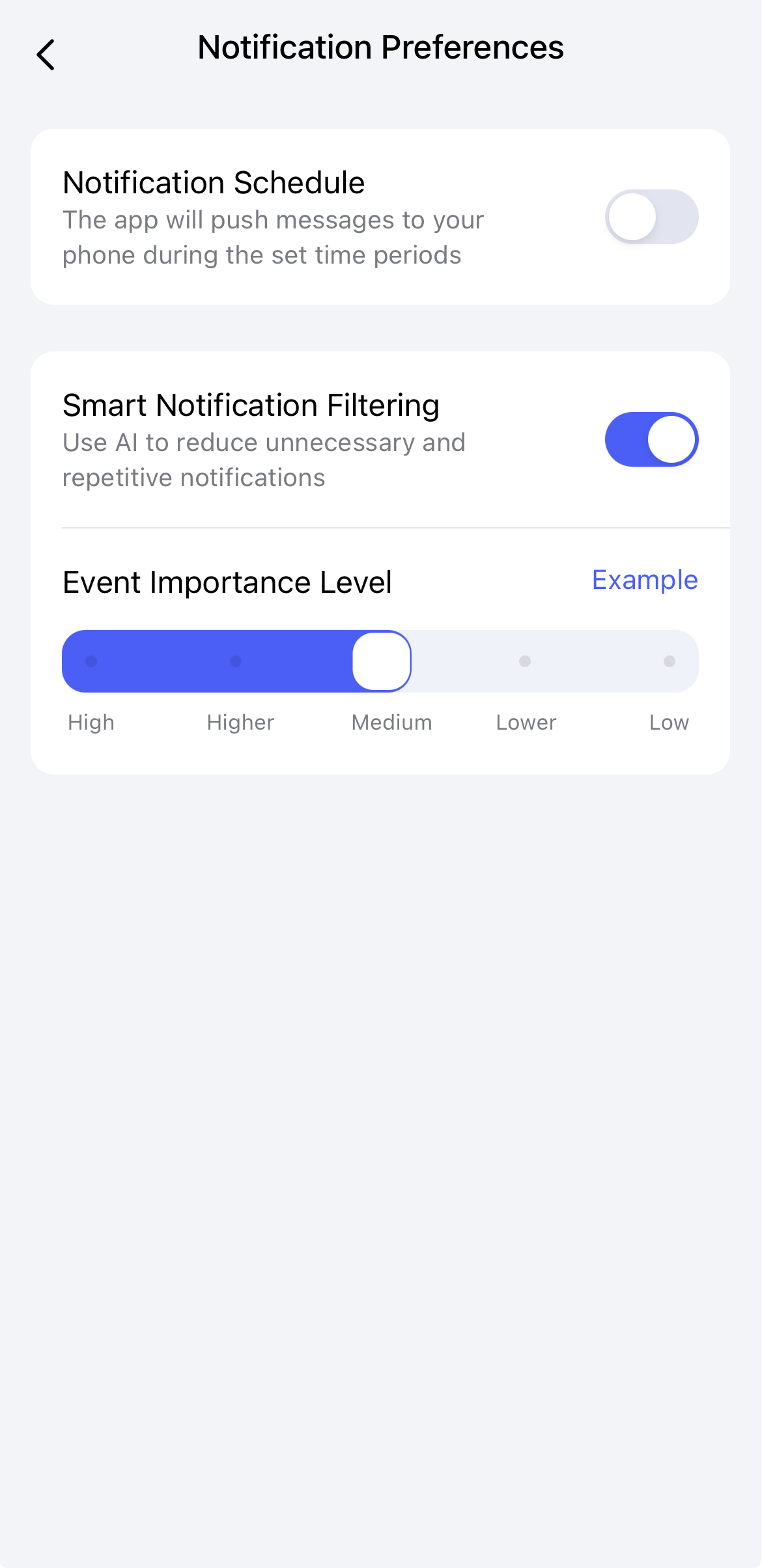

And you can reduce Notifications under:
Detection Settings → Notifications → Notification Preferences

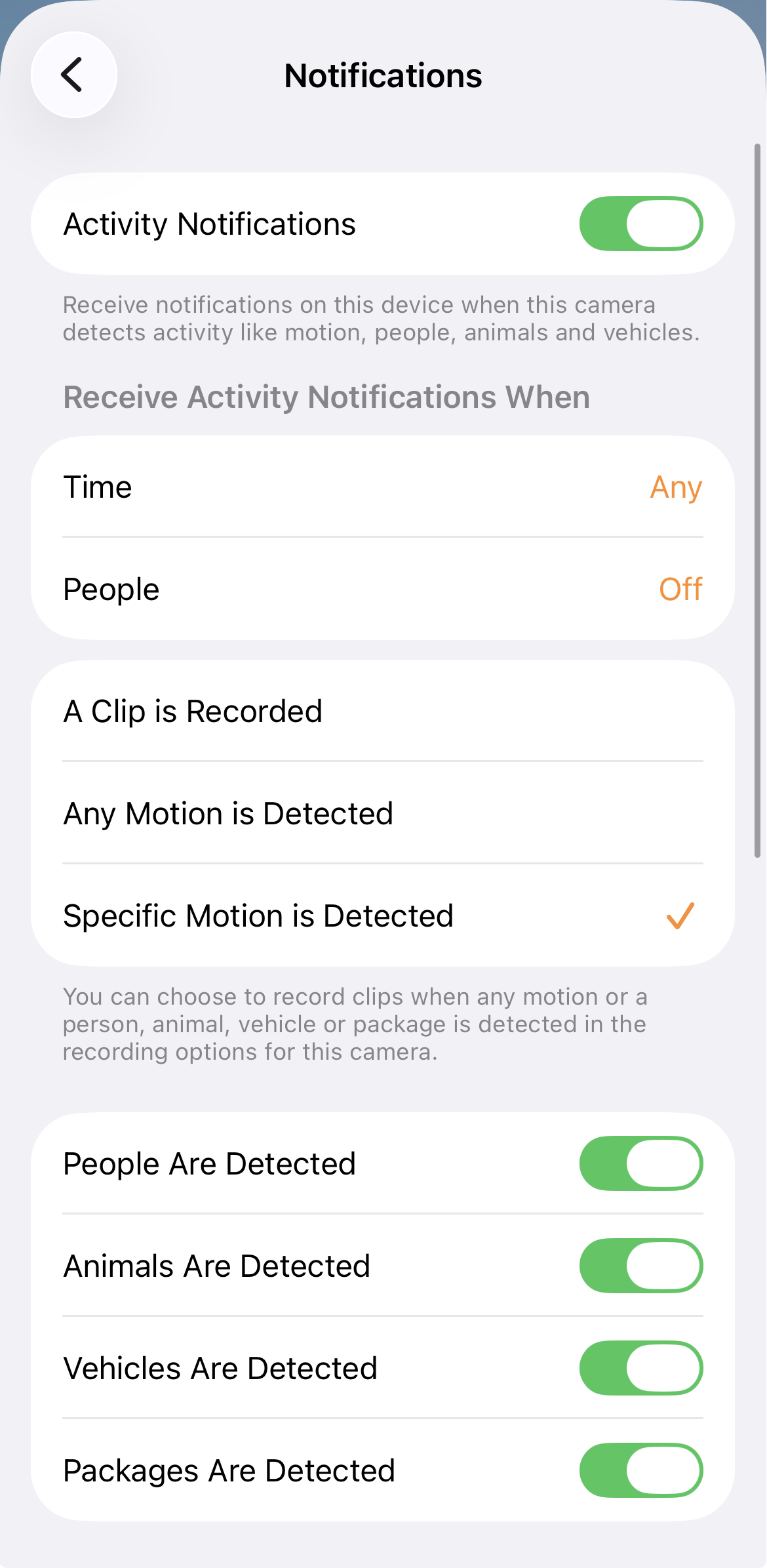

In the Apple Home app:
Home Settings → Camera & Doorbells → G410 → Notifications
Change the setting from “Any Motion is Detected” to “Specific Motion is Detected”.
