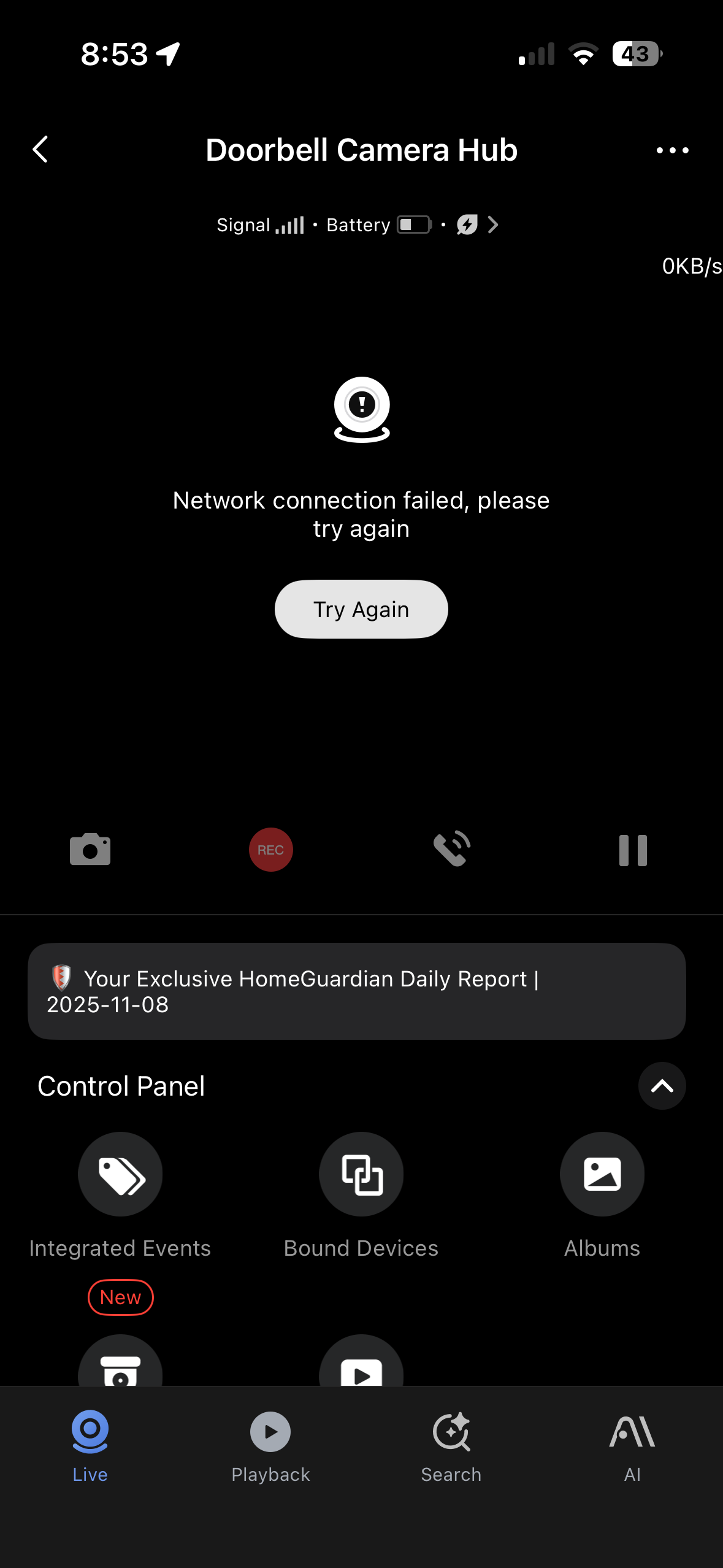

Hi, I’ve installed the G410 Doorbell a week ago, working fine until yesterday. The app keeps showing “Network connection failed, please try again” and the chime flashes red/green.
• Tried full reset, re-pairing, and reconnecting to 2.4 GHz Wi-Fi
• Firmware updated
• Installed new batteries
• Strong Wi-Fi signal (shows “Very Good”)
Still no live video feed

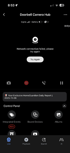

only these screens (attached).
Any fix for this?
