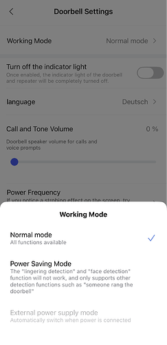

Under Settings → Doorbell Settings → Working Mode you can change the Mode to “Power Saving”:

Anyone in the community actually running 1.5V Li-Ion rechargeables through a Northeast winter on the G410? Would love to hear real-world cycle counts and whether the voltage regulation holds up over time. And @antimatterwaves, if you do end up testing a setup, Power Saving Mode is worth considering—dropping radar-based detection can stretch battery life to ~8 months with light use.
