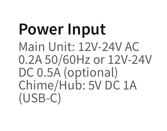

Make sure your power supply meets these specifications.
I think a 16V 30VA power supply should be suitable. When starting the infrared night vision device offline, the power problem should be ruled out. I have asked my customer service colleague to contact you to provide some necessary information to assist in investigating the cause of this problem.
