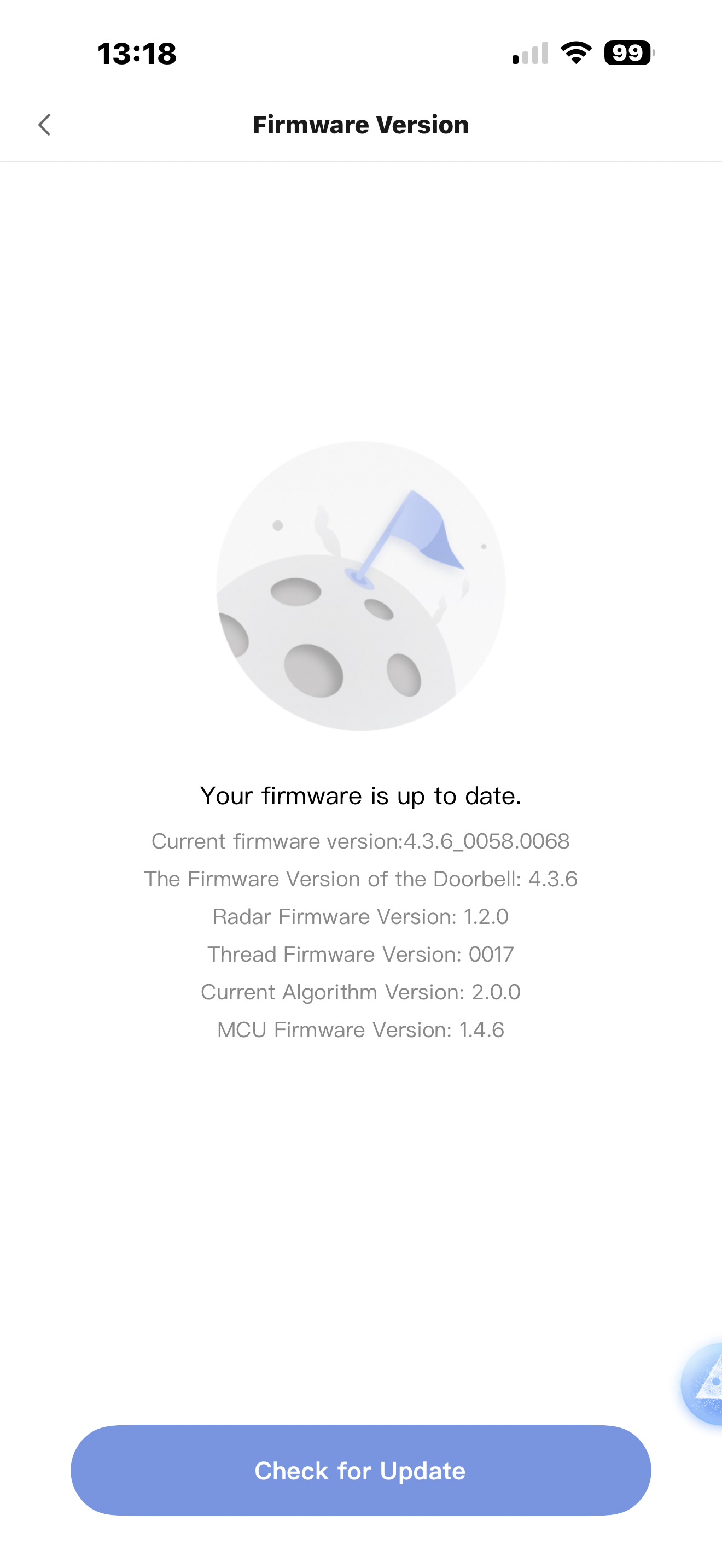

What firmware is on your G410?

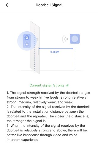

At all time signal is strong or good. DC12V 2A connected to G410 with battery as backup. So much easier then ring, with ring only AC24V then u will get the LED halo ring light up.

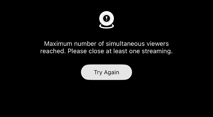

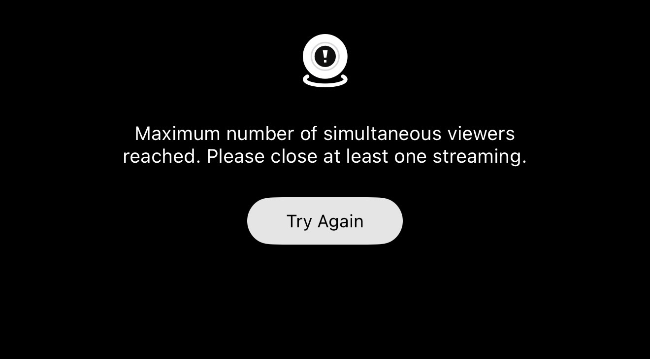

Another problem today is that u Try to connect the camera to check but keep getting below error msg
Not sure why… im the only user…

What does the signal show for the camera in the app?
Line of sight…

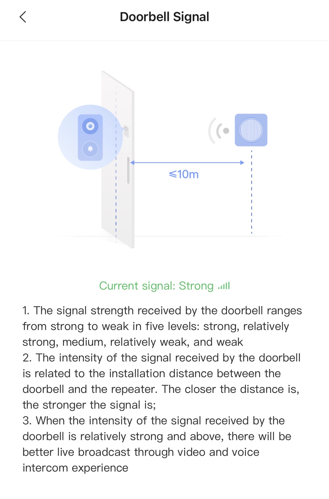

What signal strength does your network show?
