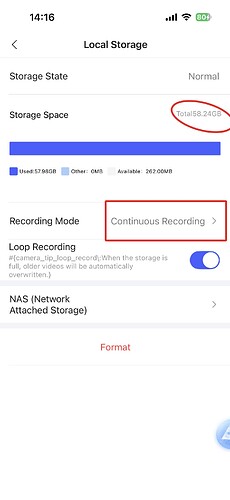

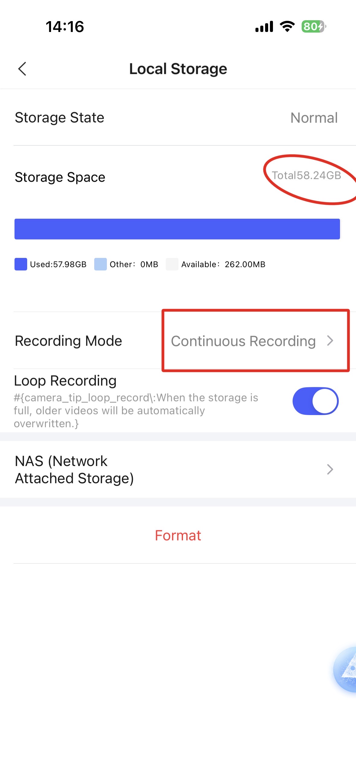

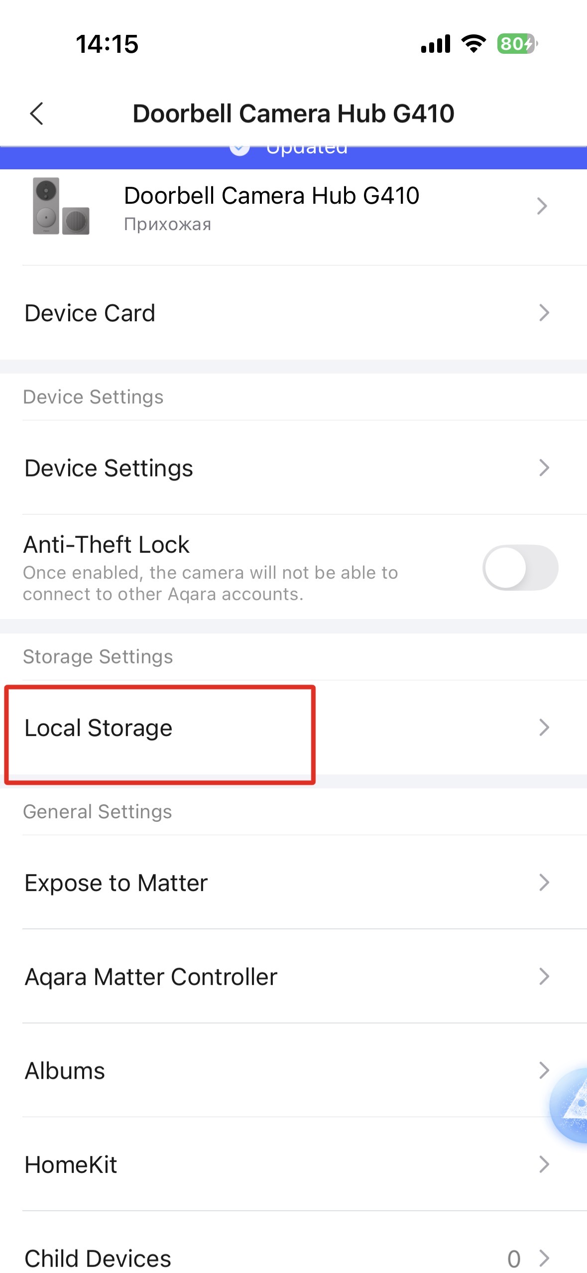

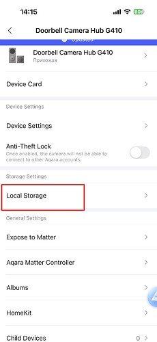

For continuous recording, 64GB is enough, when the card is full, the recordings will be overwritten if this is enabled in the settings.
In the screenshots, I indicated how to enable continuous recording on a G410.
The G410 should not have a continuous recording option in battery mode, as the doorbell will sleep to save power when no target is detected approaching. At this time, all audio and video functions (including SD card recording) will stop working, and the continuous recording option is only available when powered by an external power.
