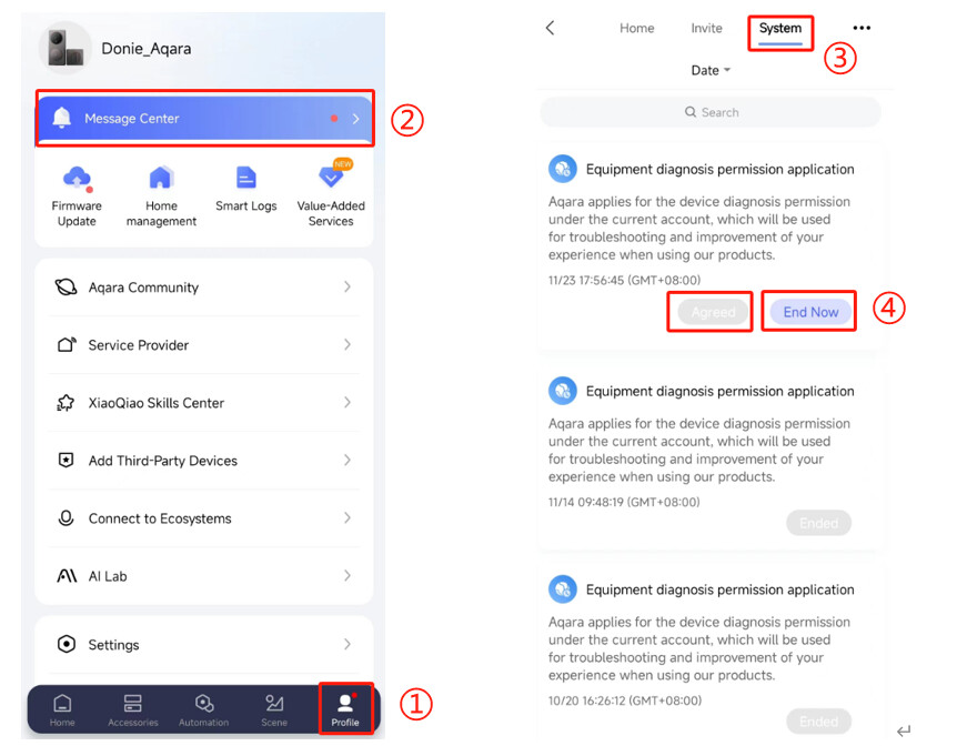

When we send remote authorization requests, please authorize them in the Aqara Home app
