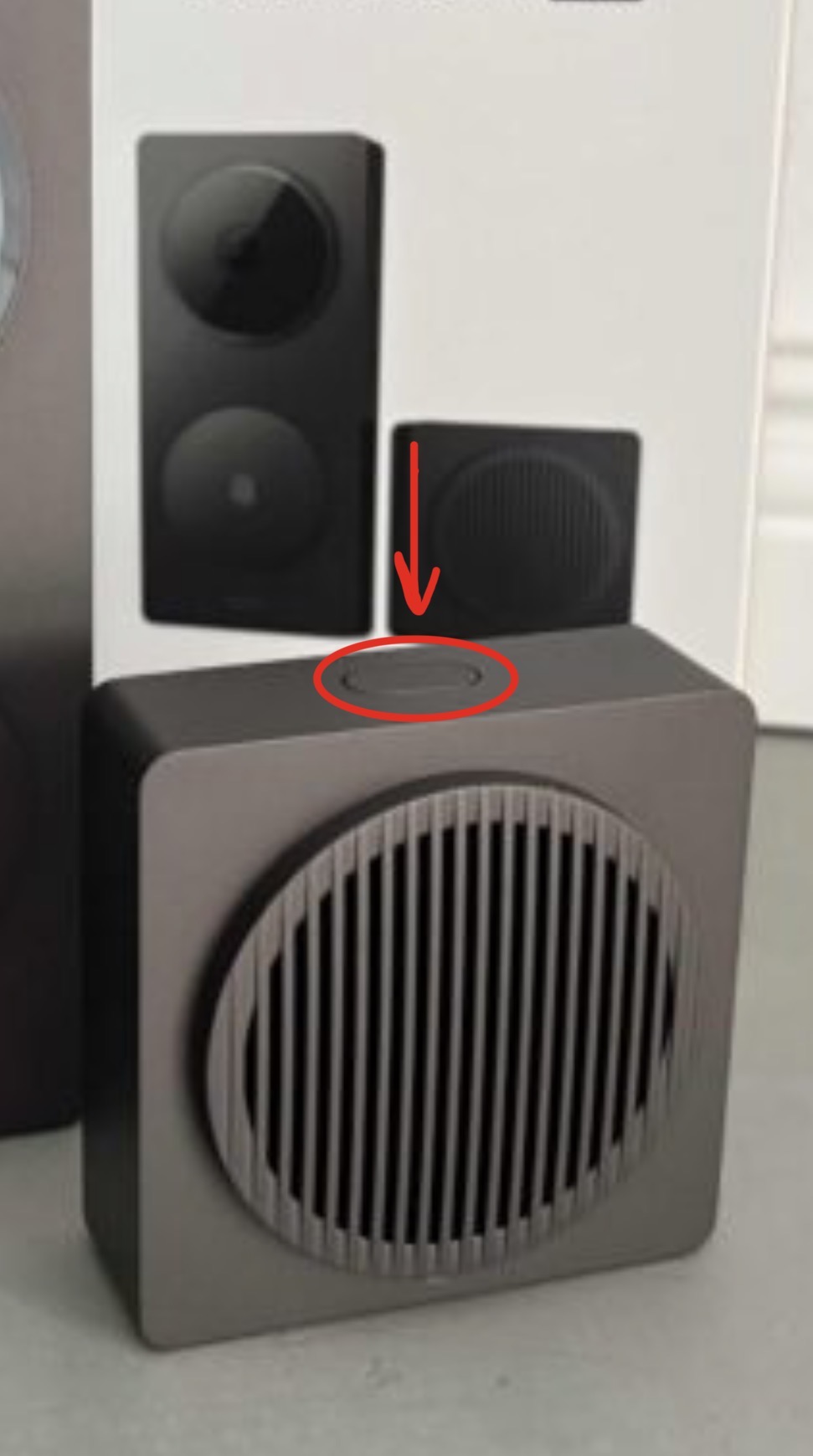

Hello @Matze89
Reset to factory settings is done as follows:
Briefly press the button on the internal module 10 times in a row.
