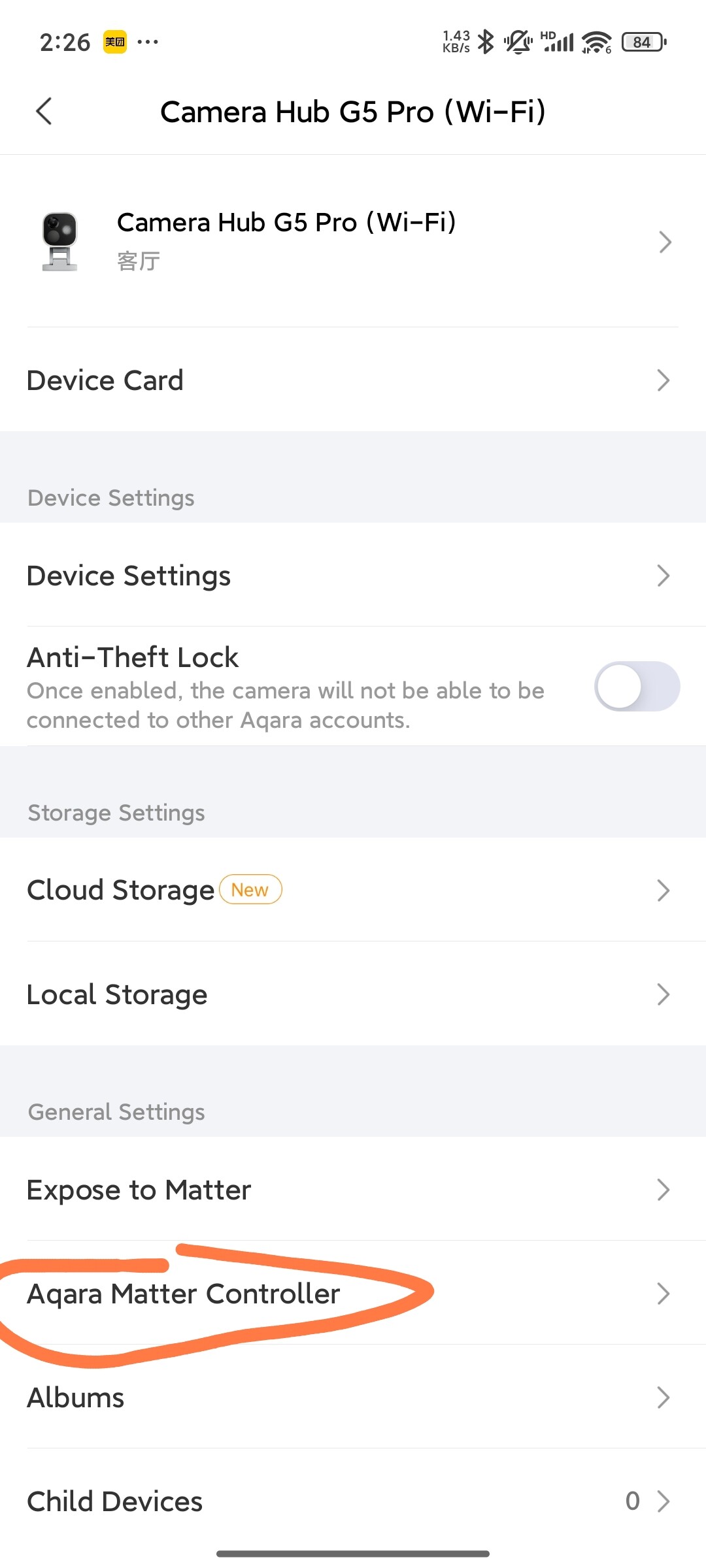

I demonstrate in the following image how to confirm that the Thread Border Router feature has been successfully enabled:
  1. Select the Aqara Matter Controller option to see which current preferred Matter Controller device is (if there are multiple Matter Controller devices in the home)
  2. When the preferred Matter Controller device is not the current device, you can choose the switch button at the bottom to select
  3. Select the current device and click ‘save’ to save it
  4. Select ‘Network Information’ to confirm whether the thread network is normal
  5. Check the Thread network information, as shown in the figure, it indicates that the Thread network has been successfully created and Thread devices can be added
