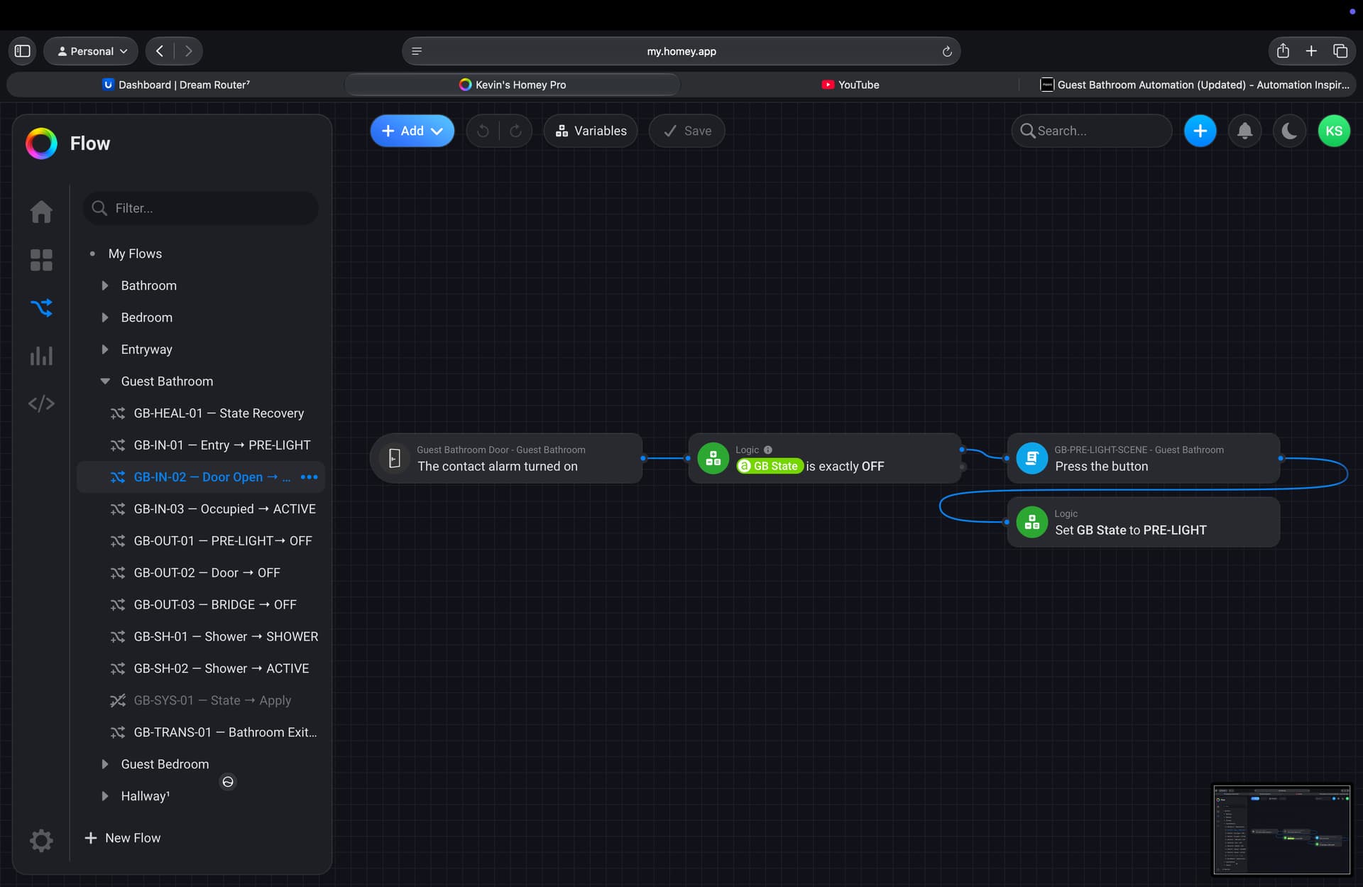

As soon as someone walks toward the bathroom, the hallway tells the bathroom:
“Someone is coming.”
The bathroom enters PRE-LIGHT and softly turns on before the person even reaches the door.
This makes the room feel much more natural than waiting for someone to step inside before the lights come on.

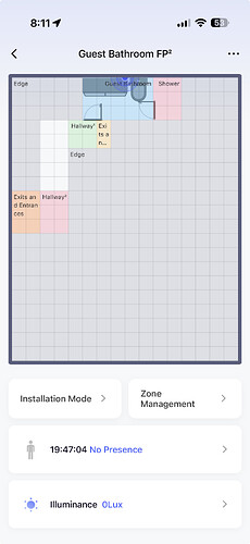

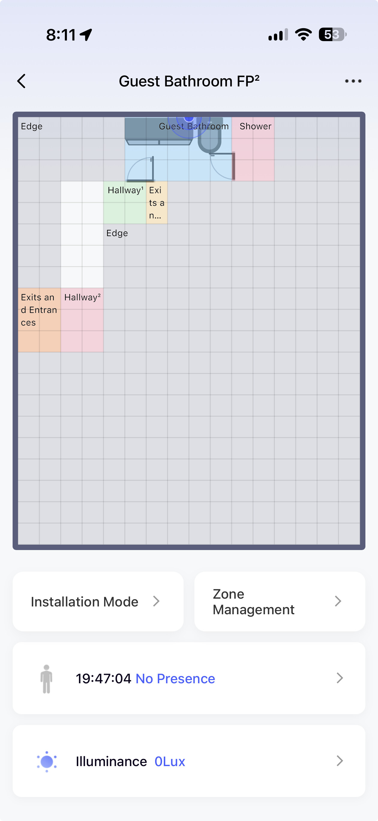

Bathroom (FP2)
The FP2 handles everything that happens inside the bathroom.
I divided it into two zones:
  • Bathroom Zone
  • Shower Zone
The Bathroom Zone tells the automation that someone is using the room normally.
The Shower Zone tells the automation someone is showering, which is treated differently because people don’t move much in the shower.

Walking Into the Bathroom
You walk down the hallway.
:arrow_right: The FP300 detects you.
The bathroom enters PRE-LIGHT and turns on a soft light.

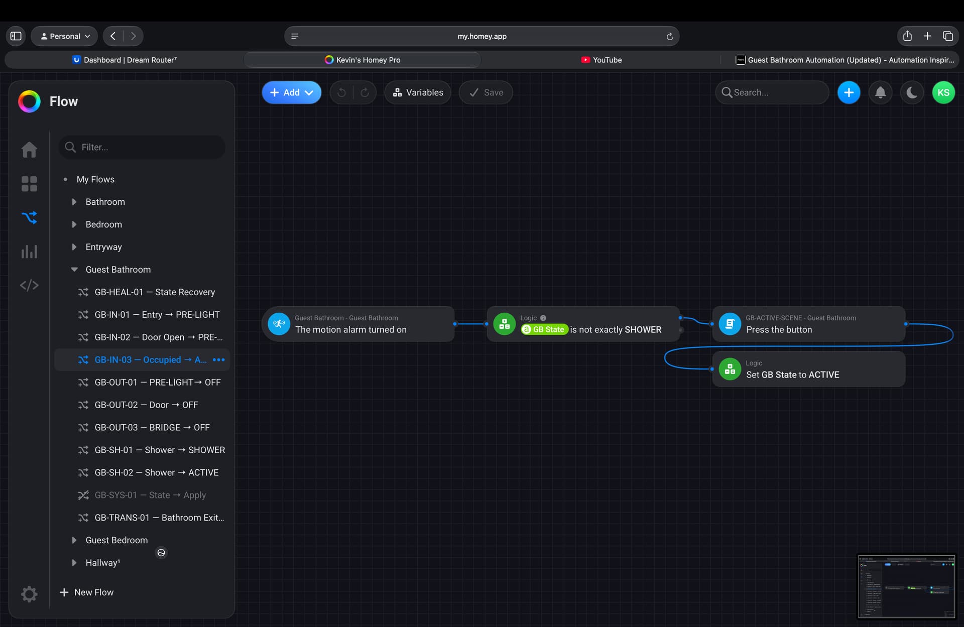

:arrow_right: The FP2 Bathroom Zone detects you.
The bathroom changes to ACTIVE .

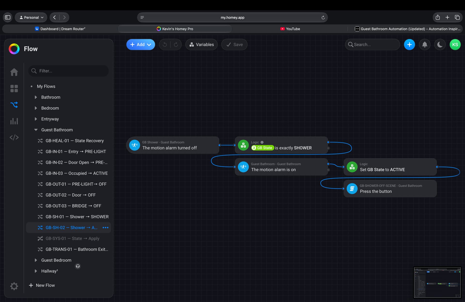

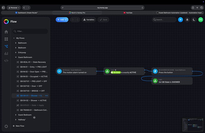

If you step into the shower…
:arrow_right: The FP2 Shower Zone becomes occupied.
The bathroom changes to SHOWER .
Because SHOWER is a protected state, the lights won’t accidentally turn off if the sensor briefly loses you while you’re standing still or behind the shower curtain.

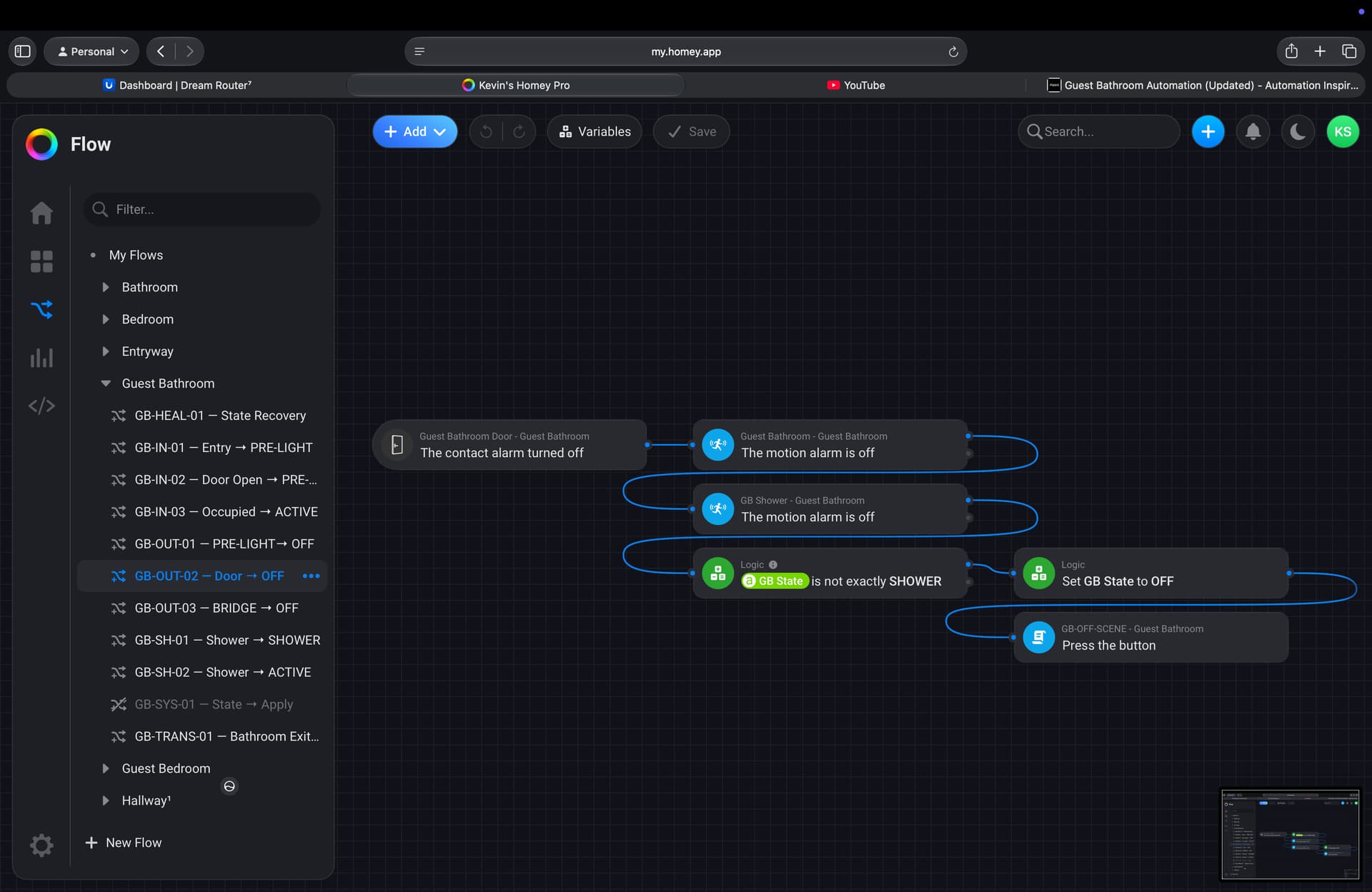

Walking Out
This is where the BRIDGE state comes in.
When you leave the bathroom, the FP2 no longer sees you, but you’re still physically in the doorway and entering the hallway.
Instead of immediately turning everything off, the bathroom enters BRIDGE .
During this brief transition, the hallway takes over.

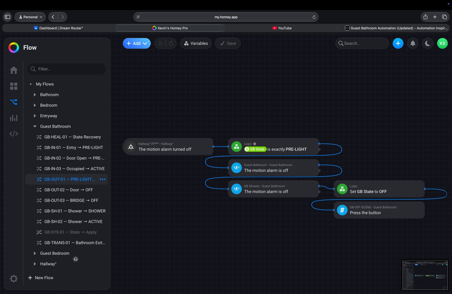

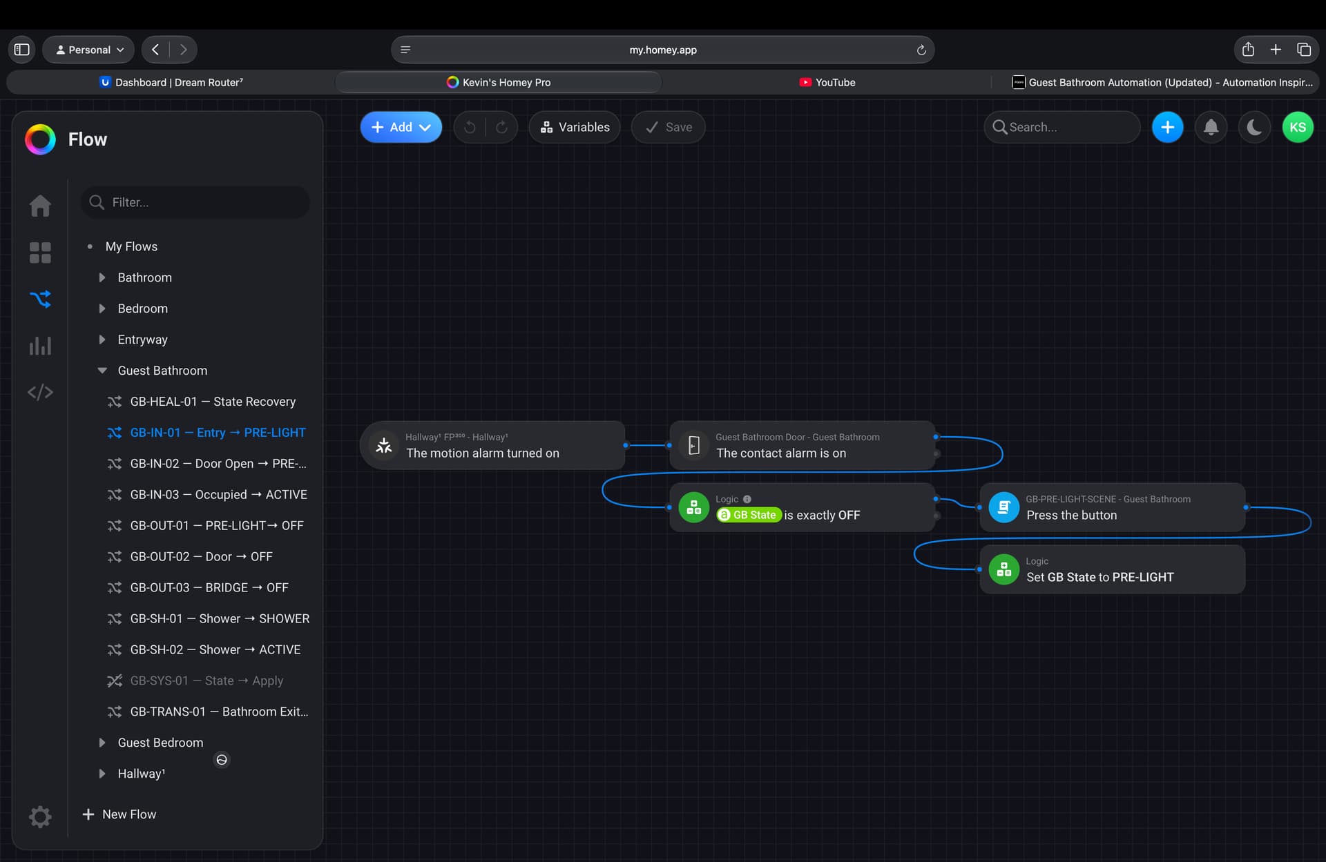

The FP300 sees you enter the hallway and activates the Hallway¹ automation.
Once you’re fully out of the bathroom and the transition is complete, the bathroom finally changes from:
ACTIVE → BRIDGE → OFF
This handoff prevents the hallway and bathroom from fighting over the lights while you’re standing in the doorway.

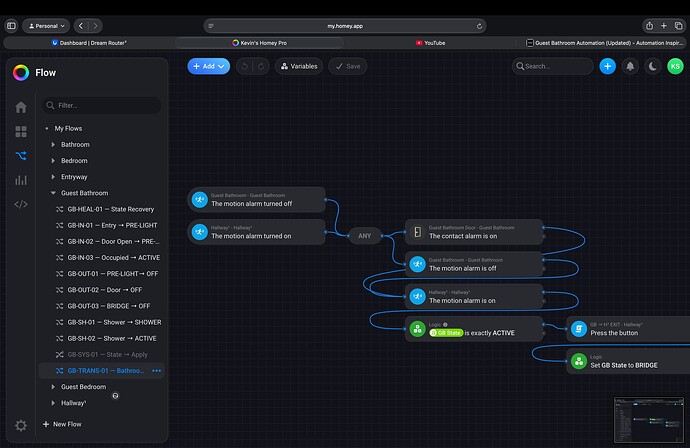

But I am curious, where did you build these automations. Can you share screenshots of some of the logic? I’m particularly interested in the “protected state” of the shower zone.
I split the responsibilities between three platforms so each one does what it does best.
  • Homey Pro is the brain. It processes sensor events, manages the room states, and runs all of the automation logic.
  • Home Assistant is responsible for lighting. It stores and activates all of my lighting scenes, transitions, and adaptive lighting.
  • Apple Home is what my family uses every day. It provides Siri voice control, the Home app, and manual control of devices.

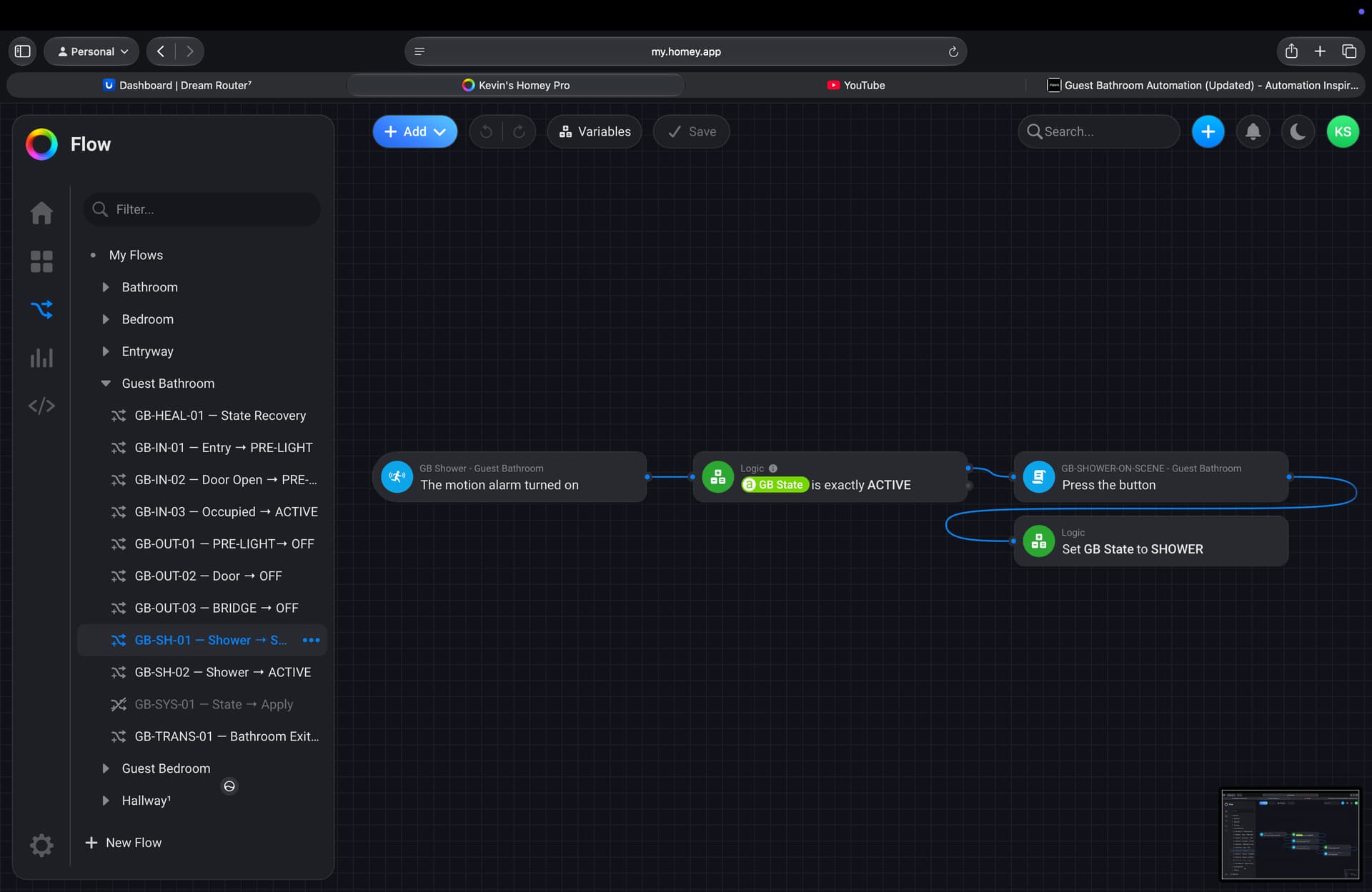

One of the most important parts of the automation is the SHOWER state.

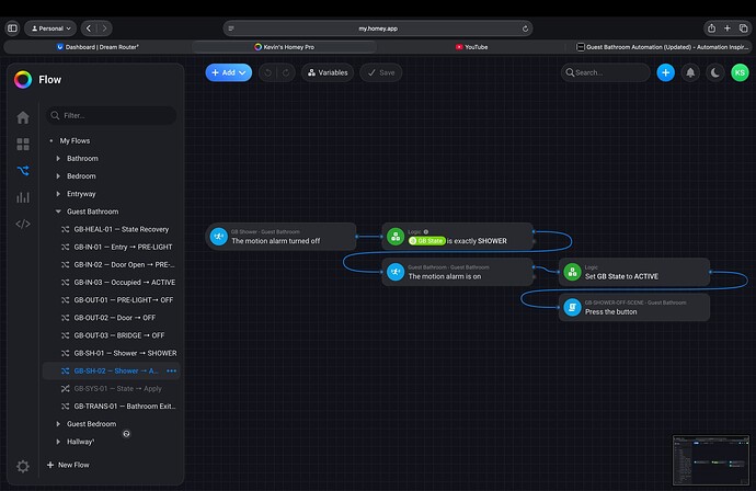

When the FP2 detects someone in the shower, the bathroom enters the SHOWER state. While in this state, it ignores normal occupancy changes from the Bathroom Zone. This means someone can walk into or out of the bathroom without causing the lights to change or turn off.
The bathroom will remain in SHOWER until the shower is no longer occupied. Only then will it return to ACTIVE , and eventually OFF once the room is vacant.
