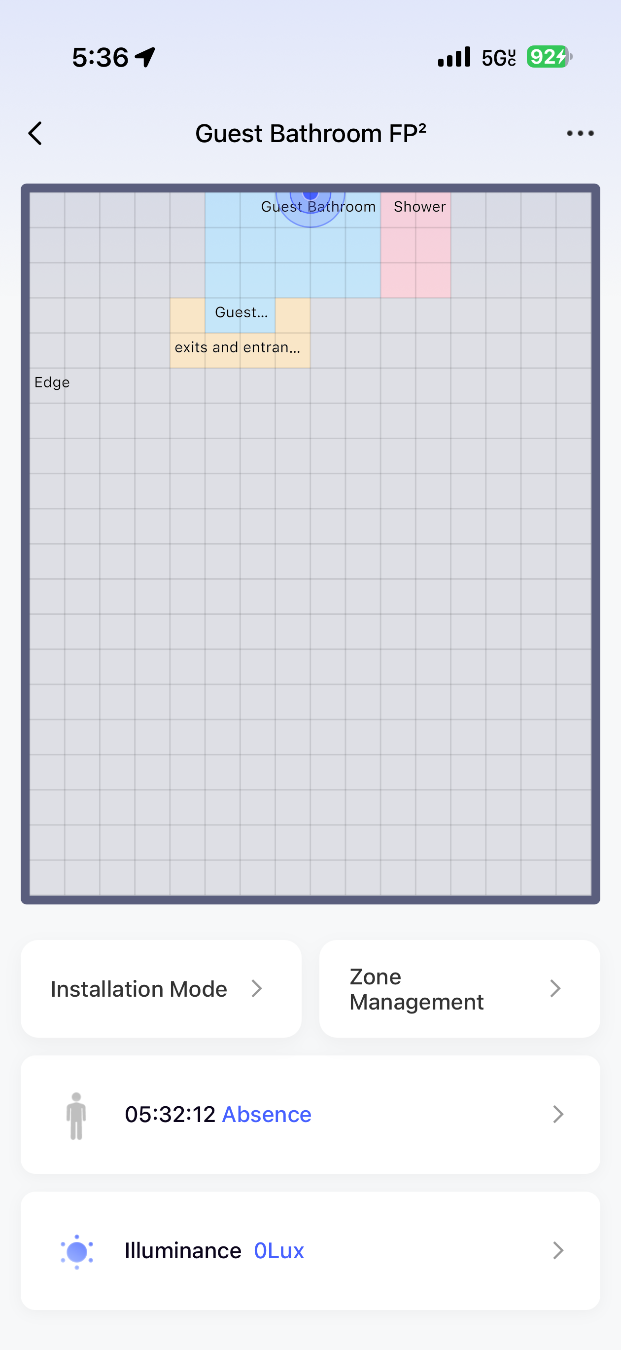

Guest Bathroom Automation
Homey Pro is the best, in my humble opinion, automation platform.
I tinkered til it couldn’t fail anymore but occasionally due to it being in the bathroom, the shower steam messes with the FP2 sensor from time to time. I would say it runs correctly damn near 100% on entry but maybe 93% on exit.
I have multiple around my house but just one in the bathroom. Currently, I have 3 zones. Entrance, Guest bathroom & Shower zone. The entrance zone lights it up to 20% on approach. Once inside it dims to 100%. Back to 20% when leaving. Then off.
