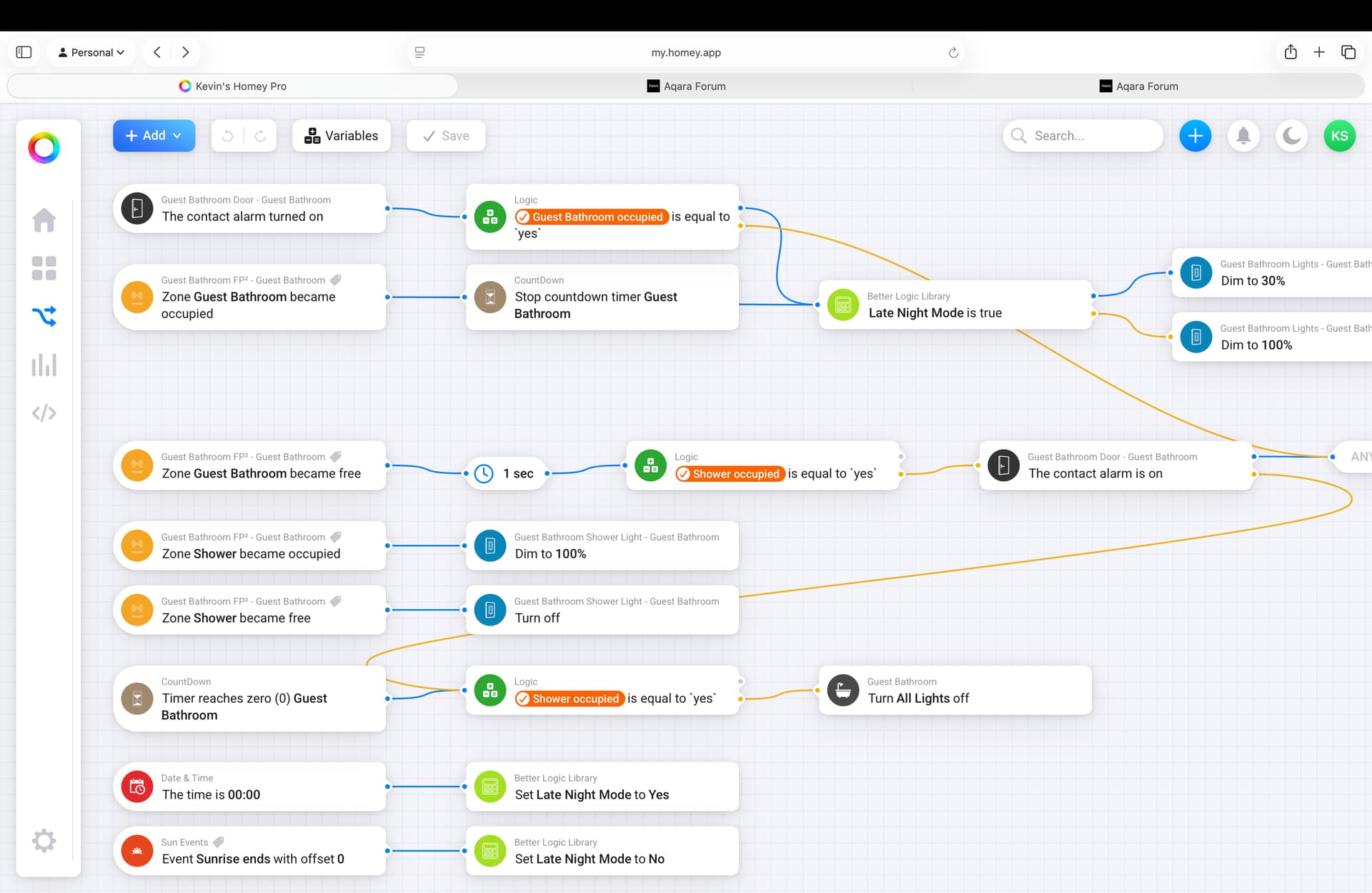

In this automation, I’m utilizing a Homey Pro Advanced Flow as the automation engine. I’ve integrated an Aqara Door & Window Sensor and an Aqara FP2 Occupancy Sensor. Additionally, I’ve using Lutron dimmer switches. This practical automation is suitable for all family members (Spouse Approved). I believe it offers the equivalent functionality of a high-end luxury system, such as Control 4, RadioRA 3, or HomeWorks, at a significantly lower cost. Also offers energy savings.
:one:
Door Opens → Pre-light + Timer Start
Trigger:
  • Contact alarm turned on
Flow:
  • Check Guest Bathroom occupied = yes
  • Late Night Mode branch:
    • If true → dim to 30%
    • If false → dim to 100%
Then:
  • ANY condition leads to::heavy_check_mark: Dim to 20% :heavy_check_mark: Start 20 sec timer
Result:
Perfect — this gives the “entry dim” effect and starts your countdown.
:two:
FP2 Detects Occupancy → Stop Timer + Full Brightness
Trigger:
  • FP2 “Zone Guest Bathroom became occupied”
Flow:
  • Stop countdown
  • Late Night mode true → dim to 30%
  • Otherwise → dim to 100%
Result:
This prevents the room from going dark while someone is inside.
:three:

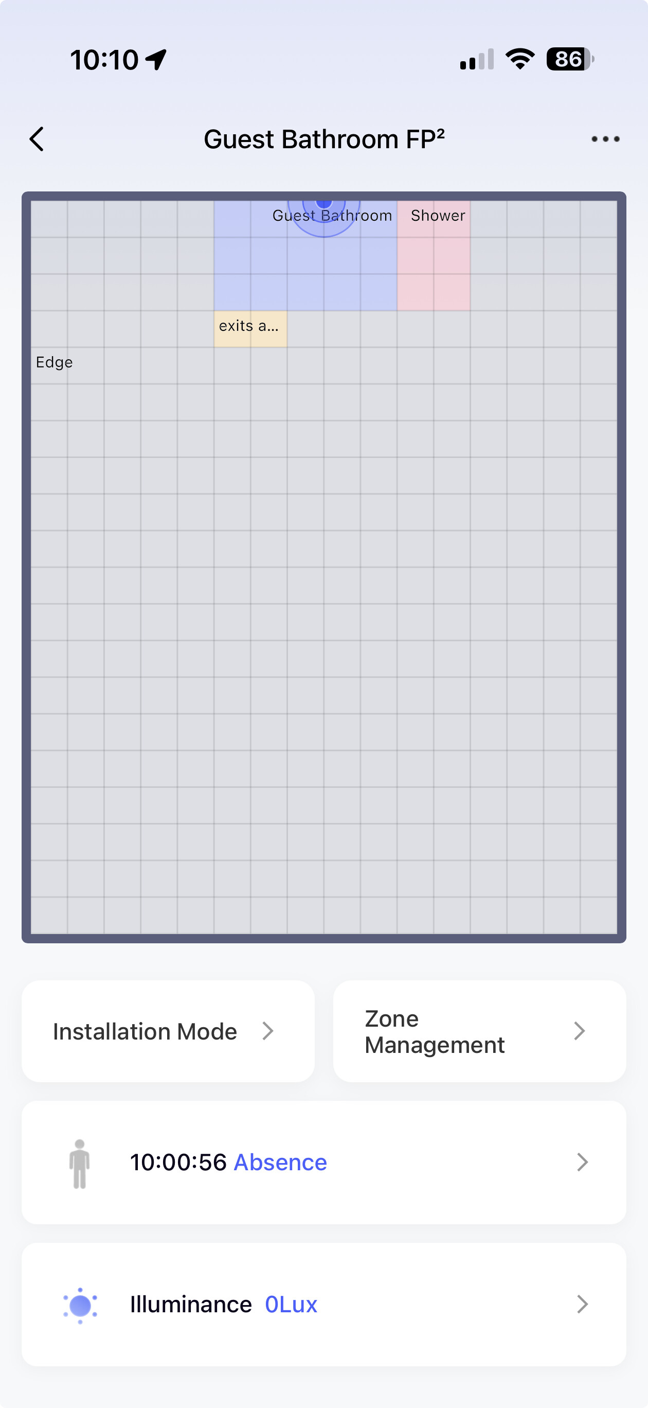

FP2 Detects Shower Occupied
Trigger:
  • Zone Shower became occupied
Flow:
  • Shower light to 100%
  • Does NOT turn off main lights → correct
Result:
Shower light behaves independently and correctly.
:four:
FP2 Detects Shower Free
Trigger:
  • Zone Shower became free
Flow:
  • Turn shower light off
  • Only turn off ALL lights if:
    • Shower occupied = no
    • AND door closed
    • AND timer hit zero
Result:
Shower leaves no chance of turning everything off prematurely.
:five:
Leaving the Bathroom
When:
  • Door closes AND FP2 sees no one AND shower is NOT occupied
Flow:
  • Dim to 20%
  • Start 20s timer
:six:
Timer Reaches Zero → All Off
Only happens when:
  • Timer hits 0
Result:
The lights never turn off during a shower — correct.
:seven:
Late Night Mode Handling
Your time triggers:
  • Time = 00:00 → set Late Night Mode = yes
  • Sunrise → set Late Night Mode = no
This is fully correct and clean.
Late Night Mode results in:
Scenario Behavior
Entry dim to 20%
Occupied 30% instead of 100%
Exit Immediate OFF (instead of dim to 20% + timer)

Great automations. I’ve used the motion P2 in several bathrooms but shower curtains prevent from detecting motion inside the shower. I’ve gotten around it with using humidity sensors to detect the shower in use, but using an FP2 with zones is a great idea.

How many presence sensors do you have? Just one in the bathroom and you have created zones? I like what you’ve done!
I agree. Love these.
Yea, I have a glass shower. Before I used a temp & humidity sensor to turn on the light or stop it from turning off.
