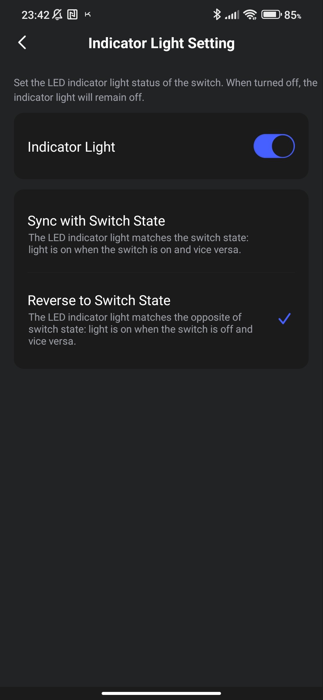

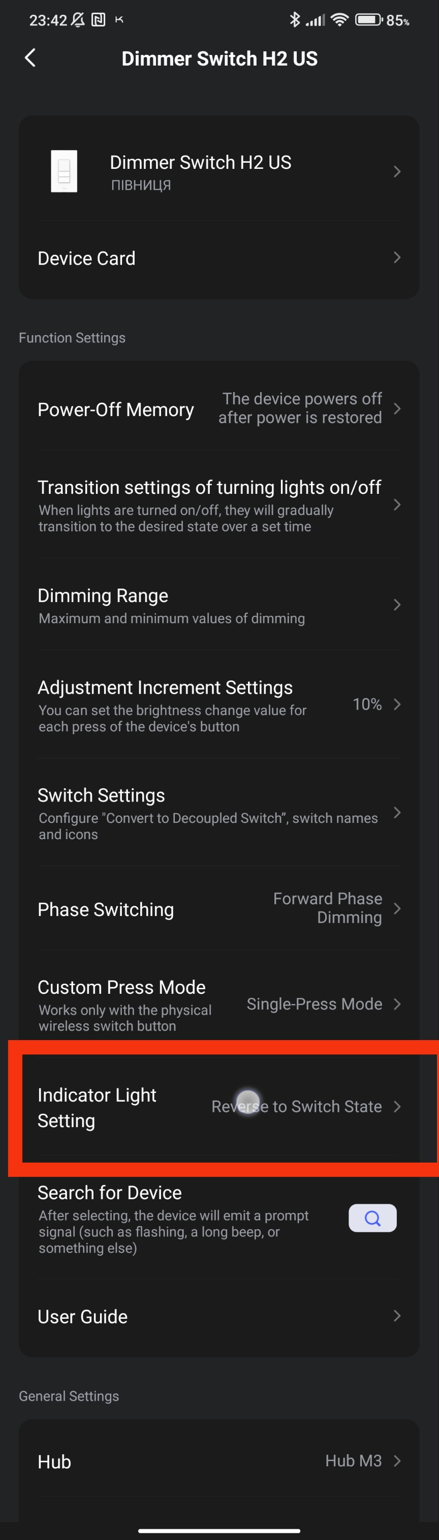

Hello, it’s here.

I have an H2 US dimmer, I think the menus are partly similar in this setup. Zigbee mode.
The EU version has this comparison of Thread and Zigbee modes, I believe the US version has similar features. The light setting is exclusive to Zigbee

I checked the menus and the zigbee menu has more options.
