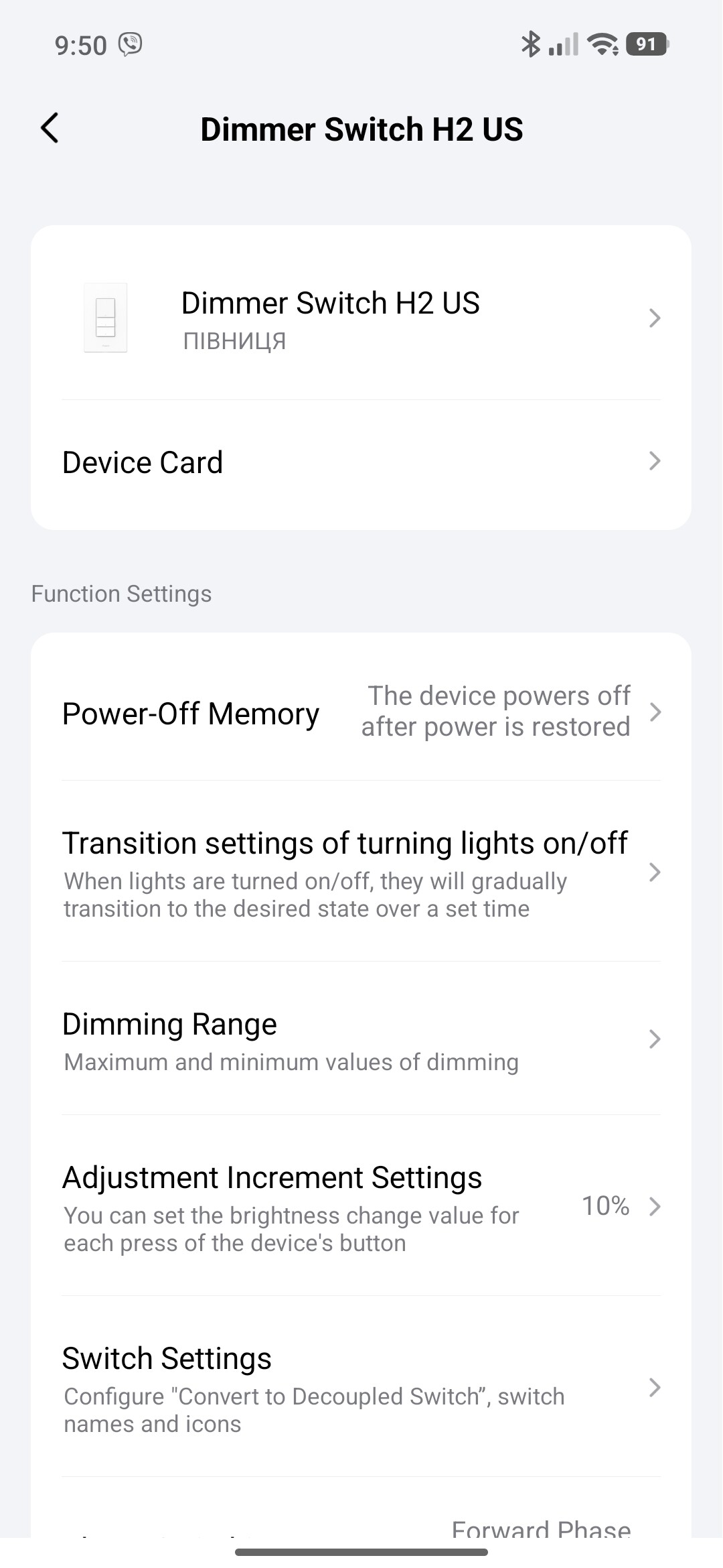

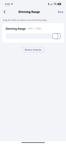

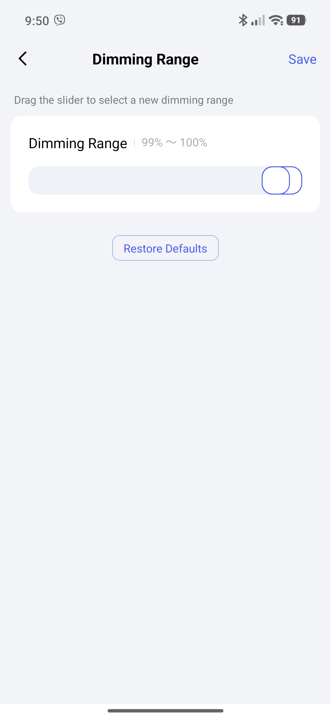

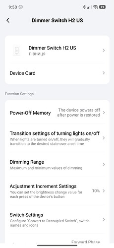

Hello, welcome to the forum. Here are the settings that limit the dimming range.

This screen is in the Aqara app, Zigbee mode.
